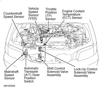

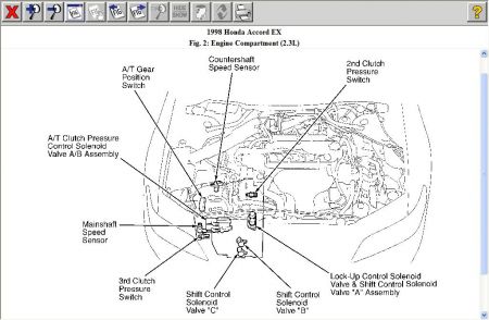

Car transmission does not make it move strongly very poor pulling when on D scanner give p1753 code there to many solenoids in confused which one I have to replace I already change the ecm. Pl.I need your help
+2
Tuesday, June 15th, 2021 AT 10:11 AM (Merged)
KHLOW2008
  • 41,814 POSTS
Hi mianakram,
P1753 = Lock-up solenoid.
However this solenoid should not interfere with the shifting process. Only the lock up would not engage.
https://www.2carpros.com/forum/automotive_pictures/192750_EngComp98Accord_1.jpg

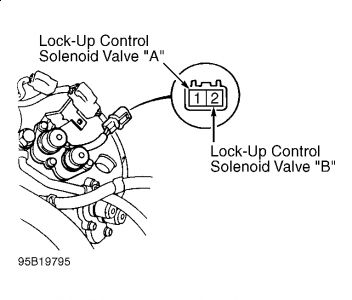

I have searched the web and found many different directions to go on this code (P1753), however none of them seem to agree on what the problem is or even could be. Can someone please give me a direction to go and the first 3 to 4 step to take to track down this problem?
DOCFIXIT
  • 18,828 POSTS
Hi
see diagram
https://www.2carpros.com/forum/automotive_pictures/198357_Grafic_3_71.jpg
https://www.2carpros.com/forum/automotive_pictures/198357_Graphic_241.jpg
Locate lock-up solenoids code is for A with ohm meter check from Terminal 1 to body ground 12-24 ohms. Next take jumper wire from batt pos. touch to term. 1 does it click. failure of either test replace solenoid.
