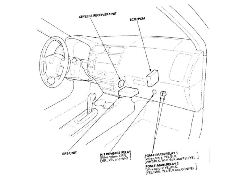

Good evening.
Under the passenger side of the dash. Picture attached. Check out the diagrams (Below). Please let us know if you need anything else to get the problem fixed.
