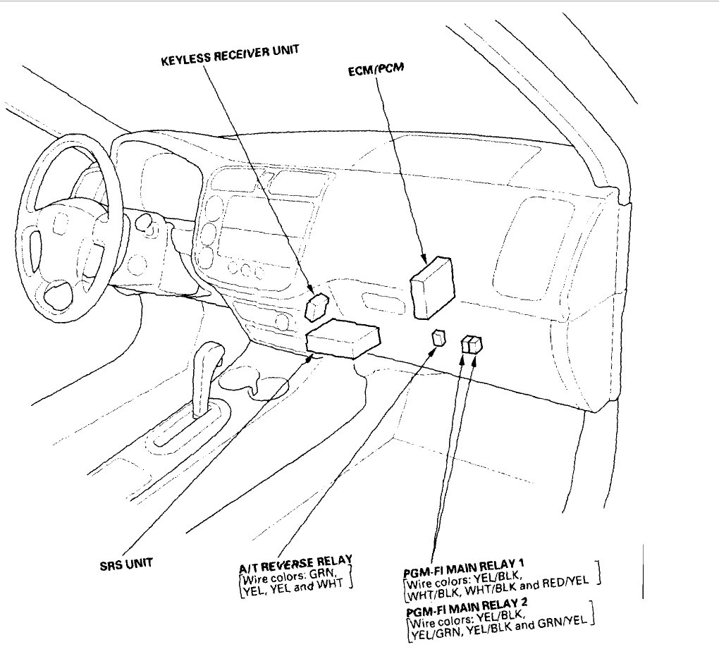

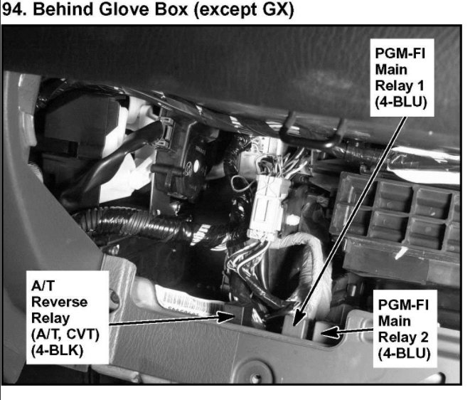

Thank you for responding about where the main relay is located in my 2002 Honda Civic Lx. Do these two relays have computer boards where in I can pop the casing and check the solder joints or am I way off base?
Oct 5, 2010 at 11:27 AM
KHLOW2008
  • 41,812 POSTS
What is the problem you are encountering? The relays are normal relays with no electronic circuit boards and if bad, they would have to be replaced. Here is a guide to help you test the relay https://www.2carpros.com/articles/how-to-check-an-electrical-relay-and-wiring-control-circuit Next to PGM-FI relay 1 is # 2, located behind glove box.
https://images.2carpros.com/forum/automotive_pictures/192750_DashComp02CivicFig02_1.jpg
https://images.2carpros.com/forum/automotive_pictures/192750_PGMFIRelay02CivicFig95_1.jpg
Larger images below!

there are 2 main relays, both are behind the glove compartment box.
