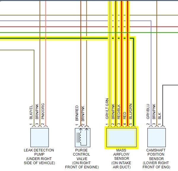

Looking for electrical drawing or pin out MAF to ECU so I can test continuity before stripping section of wiring loom.
Thanks
Friday, January 17th, 2020 AT 2:24 AM
14 Replies

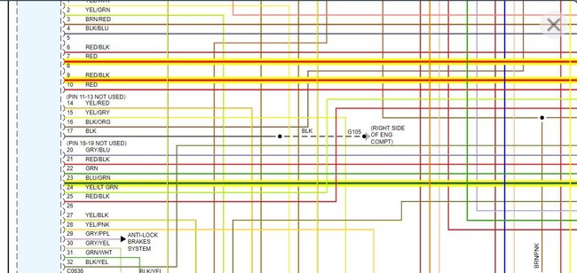

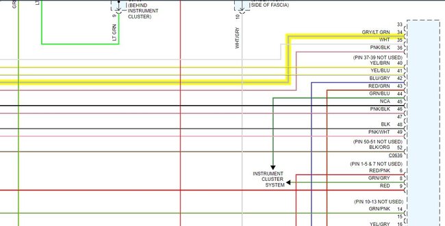

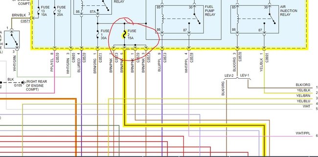

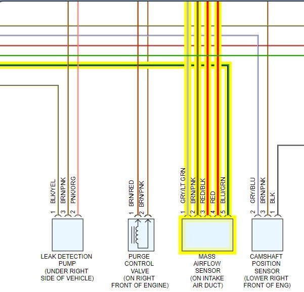

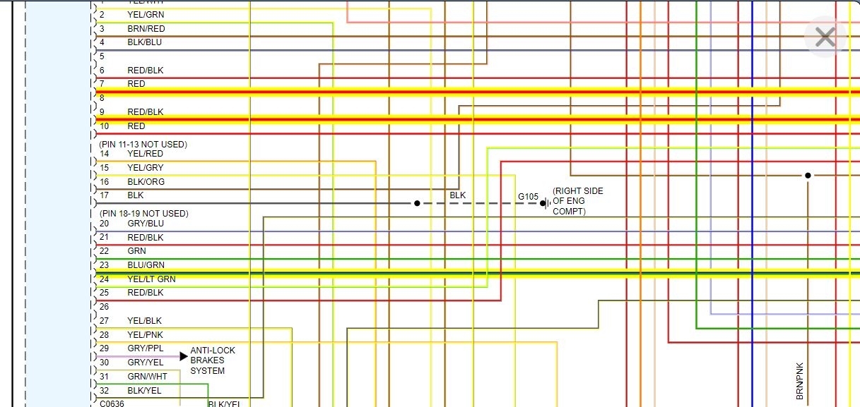

Good morning,
The brown/pink wire is the one that supplies 12 volts to the sensor. It is controlled by a fuse. I attached the diagram for you of the wiring.
The other 4 go to the ECM for the controls.
Friday, January 17th, 2020 AT 2:41 AM
GEORGE TODD
  • 6 POSTS
So I should have continuity between fuse 2 and MAF sensor. Note MAF sensor only has 3 wires.
TIA
George
+1
Saturday, January 18th, 2020 AT 10:12 AM
Correct. The power comes from the fuse as in the diagram.

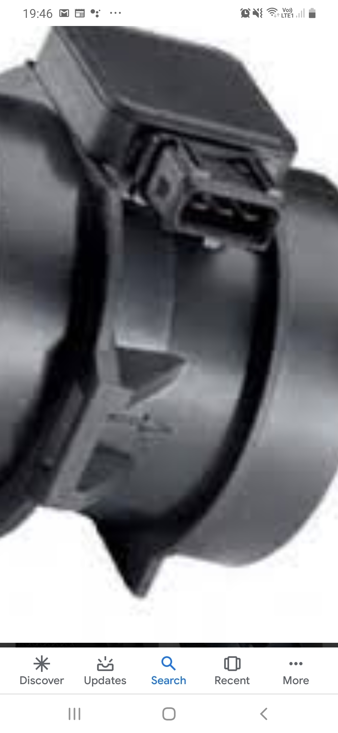

I have never seen a MAF with 3 wires? Can you double check the engine size 2.5?
Monday, January 20th, 2020 AT 10:20 AM
GEORGE TODD
  • 6 POSTS
Seems to be standard on the discovery 2.
Monday, January 20th, 2020 AT 11:47 AM
Could you please post the VIN number for me?
Monday, January 20th, 2020 AT 11:52 AM
GEORGE TODD
  • 6 POSTS
See photo.
Monday, January 20th, 2020 AT 12:21 PM
This is a turbo diesel. I will need some time to track down the information.
Monday, January 20th, 2020 AT 1:12 PM
GEORGE TODD
  • 6 POSTS
Yeh Td5.
What problems would a faulty MAF sensor give?
The understanding I have pin.
1 ground.
3 live feed.
2 signal return. (Vary between 1 and 5 volt)
Now have live feed, bur nothing on pin2 and no air flow on obd reader.
Monday, January 20th, 2020 AT 1:38 PM
Okay, there should be a 5-volt reference voltage supplied by the ECM. There will be a return or ground going back to the ECM as well. The third wire is the signal wire. That will have 5 volts as well and will vary in voltage from 0 to 5 volts depending on engine load. As you accelerate the voltage should change on the signal wire. If it does not, then you either have a bad sensor or a broken wire.
Monday, January 20th, 2020 AT 3:04 PM
