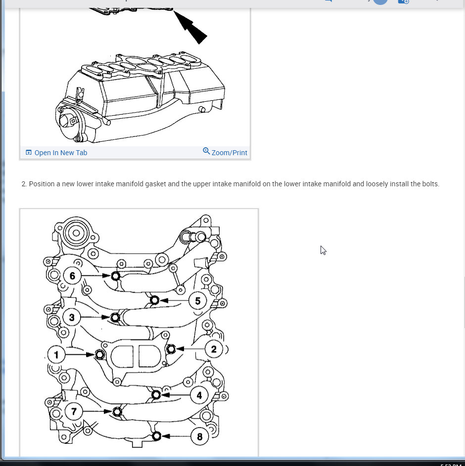

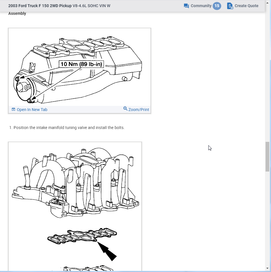

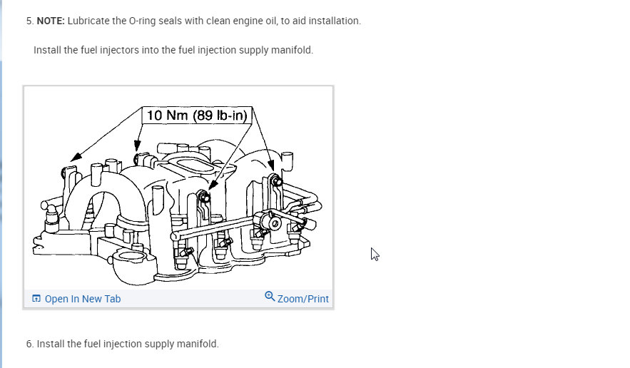

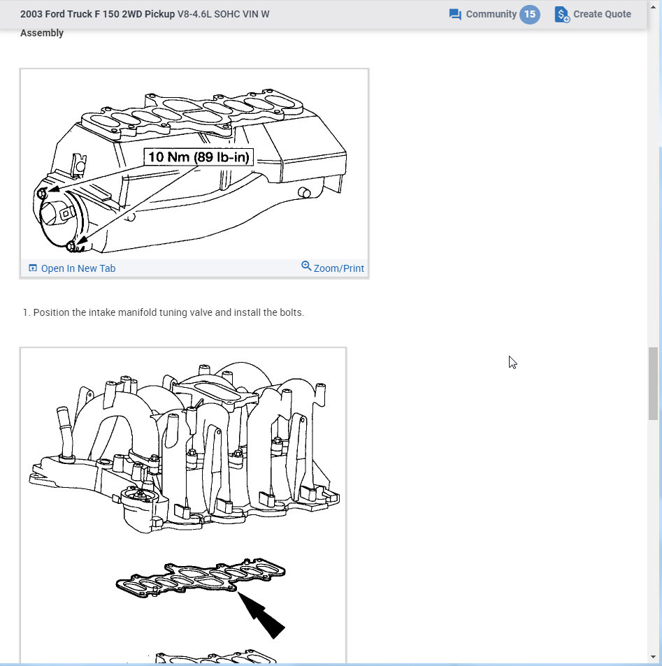

What is the torque setting to connect the lower intake manifold to the upper intake manifold?
May 8, 2020 at 7:41 AM
Here is the process for installing the manifolds with torque specs. Let us know if you need more info and we can send it over. Check out the diagrams (Below). Please let us know if you need anything else to get the problem fixed. Thanks
May 8, 2020 at 7:53 AM

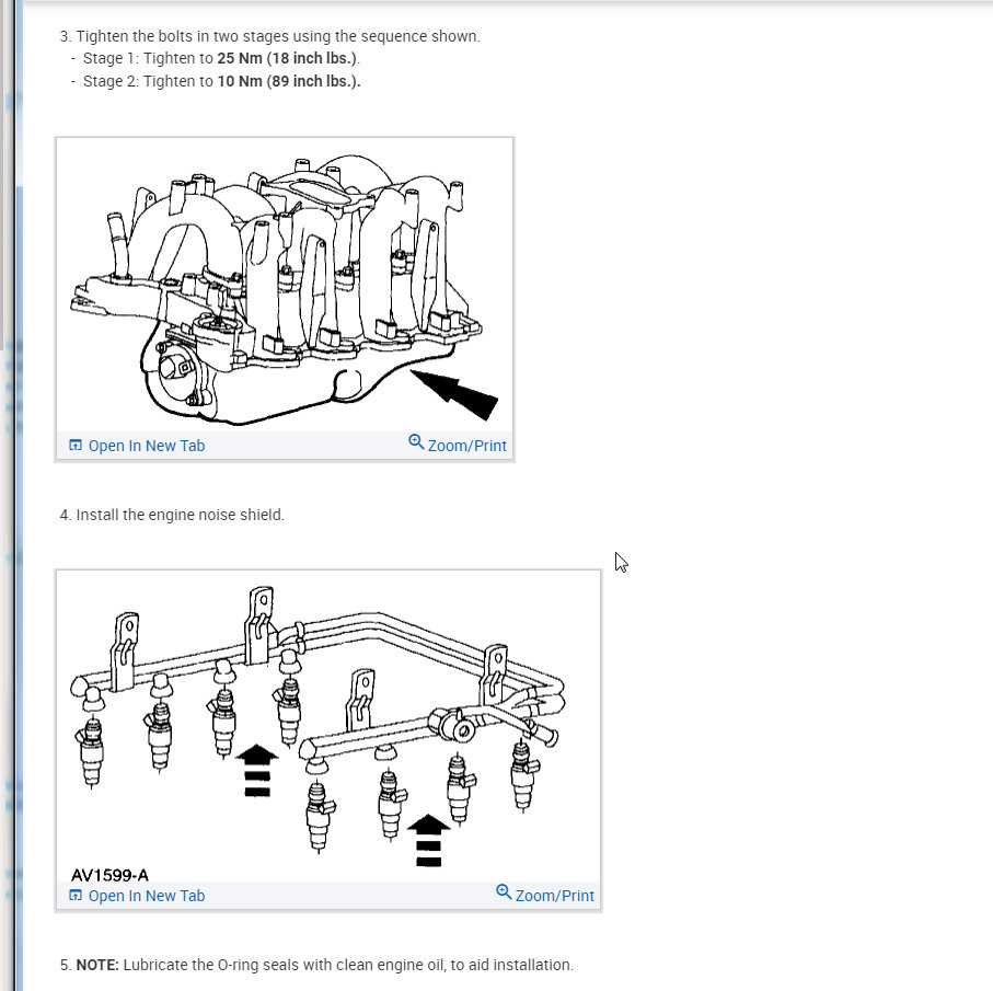

This is the upper to lower sequence and torque spec.
Stage 1: Tighten to 2 Nm (18 inch lbs.) .
Stage 2: Tighten to 25 Nm (18 ft. lbs.) .
Dec 9, 2020 at 5:58 AM (Merged)

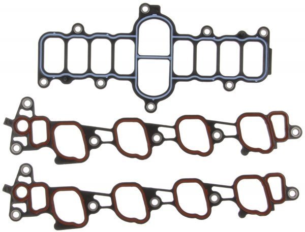

KJS671
My manifold looks like this one but doesn’t fit my 4.6 . My engine block has 12 bolt holes.The same gasket can be used on either side of engine by flipping gasket from back to front.
STEVE W.
  • 15,352 POSTS
Your gaskets should look like these. If so the above is the correct pattern according to Ford. If you have an extra bolt it also gets torqued to the same spec.

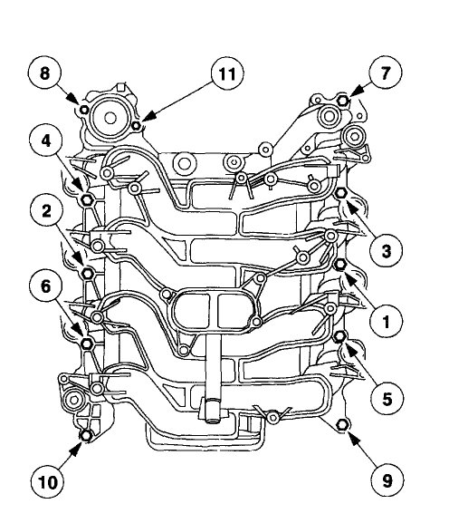

Engine Mechanical problem
1997 Ford F150 V8 Four Wheel Drive Automatic

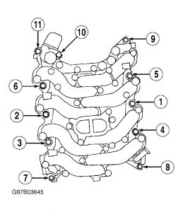

can you tell me what the torque specs are for the intake manifold for 97 ford 4.6l triton?
DAVE H
  • 13,384 POSTS
Intake Manifold Bolt Ft.Lbs 15-22 Nm.(20-30) Tighten bolts in sequence. See Fig. 2 .
https://images.2carpros.com/forum/automotive_pictures/266999_intak_1.jpg
DANIEL470
  • 14 POSTS
perfect, thank you
