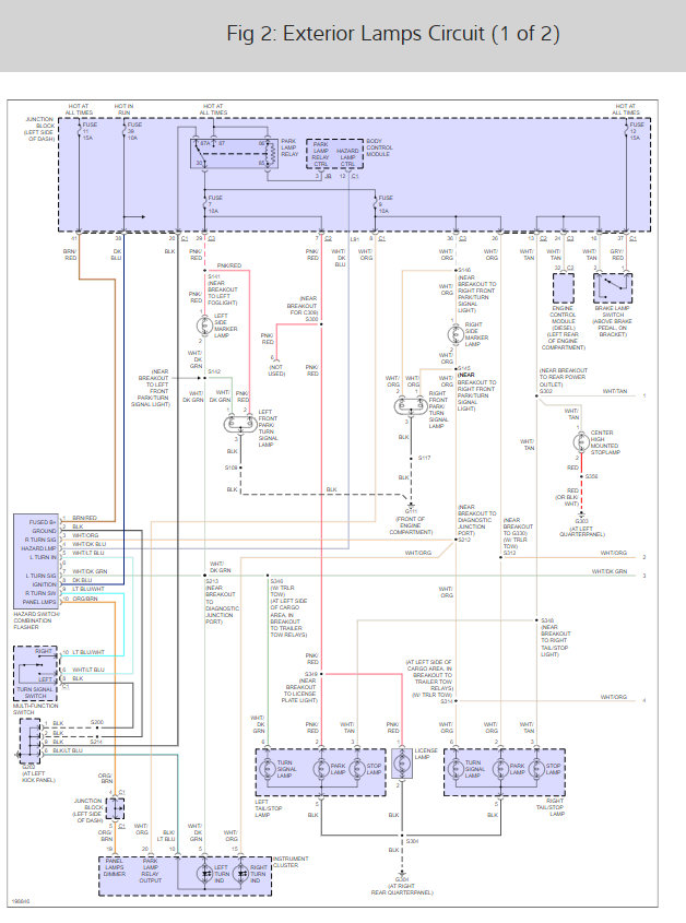

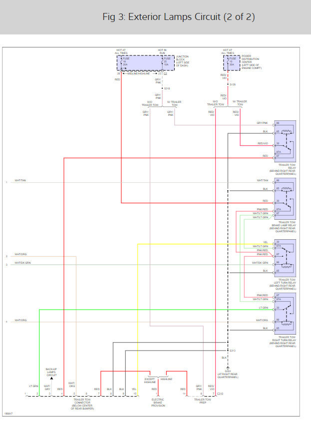

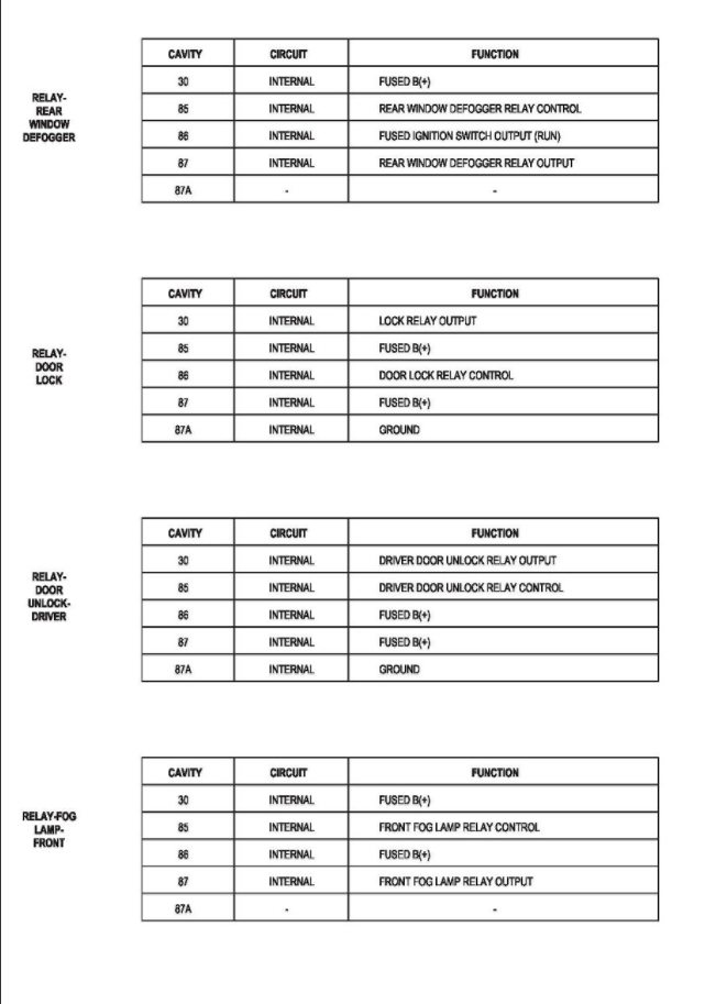

When headlights are on tail lights are on but brightness does no increase when brakes are hit. when head lights are off the lower brake lights do not come on at all just the upper brake light when you press on the brake.
Apr 8, 2018 at 1:04 PM
  • 54,503 POSTS

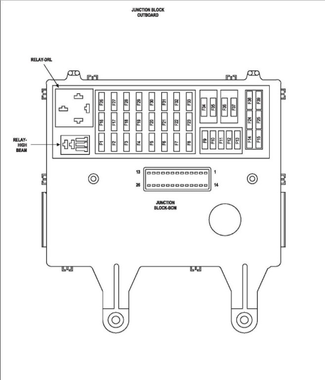

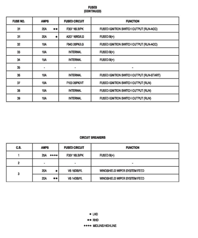

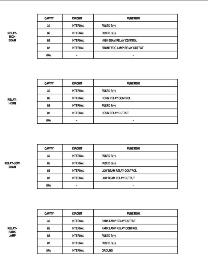

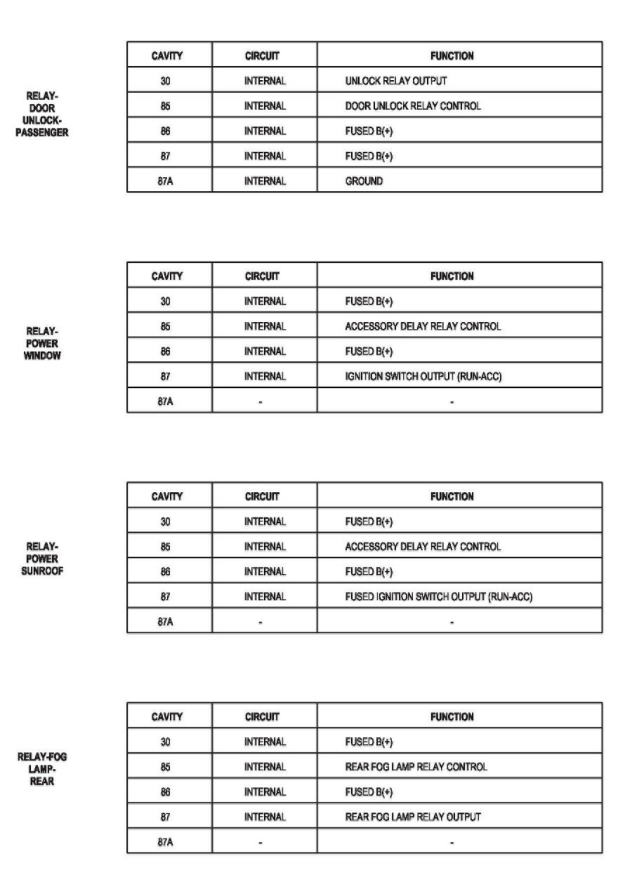

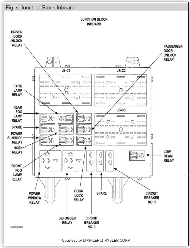

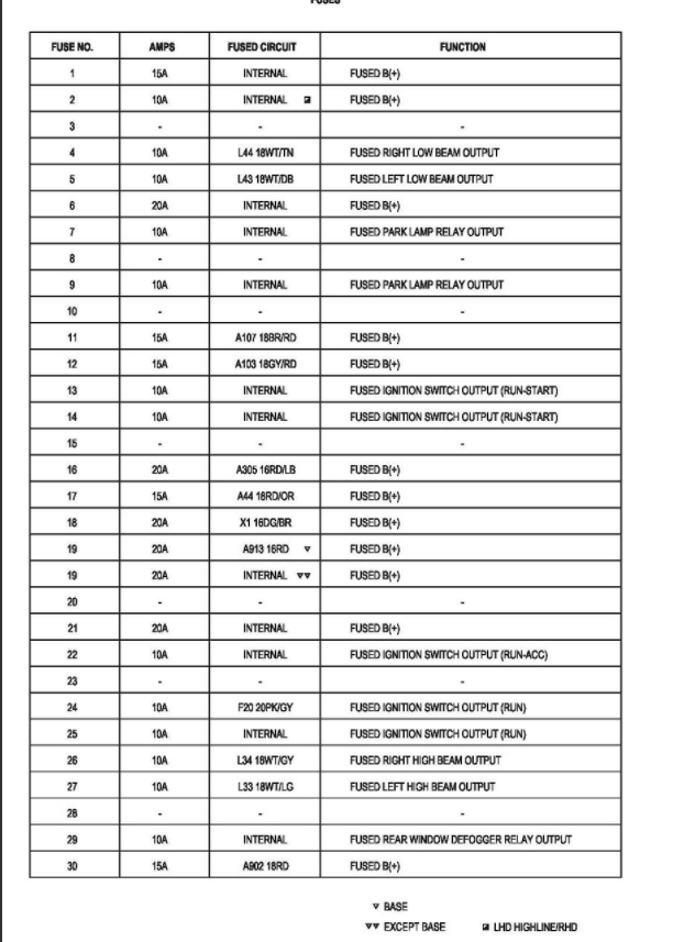

There are eight fuses that run the system that need to be checked before we move on. Here is a guide on how to check the fuses:

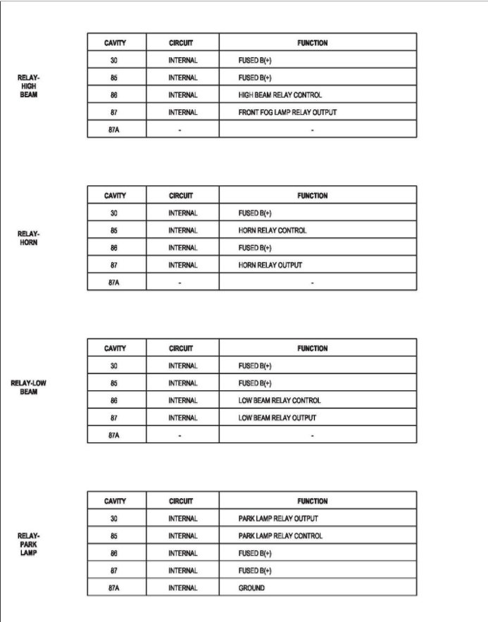

Below are the brake light wiring diagrams that show the fuses that need to be checked and also the fuse panel location and identification.
