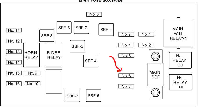

Low beam headlights went out within 3 days of each other. I have replaced bulbs and fuses, and they still do not work. All other exterior lights work still including high beams.
Feb 25, 2026 at 8:09 AM
  • 54,494 POSTS
Hello, I will help you fix this problem. So with the headlights on please check for power at the #6 fuse in the fuse panel under the hood. This will tell us if the relay and switch are working. This guide will help.
Here is the fuse location as well. Let me know what you find so we can continue. Check out the images (below). Ken
