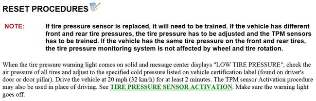

Tire pressure light will not go out. All sensors have tested good. Please assist. Thanks, Bob

It probably needs to go through reset procedure. See pic. If this doesn't work then it has to be retrained by machine.
Image (Click to make bigger)

I've had the garage man place his tester on each senor and they read operating properly. Any other suggestions? Thanks, Bob

You may have to go to a dealer to retrain them then like I said in first reply
