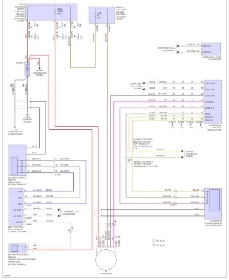

Alternator out put is 12.5. BENCH TEST alternator and it is functioning properly. Is there a repair I can perform with out taking the car to a dealer?Note, I've installed a different alternator with no improvement.

Thanks for your interest. When the dash light first came on I used a volt battery tester on the battery. I load tested the battery. The battery tested good. With the same tester on the battery I checked voltage output and the voltage was about 12.5 volts. With very little change with RPM increase. I immediately replaced the alternator with no improvement. Keep in mind this car has only 15000 miles. I take the alternator apart bench tested everything. All tested good. I spoke to the Ford dealer. They said, for a $100. Dollars they would program the alternator to the car. That does not explain what happened. Presently I've taken the original alternator to a well known electrical repair shop (specializing in alternator overhauls ) he tested all part( I brought it to him disassembled) and all tested good. He reassembled and bench tested it, All was good. Hope you have an answer, Thanks, Bob

TEST THE BATTERY VOLTAGE W/ CAR OFF AT THE BATTERY TERMINALS
THEN DO THE EXACT SAME TEST/ THIS TIME WITH THE VEHICLE RUNNING
IF THERE IS NO IMPROVEMENT TO THE VOLTAGE ON THE VOLTMETER
THIS MIGHT BE SOME POSSIBILITIES
THE ALTERNATOR MAY BE BAD!
OR IT COULD BE GOOD! EXCEPT THE FOLLOWING COULD BE HAPPENING PREVENTING THE ALTERNATOR FROM REACHING THE BATTERY
CONNECTIONS AT THE BATTERY OR ALTERNATOR MAY BE SUFFERING TO INCLUDE POSSIBLE BROKEN WIRES
BLOWN FUSES IN THE CAR
FRIED FUSIBLE LINKS (MANY TIMES CAUSED FROM CROSSING UP THE JUMPER CABLES WHILE ATTEMPTING A JUMP START)
LET'S GET MR. ALTERNATOR REASSEMBLED AND EITHER TAKE IT TO AN AUTO PARTS STORE FOR A REAL "SPIN UP TEST". IF IT PASSES, BACK ON THE CAR. IF YOU NEED DIAGRAMS OR MORE ASSISTANCE, RETURN TO US WE'LL HELP YOU FIND SOME OF THE STUFF I MENTIONED.

JUST LOOKED FOR CHARGING SYSTEM DIAGRAM IN "PRODEMAND"
SEEMS THEY WANNA KNOW A BUNCH OF INFO TO STEER ME TO THE RIGHT DIAGRAM
LET'S START WITH ENGINE SIZE/ SUB-MODEL/ MANUAL OR AUTOMATIC/ ANY OTHER DESIGNATION YOUR VEHICLE MAY HAVE. SOMETIMES THE VIN WILL CUT THRU ALL OF THE RED TAPE.
THEIR DIAGRAMS ARE REALLY GOOD, THEY SHOW WIRE COLORS, LOCATIONS OF THE COMPONENTS, ETC.
WAITING ON YOUR RESPONSE!

The VIN is3fa6pok95dr181643, this a 2013 ford fusion titanium front wheel drive. 2.0 engine turbocharged. Auto trans. With 15000 miles. Voltmeter reads 12.5 at battery with engine off. 13.5 voltage with engine running.I appreciate your help.

"PRODEMAND" SAYS YOUR VIN AIN'T RIGHT (DON'T MATTER) I USED YOUR OTHER INFO TO LOCATE THE CORRECT DIAGRAM
THANKS, ALL OF THAT INFO WAS VERY HELPFUL!
OK

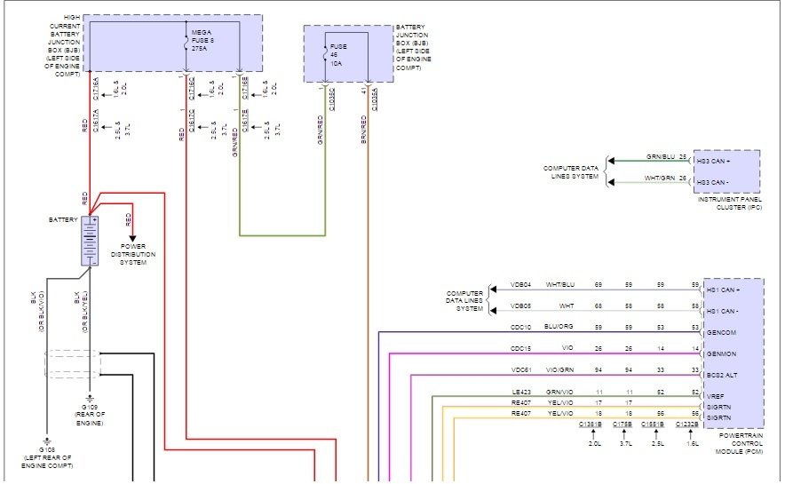

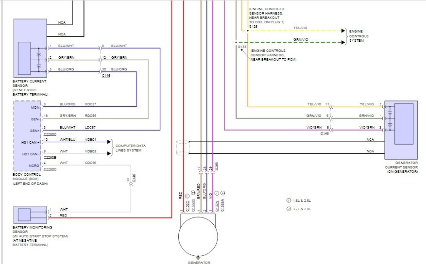

3 DIAGRAMS
1) FULL CHARGING DIAGRAM, PROBABLY TO SMALL TO READ WHEN I POST IT
2) TOP HALF OF THE SAME DIAGRAM
3) BOTTOM HALF OF THE SAME DIAGRAM
MAYBE IT WILL BE BIG ENOUGH TO READ
LEMME KNOW IF THIS HELPS

Thanks for the diagrams. I have not been able to read them. Please help. Thanks, Bob

YOU CANNOT SEE THE 2nd AND 3rd DIAGRAMS (WHICH IS THE 1st DIAGRAM CUT IN HALF)?
YOU ARE CLICKING ON THEM TO ENLARGE THEM?
IF YOU ARE ON A COMPUTER, THEY SHOULD SHOW UP PRETTY GOOD!
LEMME KNOW THE DEAL, I'LL SEE IF I CAN DO ANY BETTER IF NEED BE
