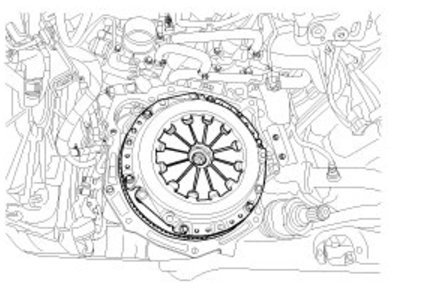

They checked tbe computer of my car and its all good. The problem thay they told me is the clutch. It is slipping.

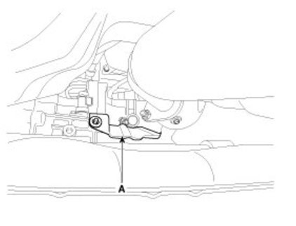

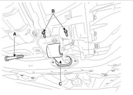

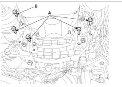

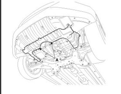

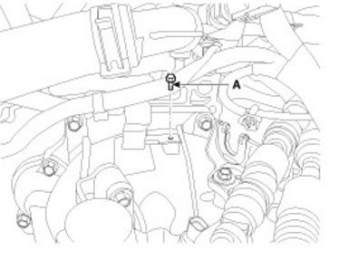

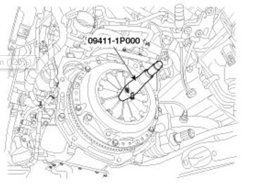

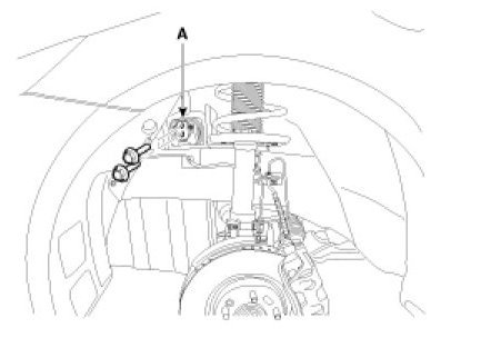

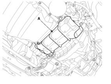

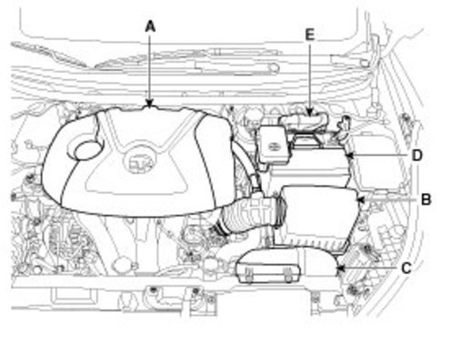

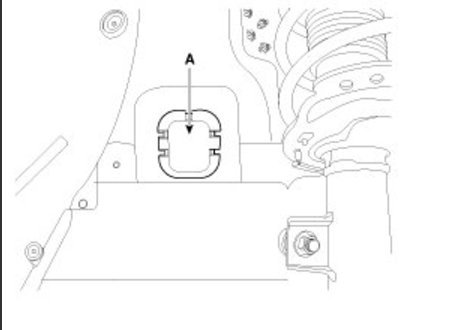

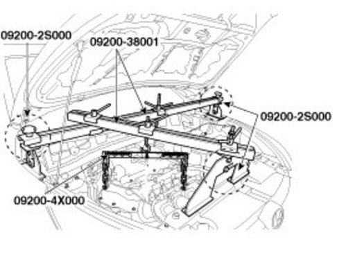

Yep that will do it.
Here is a guide that will show you what you are in for when doing the job.
https://www.2carpros.com/articles/how-to-replace-a-clutch

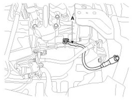

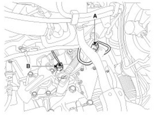

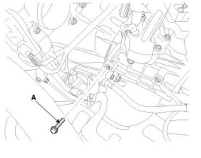

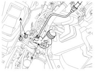

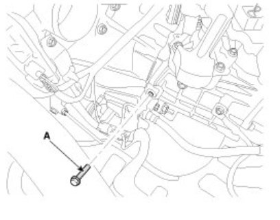

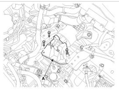

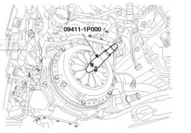

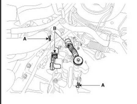

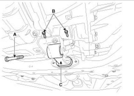

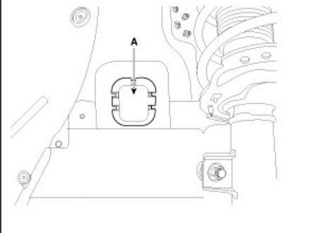

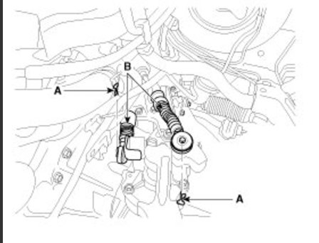

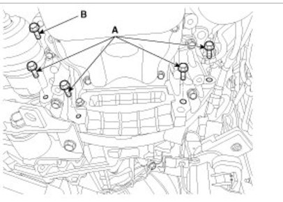

And here are some diagrams of what it will be like on your car.
Monday, July 17th, 2017 AT 9:27 AM
