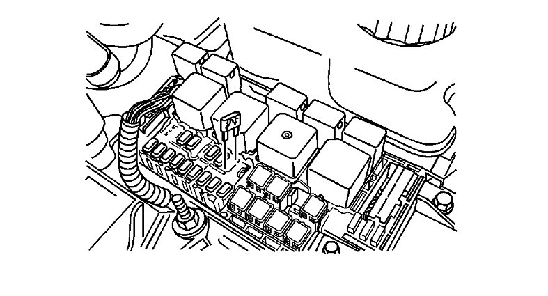

CAUTION: Refer to Battery Disconnect Caution in Service Precautions.
2. Disconnect the negative battery cable.

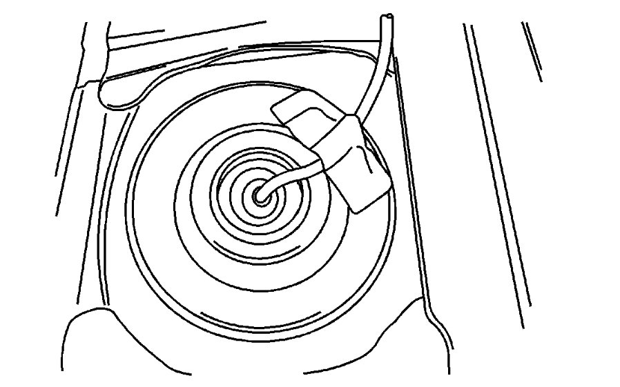

3. Remove the rear seat.
4. Remove the fuel pump access cover.

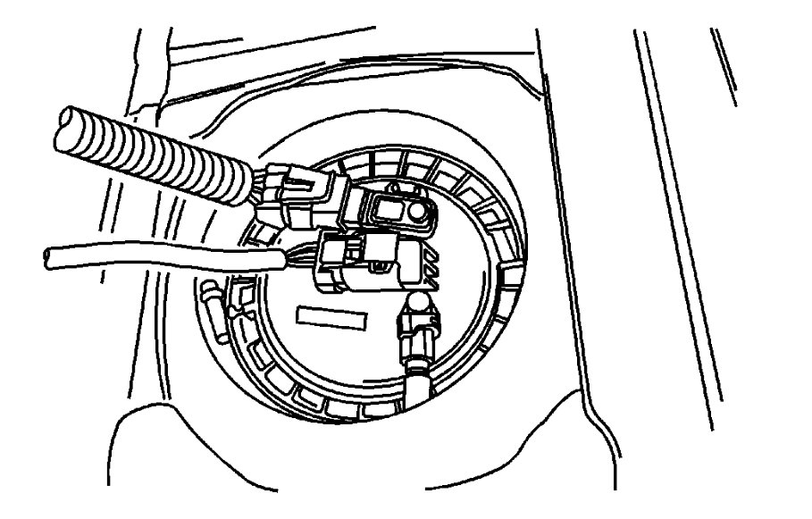

5. Disconnect the electrical connector at the fuel pump assembly.
6. Disconnect the fuel line.
7. Remove the fuel pump assembly clip.
8. Remove the fuel pump assembly from the tank.
