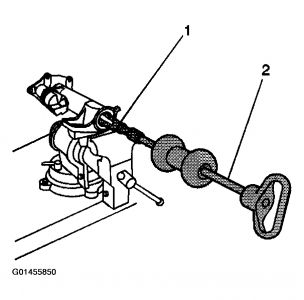

Hello, I have a 2002 Chevy Tahoe 4x4. I need to replace the front axle bearings and seals. I have 2 questions. 1. Can this be done without removing the differential housing? And 2. Are there any special tools needed for the removal or installation of these parts? Any information would be greatly appreciated. Thanks, Kevin from upstate NY.

Yes you will need slide hammer, seal installer etc.
https://www.2carpros.com/forum/automotive_pictures/108325_bearing_1.jpg
My advice is that if you want to do the repair yourself is to use car repair manual in this thread or get a Haynes manual, read procedure and see if you want to tackle it.
