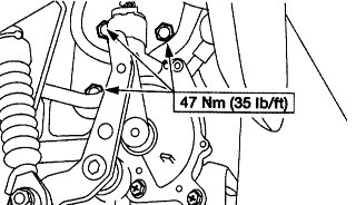

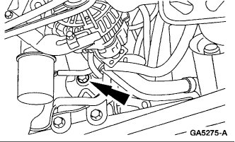

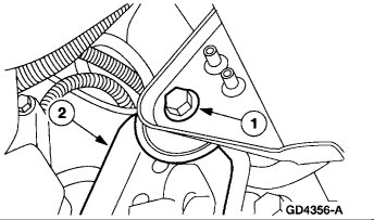

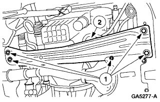

The engine mounts are both underneath the engine on the cross member. Remove the plastic shield, put a jack under the crank pulley to support the engine. Remove the bolts through the mount bolts from the engine. Unbolt and lower the cross member.
Remove and replace the mounts. Bolt the cross member back in, attach the engine. Reverse the rest.
The transmission mounts are on each side of the transmission. Same basic replacement method as the engine mounts but support the trans-axle instead of the engine.
Left two pictures, engine mounts, right two transmission mounts.
