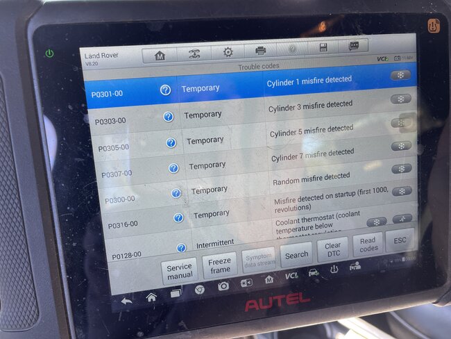

After changing the thermostat. Coolant flange, ECT sensor, and updating the coolant hoses based on TSB, bleeding, now when starting the car getting a lot of white smoke, and u0100 then misfire on all cylinders. Delete all codes come next am and start it and starts fine. Very little smoke, no misfires. U0100 is only pending. Under permanent codes I saw u0300, u0155, u0140.

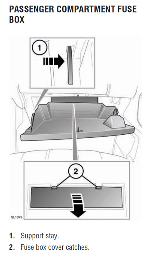

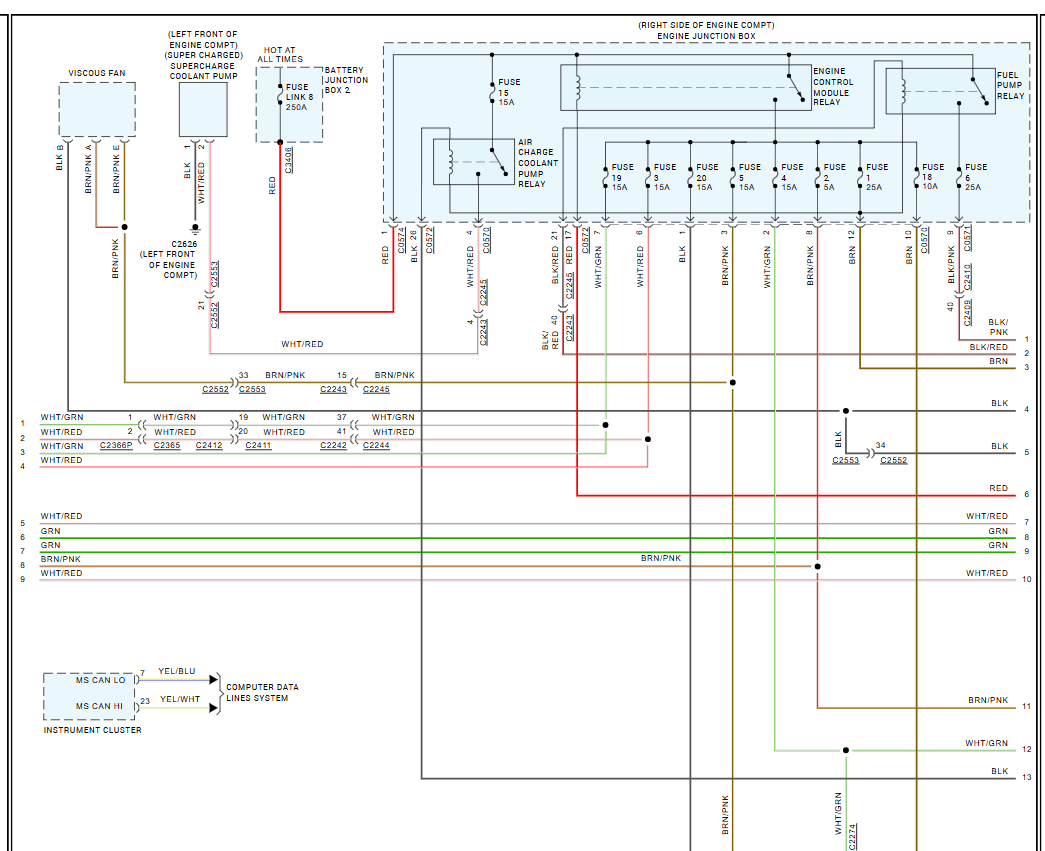

Does this car have water damage? I would try a hard system reboot to see if things change. This guide can help, but first check all fuse with the systems on, this guide can help:
U0300 - Internal Control Module Software Incompatibility
U0155 - Lost Communication with Instrument Panel Cluster (IPC) Control Module
U0140 - Lost Communication with Body Control Module (BCM)
https://www.2carpros.com/articles/step-by-step-guide-performing-a-hard-system-reboot-for-your-vehicles-electronics-systems
There are three fuse panels, one under the hood, one behind the glove box and the last one in the rear of the car. Do this first and get back to me. Check out the images (below).

I did the hard reset by touching the 2 cables together for a while It started much nicer and. Had no malfunctions, gauge temperature also went p gradually like it should without jumping to 235, which I believe was a fake glitch. I checked it with the scanner after it got to half line and it was 185. I drove it and was nice. Then parked it and id the same thing it did yesterday "restricted performance" message and misfire. And smokes some, I think the coolant is getting into the cylinders. I put in the head gasket repair but not sure if it will take a while to fix it if it does. I did that a while back but never drove it before and only started it a few times. Will see.

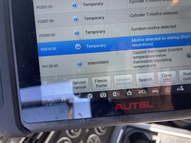

U0100 is still in permanent but not pending or current. Will check again. Am not sure whether the misfire is caused by the water getting in cylinders or just the ECM code when it pops.

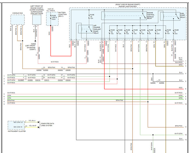

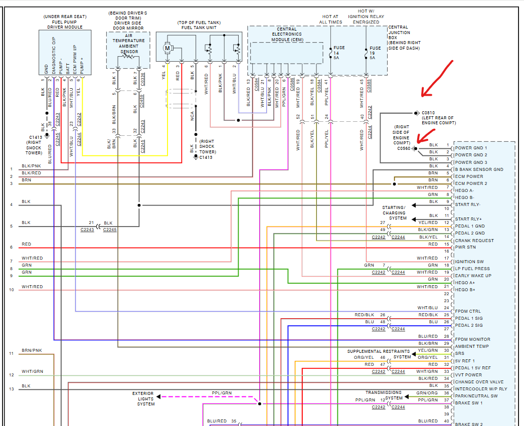

Does the security light flash when you try to crank the engine over? You might have had a voltage spike and took out the ECM. Let's check the power and grounds to see if the computer has failed. I have marked the power and grounds for you, please use a test light to test the circuits.
Tuesday, January 21st, 2025 AT 10:24 AM
BHAMDOC1
  • 193 POSTS

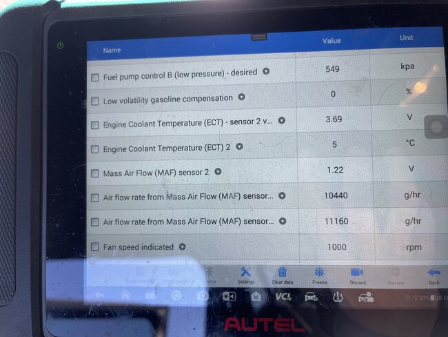

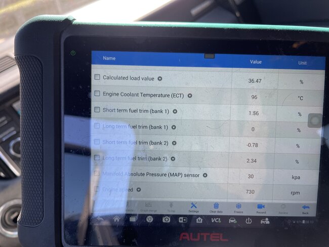

No issues with voltage and no, the light doesn't blink. Drive it today and came back then went out again and back and the temperature was still at close to super cold the all of a sudden started to climb till half. No thermostat in the car. Then drove it again and no misfires. Cane back and all of a sudden, the digital temperature needle started to go up so quickly all the way to high. Turned it off. Checked and the lower radiator hose is cold. Upper ones normal warm not hot, still strange that the lower stays cold after I removed the thermostat and flushed radiator.
Wednesday, January 22nd, 2025 AT 8:58 AM
BHAMDOC1
  • 193 POSTS
Went back shortly after and read the codes but these could be from before. Also just started it and the temperature is in the middle. I saw the engine temperature on scanner now 103c.
