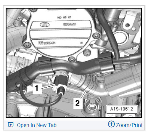

I would rerun the codes to see if any new codes come up, also I have seen engine coolant temperature sensors cause strange problems like this as well. Here is the location if you want to try and swap it out. Check out the images (below). Let us know how it goes.
Thursday, April 18th, 2024 AT 10:15 AM
BARDOCKOBAMA
  • 17 POSTS
No new codes. Afaik the coolant temperature sensor is fine. Haven't had any issues with that or any odd temperature readings.
