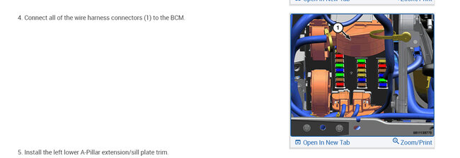

When they had the car, did they do a CAN scan?
here is more information on it:

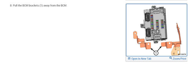

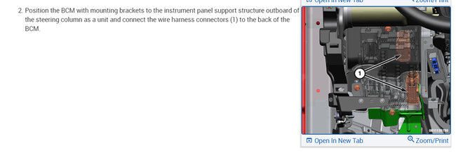

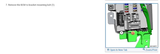

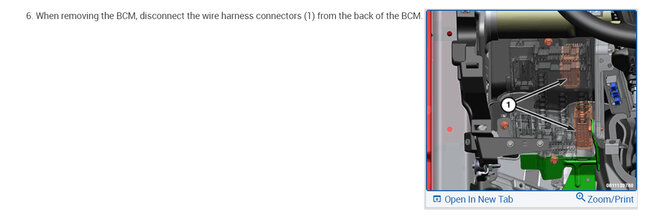

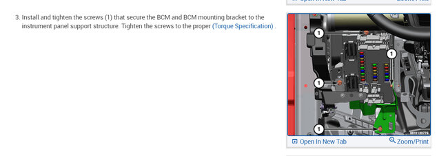

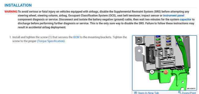

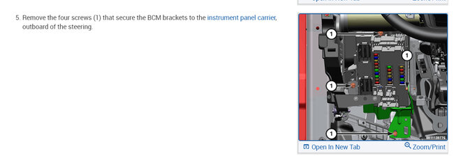

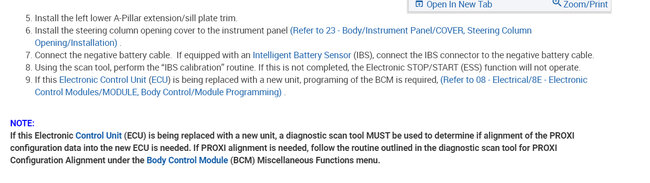

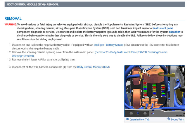

The problem will probably come back, can I ask if the car was driven in heavy rain? If so, I have seen the BCM go out due to moisture if a CAN scan comes back that the BCM has codes I would install a rebuilt unit which will come preprogrammed. Have your VIN number ready. Here is how to change the BCM out make sure you disconnect the battery first. Check out the images (below). Let us know what happens and please upload pictures or videos of the problem.

Yep, electronics do not like water, we should do a CAN scan to see what comes up. I am still leaning towards the BCM. It could be a bad fuel pump as well. When you say losing power do mean the engine or the electrical system?

Okay, we need to do a CAN scan. Please follow the guides in the posts above. It sounds like the BCM is going out. When the engine is running try tapping on the BCM to see if you get a response, if so the BCM is bad.
