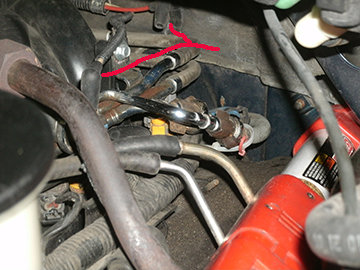

I have used a smoke machine to locate a vacuum leak and discovered a loose vacuum line. It is back by the fire wall and I can not see or feel where it plugs in. Hope you can help me before I have to start tearing everything apart.

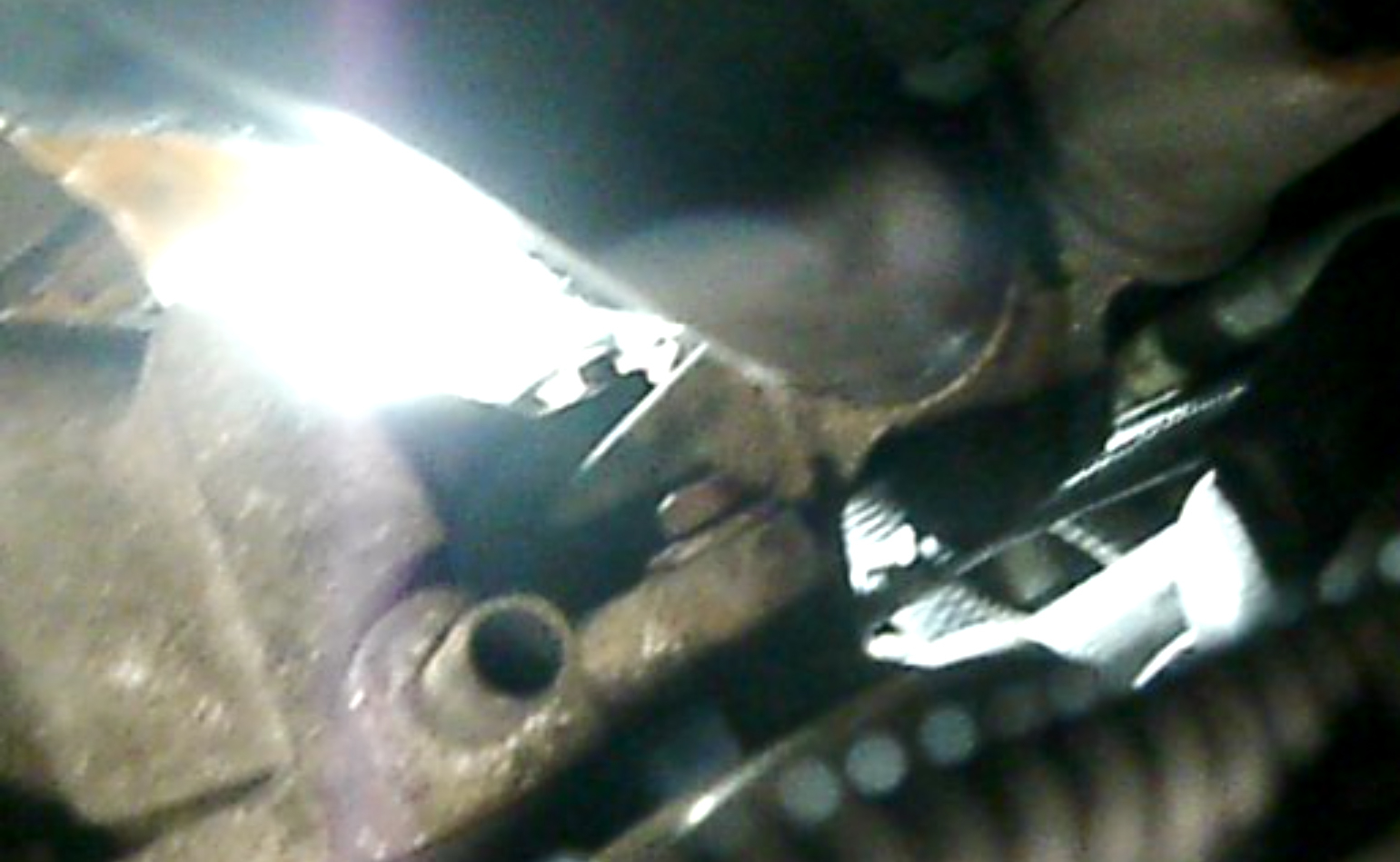

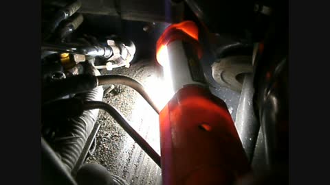

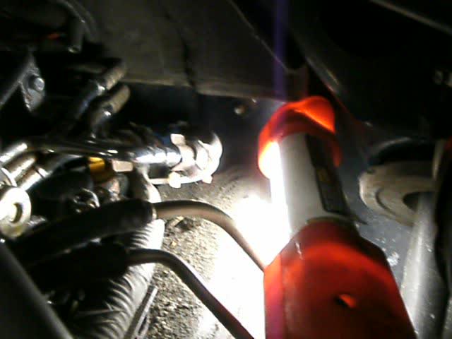

I managed to get a camera close enough to take a video that might be showing a port.
I took a desktop photo of it.
Still can not get my hands on it!

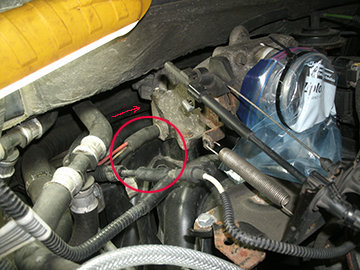

Let's try it from this point. From the original pictures I sent, with the two vacuum tubes in the harness (routing around the back of the engine) (one white and the other red) (one going to the fuel rail {maybe a regulator} ) Do you have any diagram where these two vacuum tubes are supposed to go? Something color coded? Right now the white one is connected to the fuel rail.

The red line I saw in your picture goes to the fuel pressure regulator on the fuel rail.

Thanks Dave, I already had figured out that the white line when to the EVAP and the red line went to the regulator. But thank you very much for the reply.

That was it. I had the white tube connected where the red one should have gone, and the white one went to the EVAP on the firewall. Thanks Roy and have a good night.
