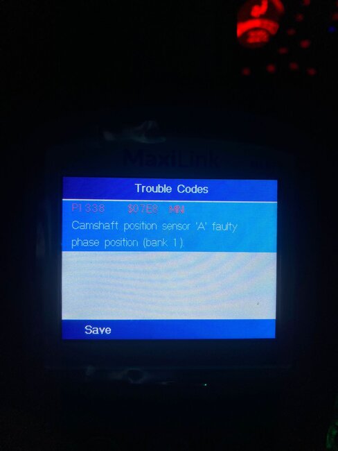

l am providing a we-transfer link as the process video is too big to attach here (this time there was only 1 code for cam shaft sensor, but sometimes the timing chain replacement codes appear)

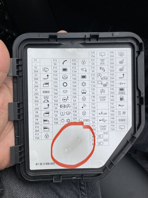

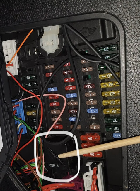

I have also found out that there is a sign of 1 relay (might be fuel pump relay) getting hot, I assume this because of the mark it left on inside of the cover, this relay's location is in inside (cabin) fuse box of mini - PHOTO 1, PHOTO 2

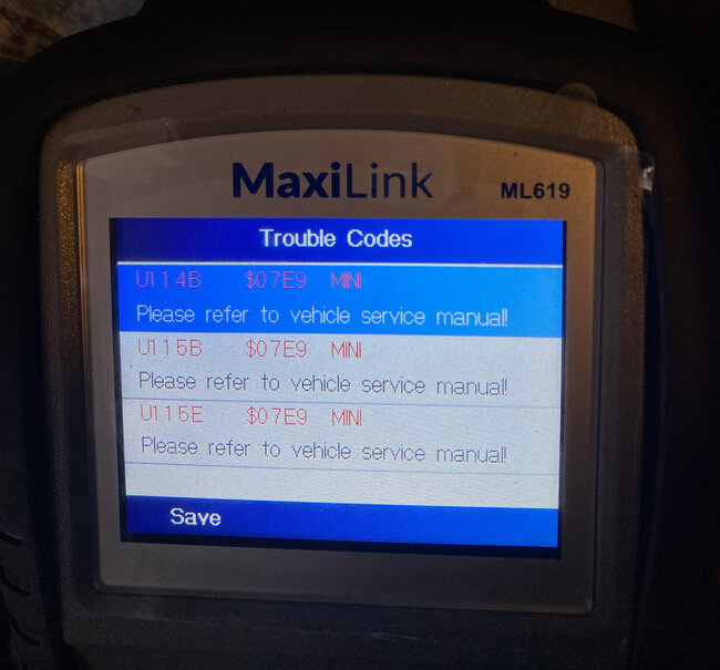

Photo 3 - Codes
Photo 4 - Codes

Let me know, and yes, there could be some form of electrical issue that is causing the new issues. I would really like to see the relay that appears overheated. That should only happen if there is too large of a draw or the relay is failing internally and creating more heat than normal.

I have questions. First, was it the intake camshaft position sensor that was replaced? The code is specific to that one and not the exhaust. Take a look at the description of the code below.
Now, I have a problem. If you look at pic 4 below, you'll notice that none of the U-codes are indicated for this year and model. I will tell you that U codes usually indicate an issue with the computer area network. In this case, I know the codes are related to the DME (digital motor electronics (also known as a powertrain control module).
The last pic below is from the controller area network schematic (CAN) This is where all the modules are tied together with a few wires. I need you to locate the DME and inspect the wiring and connector of the wires in the last pic.
Please understand this is a theory. But if we have a loss of communication with the DME, it can cause several different issues. However, since the codes aren't even listed for this vehicle (I'm not sure why), this is a guess. If the DME can't communicate, it could be causing a problem related to the cam sensor. Regardless, I would start with the cam sensor first to make sure it is seated properly, and the connectors are good. Also, make sure it was the intake sensor.
I hope this isn't too confusing. I've been trying to determine a possible cause, but the codes are throwing me off. That's what I'm indicating, it is a theory only.
