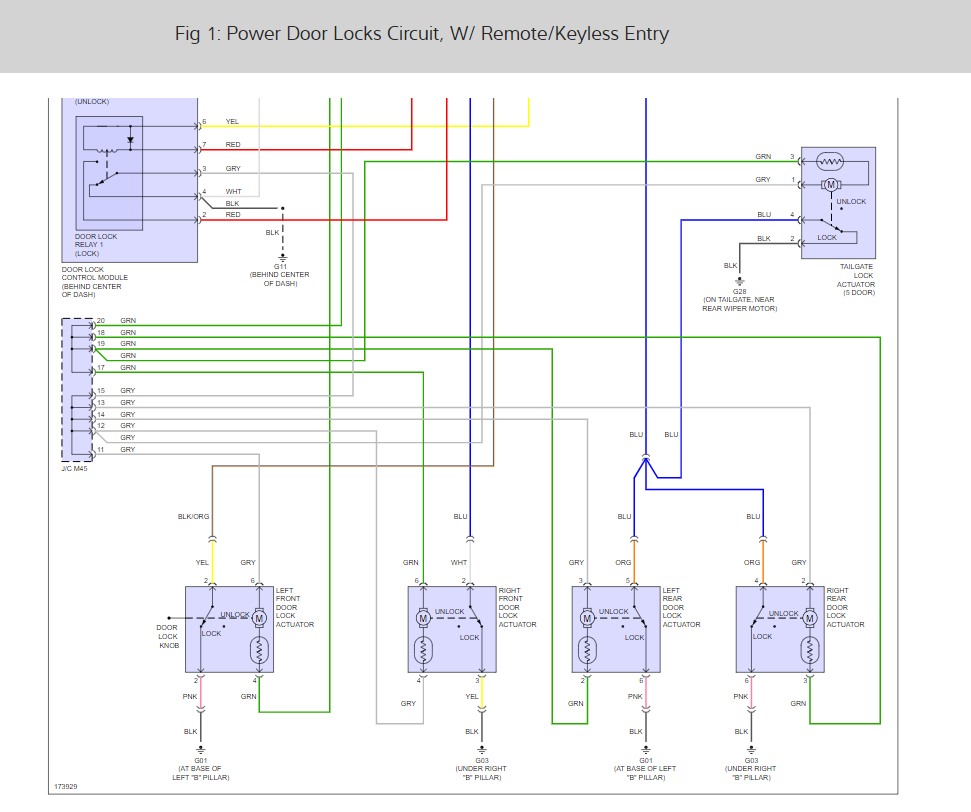

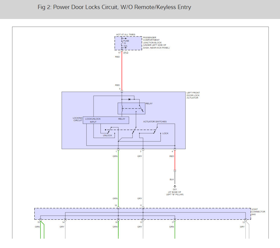

My car has automatic locks and I changed the door with one from the junkyard, but now the locks don’t lock together and the sunroof doesn’t work. what do I do?
Jun 3, 2019 at 1:18 PM
  • 54,503 POSTS

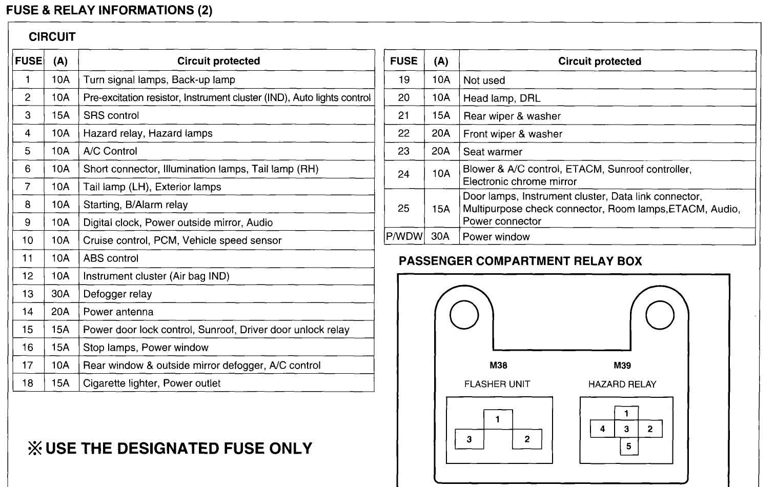

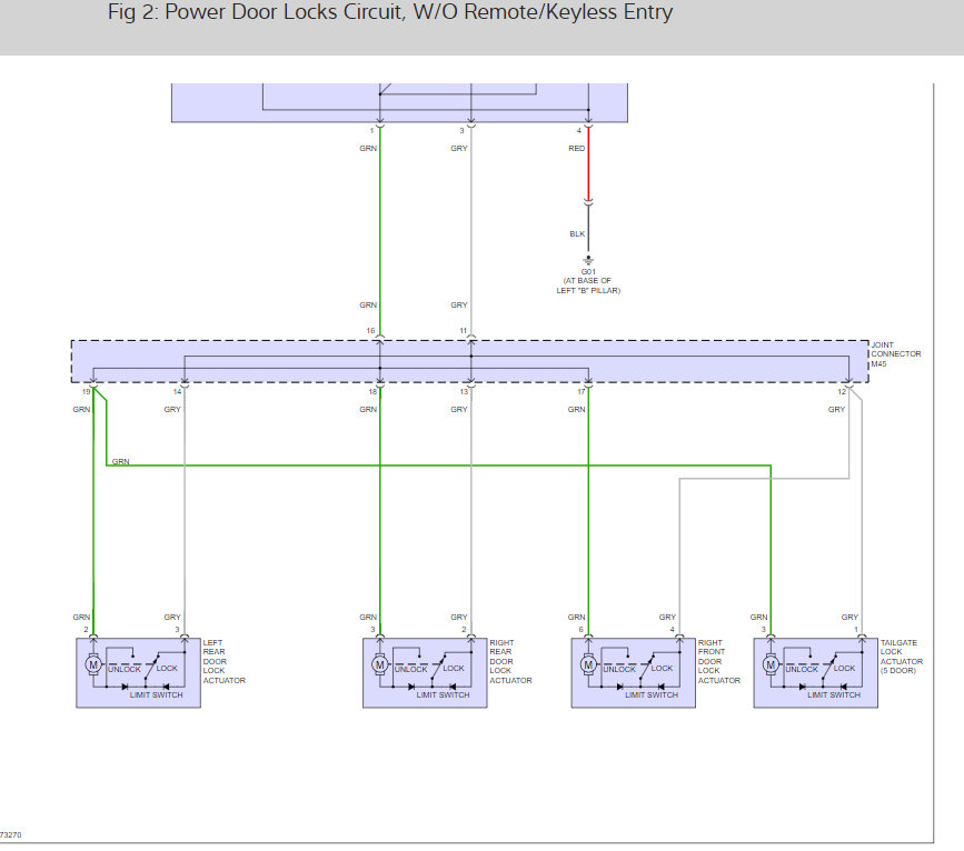

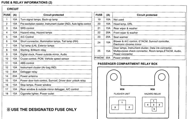

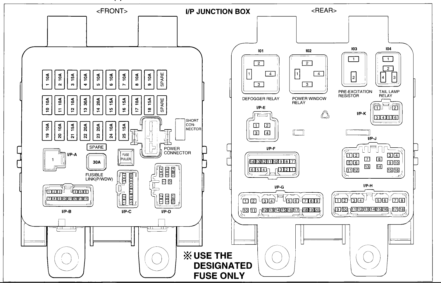

Did the electrical connectors match up? Lets test fuse # 15 lets start there and here are the door lock wiring diagrams so you can see how the system works and the fuse location:

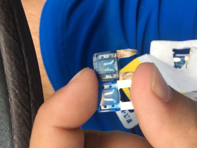

Old one looks burnt out. replacing it see if it works.
Jun 5, 2019 at 10:24 AM
CHARLESWORKMAN
  • 5 POSTS
Only sunroof works now. locks still doesn’t lock all doors.

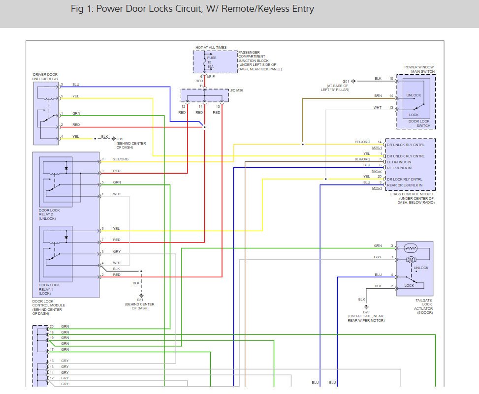

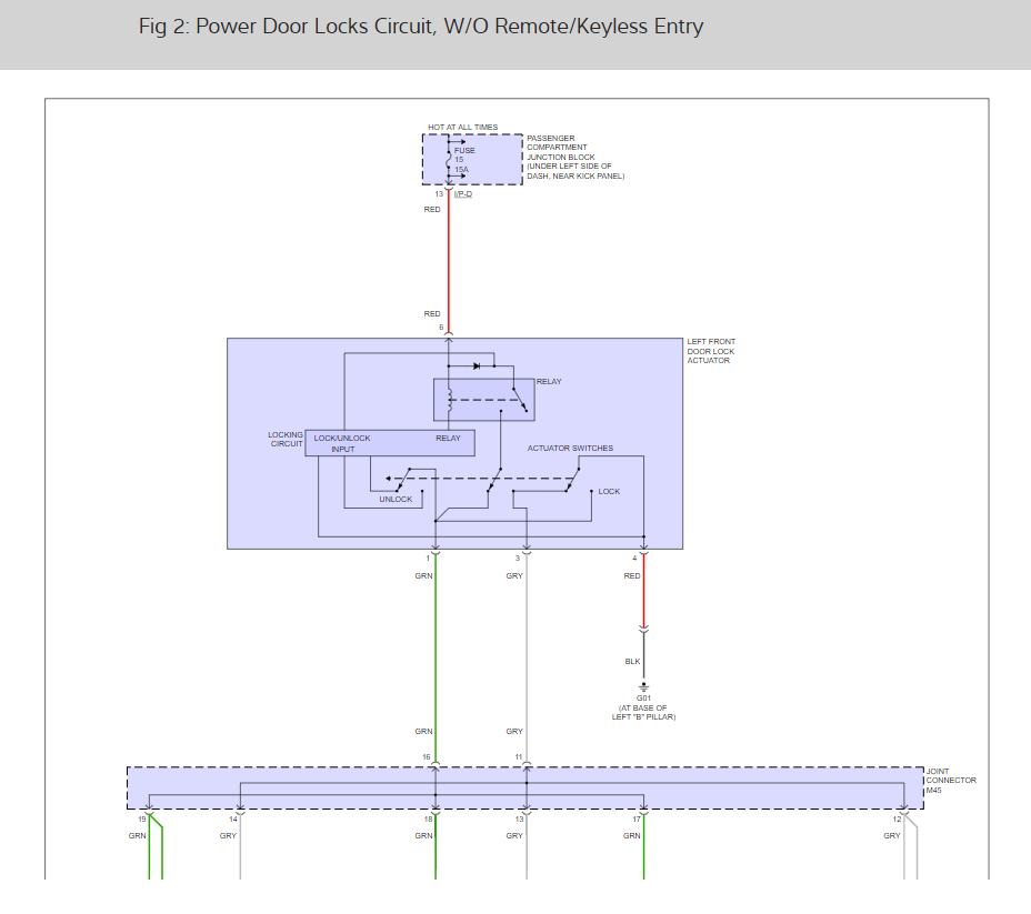

On the front drivers door lock actuator you have two red wires one should have power. can you check please?
This guide should help, let me know

We switched it with the other one that was working, but it doesn’t work.

Yes please check the red wire of power, one of the two should have power.
