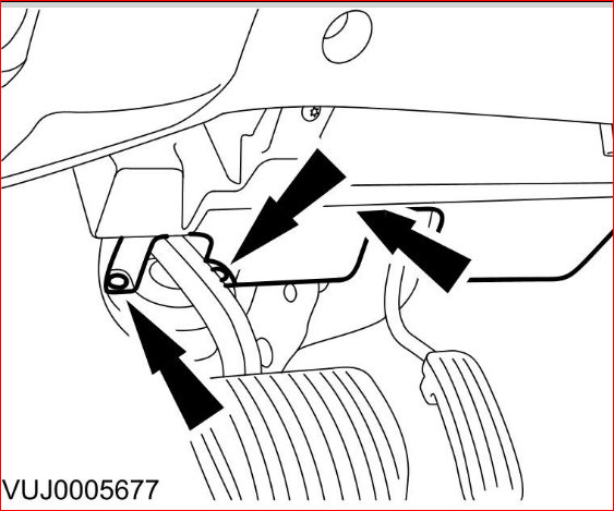

Good evening,okay thanks. Can you send the ECU sensor that allows the car to accelerate? Because the car is just throttling but it is not revving out.Thanks in advance.
Nov 29, 2018 at 4:26 PM
DANNY L
  • CAR REPAIR CONTRIBUTOR
  • 5,648 POSTS
Hello again.
It sounds like you are having a problem with the APPS (Accelerator Pedal Position Sensor).The sensor is located above the gas pedal and its function is as a Potentiometer. It is a fly-by-wire system using an electrical connection instead of a throttle cable style linkage. Hope this helps and feel free to ask questions if needed. Thanks again for using 2CarPros.

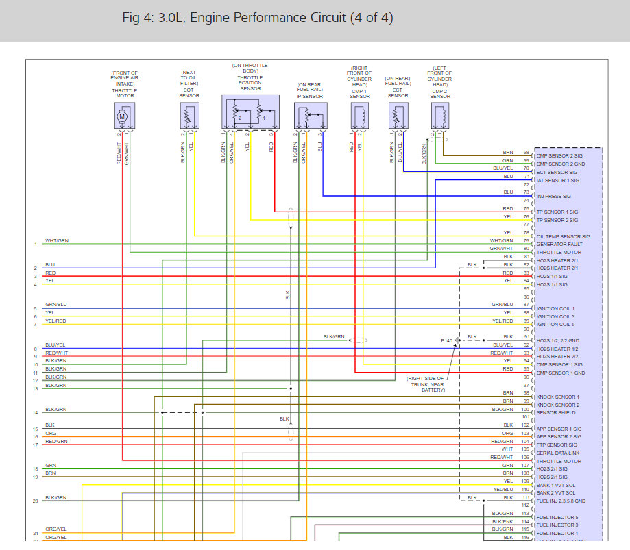

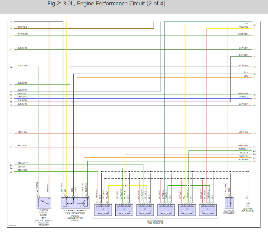

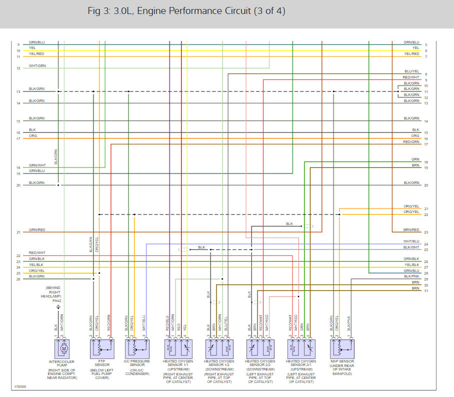

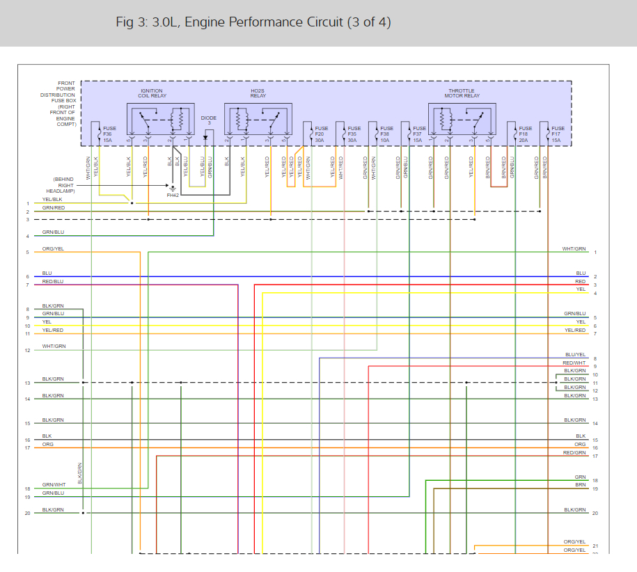

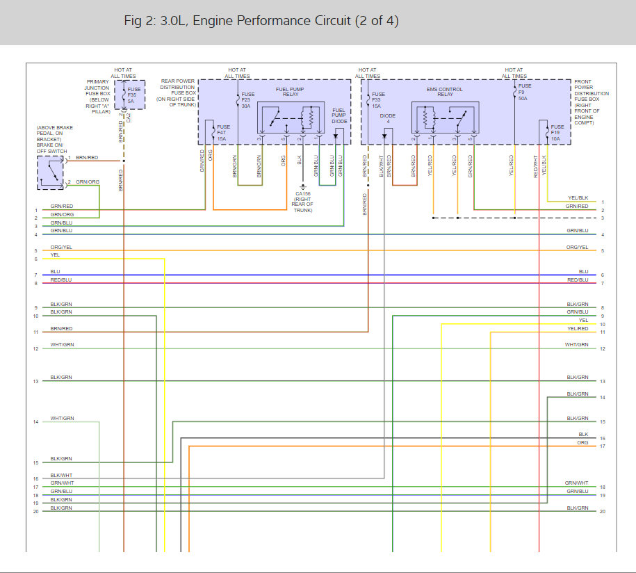

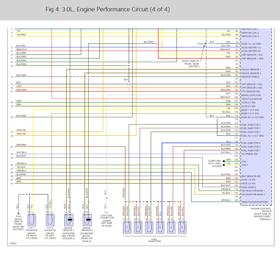

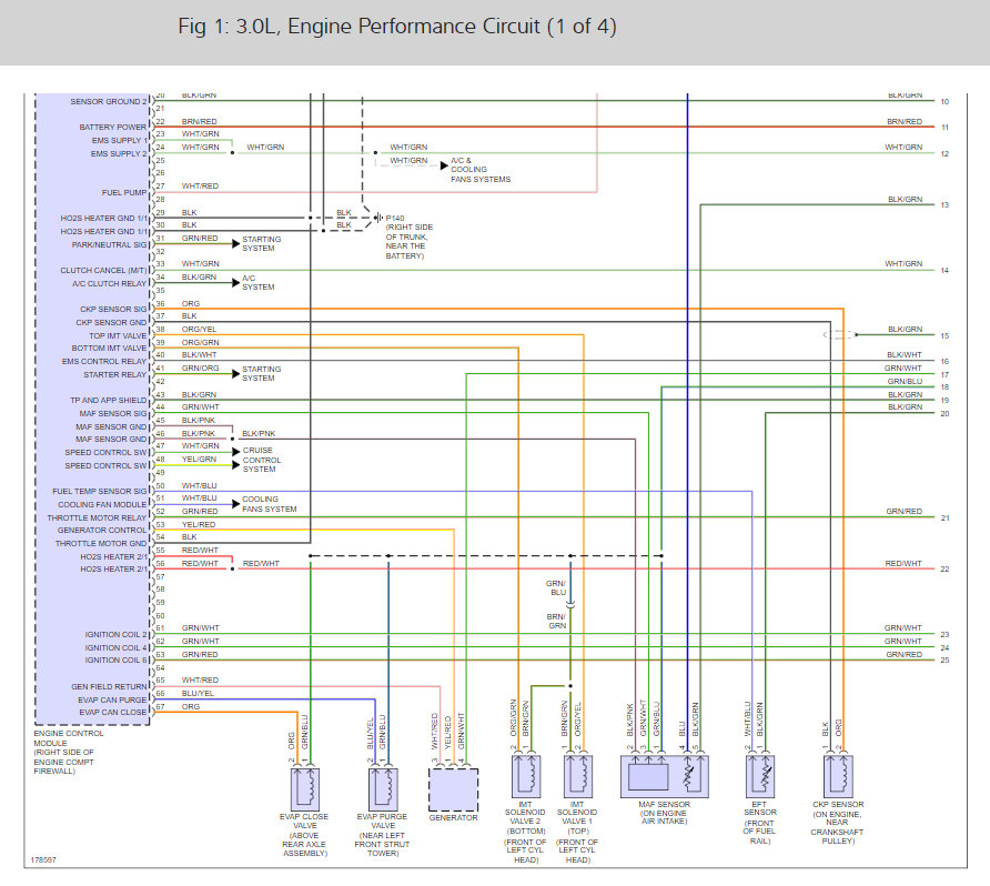

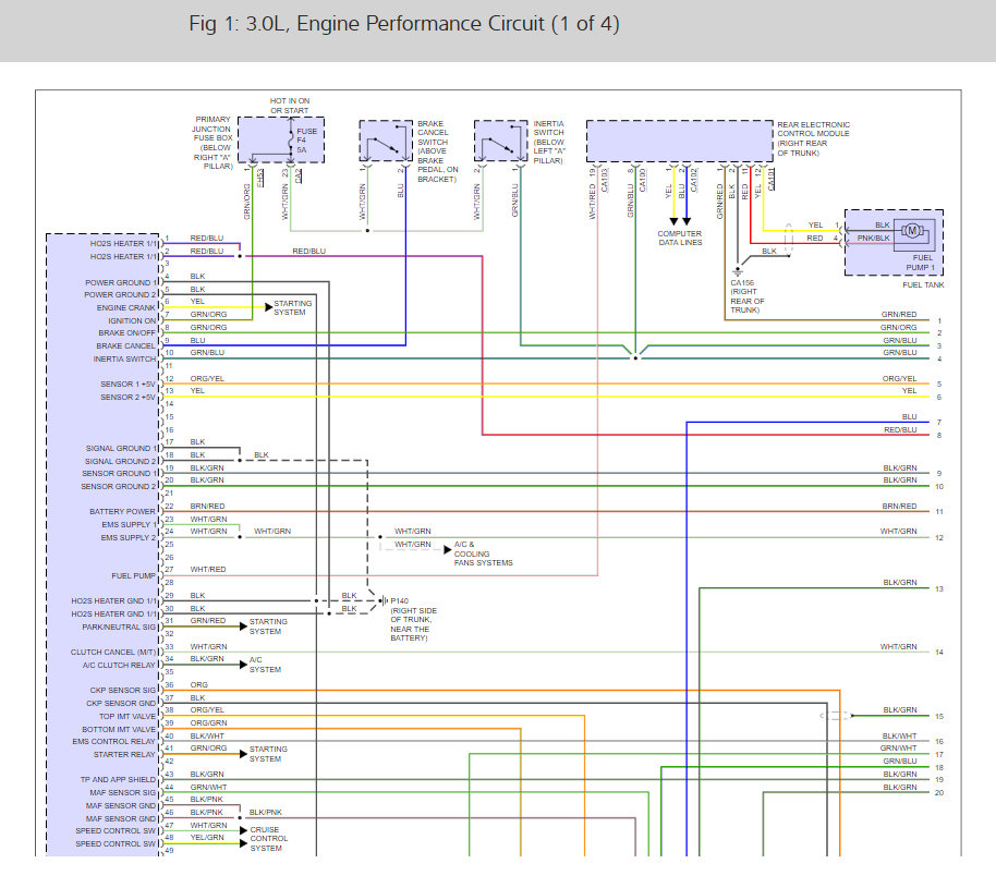

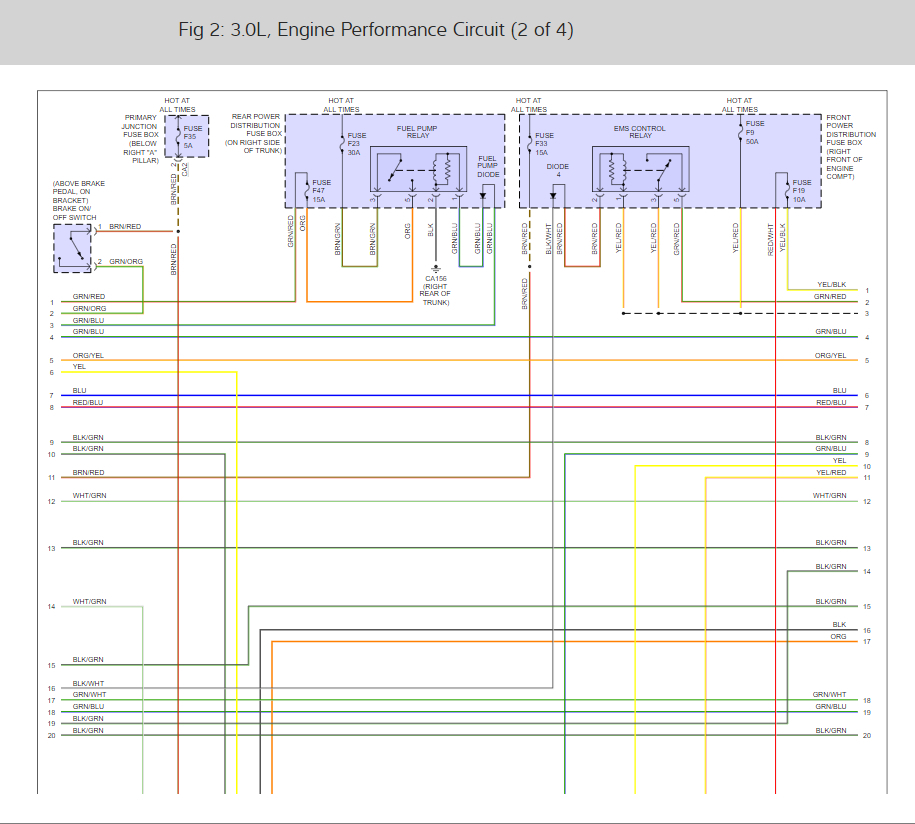

Hello, good morning. Can you please send me an image showing the ECU wiring diagram for my Jaguar 2003
S type car? Thanks in advance.
Dec 3, 2018 at 4:26 AM
  • 54,316 POSTS
Sure, here is the engine wiring diagrams showing the ECM and a guide to help you check the connections:
Check out the diagrams (below). Please let us know what you find.
Dec 3, 2018 at 6:39 PM

Thank you. Only the text is a bit not readable. Can you please make it clear if possible. Thank you Ken as always your so helpful sir.
Dec 4, 2018 at 6:04 PM
AUSTINO
  • 222 POSTS
I must apologize, I got the text to be readable by zooming. Thank you so much Ken.
