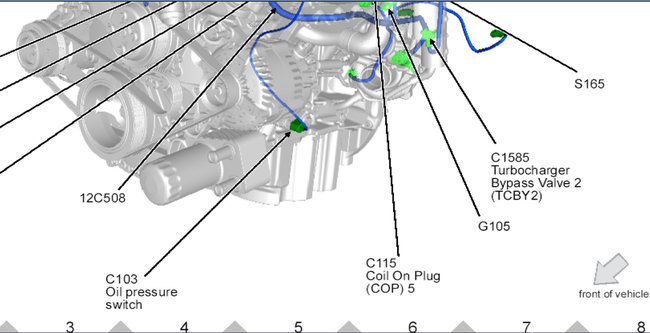

Oil gauge drops at idle.

Good morning,
It is located under the alternator behind the oil filter adapter. I attached a picture for you to view.

Thank you!

While you have it out, it would be good to check the actual pressure.
https://www.2carpros.com/articles/high-or-low-engine-oil-pressure
You can rent one at a parts store.
