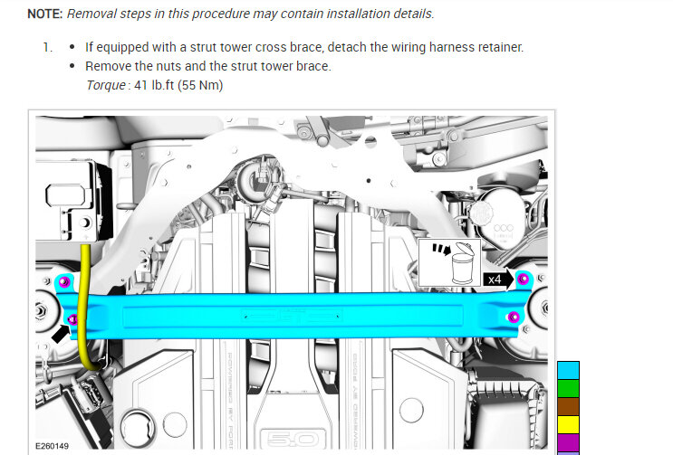

When the car gets to a full stop it sounds like it's choking and it turns off a lot when i come to a complete stop. And I'm very positive it's the camshaft sensors from what i believe but am having a very hard time finding the location of my model.
Mar 5, 2024 at 11:16 AM
  • 110,219 POSTS

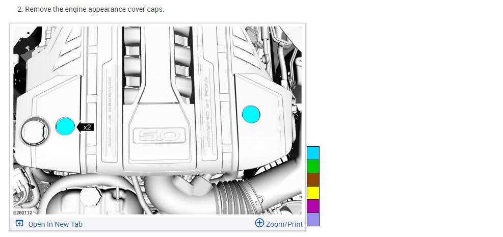

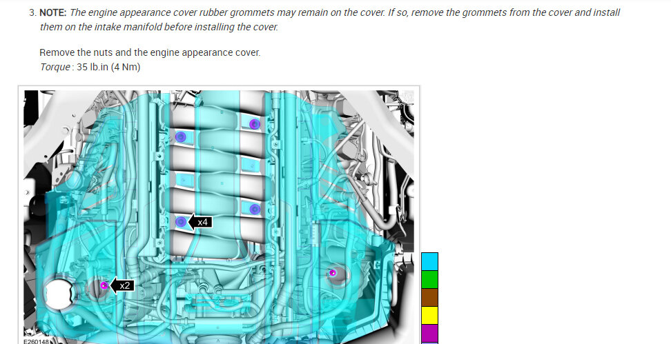

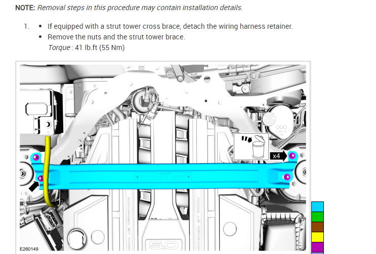

They hid them. Honestly, you have to take the engine appearance cover from the top of the engine to find them. Also, if your vehicle has the cross brace that runs from the top of the engine to the strut towers, that needs to be removed as well.

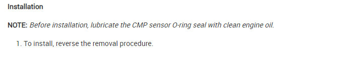

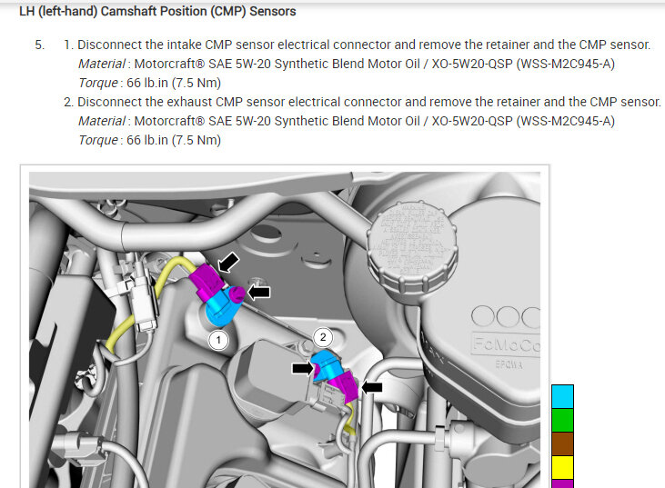

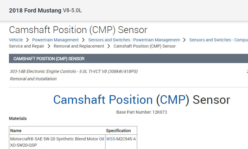

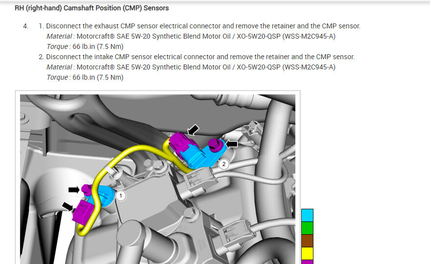

As far as the sensors are concerned, there are a total of four, two on each side (intake cam and exhaust cam). If you look below, I attached the directions for removing and replacing them. Take a look and let me know if you have other questions. Note: They are mounted at the top rear of the valve covers.
