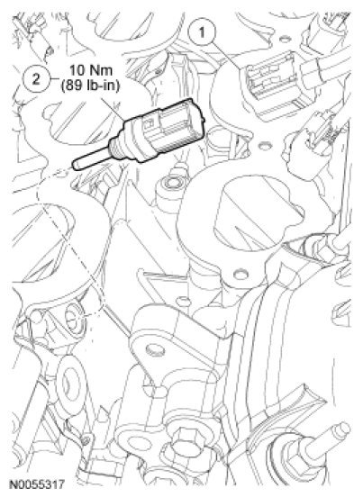

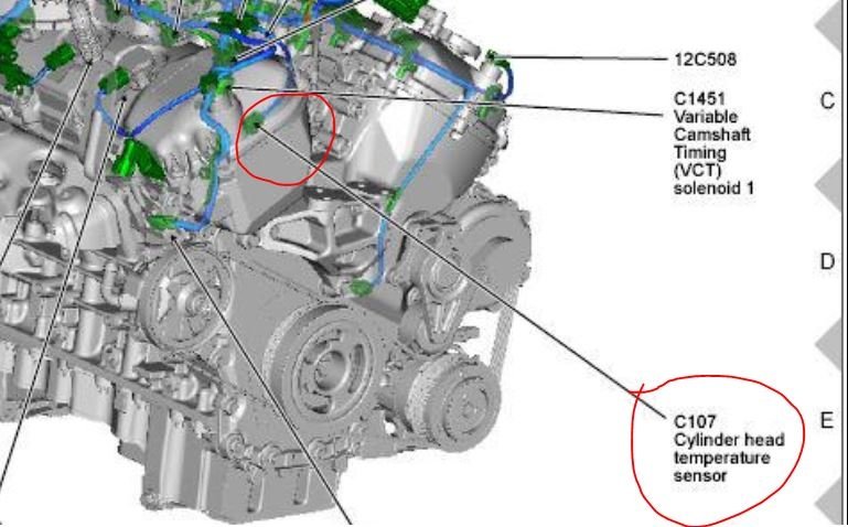

I've searched everywhere online, multiple forums and images through Google searches and I've had no luck in locating this part. I'm trying to locate the coolant temperature control sensor that tells the vehicle computer when to turn the fans on. I'd greatly appreciate an image of the actual location, because I have very limited auto knowledge, and descriptions people have given others in forums hasn't helped me locate it. Again, please share an image or diagram of this location, so I can finally fix my vehicle.
Jun 7, 2019 at 6:13 PM
  • 110,190 POSTS
Welcome to 2CarPros.
This vehicle has a cylinder head temperature sensor (CHT) which signals the computer. The bad news is you have to remove the intake manifold to access it. It is located under it. Picture 1 shows its location.

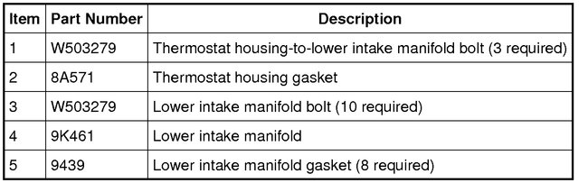

Here are the directions for removing the lower intake manifold. Sensor replacement will follow. All attached pictures correlate with these directions.
__________________________________________
See Picture 2

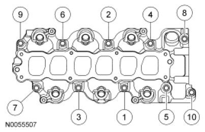

See Picture 3
Removal
NOTICE: During engine repair procedures, cleanliness is extremely important. Any foreign material, including any material created while cleaning gasket surfaces that enters the oil passages, coolant passages or the oil pan, may cause engine failure.
1. Remove the fuel rail.
2. Drain the cooling system.
3. Remove the 3 thermostat housing-to-lower intake manifold bolts.
4. Remove the 10 bolts and the lower intake manifold.
- Remove and discard the intake manifold and thermostat housing gaskets.
- Clean and inspect all sealing surfaces.

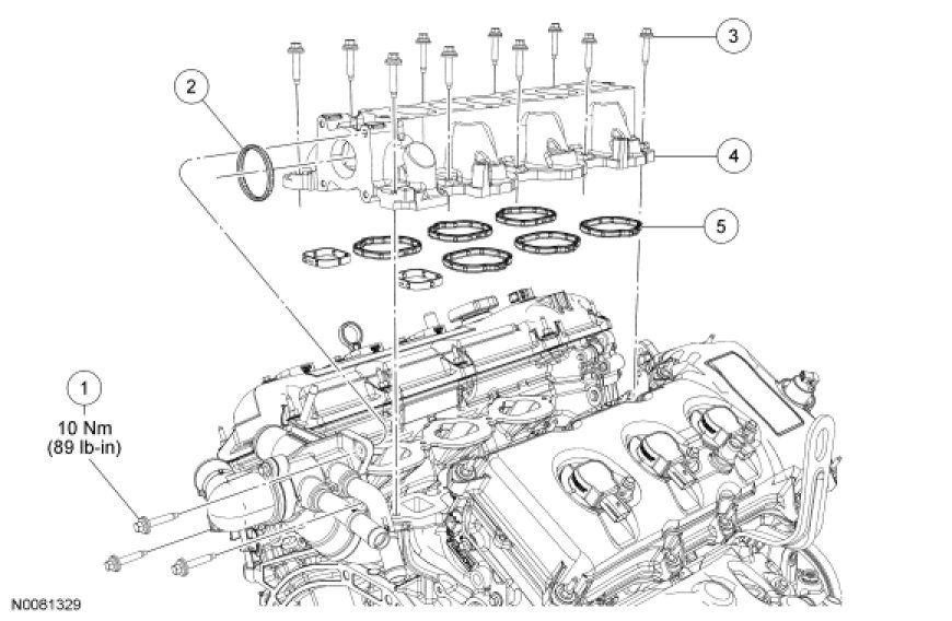

Installation
1. NOTICE: If the engine is repaired or replaced because of upper engine failure, typically including valve or piston damage, check the intake manifold for metal debris. If metal debris is found, install a new intake manifold. Failure to follow these instructions can result in engine damage.
Using new intake manifold and thermostat housing gaskets, install the lower intake manifold and the 10 bolts.
- Tighten in the sequence shown to 10 Nm (89 lb-in).
See Picture 4
2. Install the 3 thermostat housing-to-lower intake manifold bolts.
- Tighten to 10 Nm (89 lb-in).
3. Install the fuel rail.
4. Fill and bleed the cooling system.

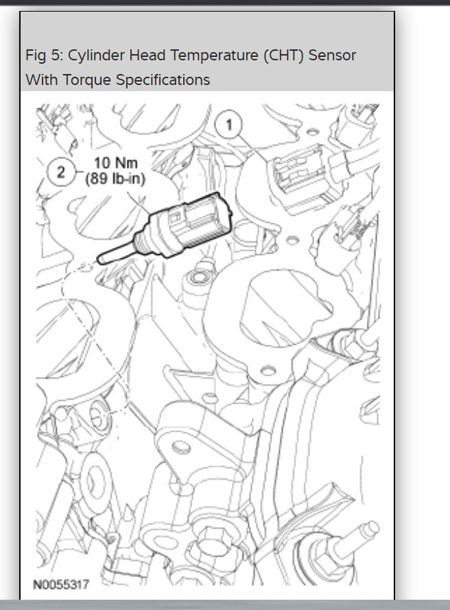

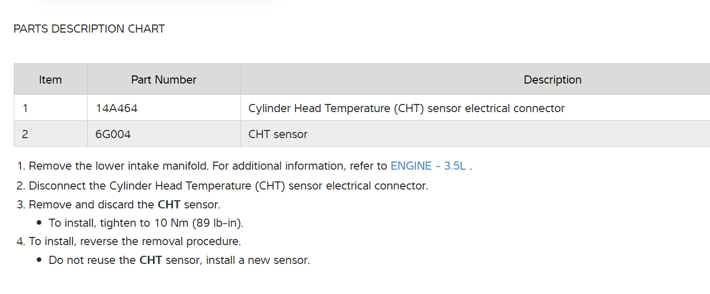

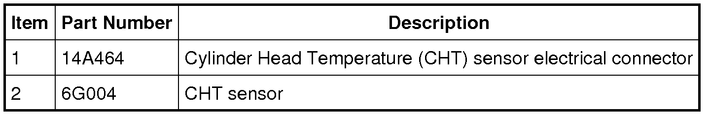

Sensor Replacement
Cylinder Head Temperature (CHT) Sensor
Picture 5
Picture 6
1. Remove the lower intake manifold.
2. Disconnect the Cylinder Head Temperature (CHT) sensor electrical connector.
3. Remove and discard the CHT sensor.
- To install, tighten to 10 Nm (89 lb-in).
4. To install, reverse the removal procedure.
- Do not reuse the CHT sensor, install a new sensor.

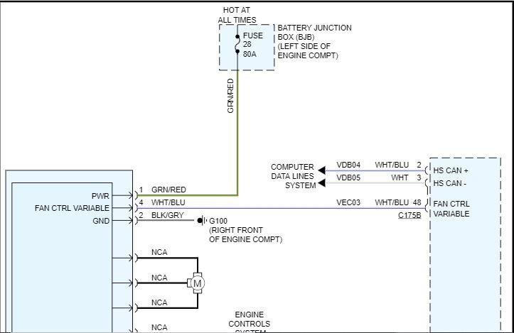

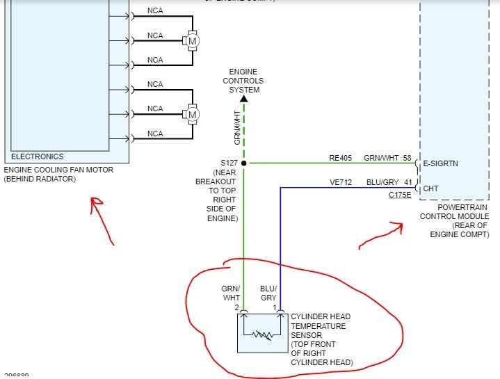

I attached a wiring schematic of the cooling fan circuit. I circled the CHT and pointed to where the signal goes. First it is sent to the PCM and then power goes to the cooling fans. I had to cut the pic in half, but I did overlap them so you can follow it.
Let me know if this helps.
Jun 12, 2019 at 8:32 PM

I added those pictures to show that the cooling fans receive their signal from the sensor you replaced. Tell me, have you checked the basics such as fuses, relays, and the fan motors themselves?
Let me know. I want to help you through this.

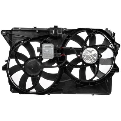

To explain the situation a little better, the original issue is that the fans on the fan assembly weren't running at all. The fuses and relays were the first things I checked. The first part I replaced was the sensor control module attached to the fan assembly, and the pigtail connector going into the control module. After I hooked everything back up, the fans turns on. This is also when I found out the fans didn't shut off. I let the vehicle run for about twenty minutes, then turned the vehicle off. The fans remained on, so I let the vehicle fans run for another fifteen minutes before having to disconnect the battery. The most recent things I've replaced, was the gaskets to the manifold, and the temperature control sensor that you thankfully walked me through on replacing. The only things I haven't replaced yet, is the PCM, and the actual fan assembly itself. As a side note, when I replaced the pigtail connector going from the vehicle power to the sensor control module, I noticed after matching the wires up, the part was actually backwards compared to the original part position. I'm not sure if maybe the aftermarket part manufacturer did it wrong, but I'm not sure. This has been a pretty frustrating issue for me, because the vehicle has been disabled for going on three months now. I'm frustrated because I can only afford to buy a part every two weeks due to finances, so this repair has been stretched longer than it should. I'm just tired of guessing, and none of the things i buy and replace have fixed it.

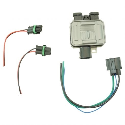

Sorry for the confusion. I don't really know much when it comes to repairing vehicles. I'll share a couple photos that might help me in explaining. I did what you mentioned this morning in terms of removing the relay. When I did that, the fans stopped working. They turned back on after plugging the relay back in.
In the first image, there's the fan assembly for my vehicle. On the left blade, there is a silver box. That's the sensor control module that I first replaced. In the second image, it has the control module in the top left, and right under it is the pigtail connector that connects straight into the control module. When I mentioned the wiring issue I wasn't sure about, it was in regards to this pigtail piece. When I removed the original pigtail, the wiring was all flush and straight without any twisting or anything. When I got the new pigtail and matched up the wire colors, the grey connector piece was turned around. I ended up having to essentially twist the wiring after connecting it in order to connect the pigtail to the control module.
