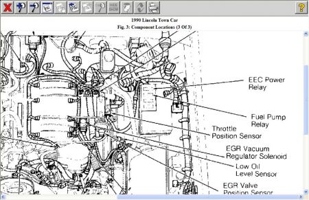

hi iv checked every sensor on the car im getting fuel to the rail but im not getting power to the the red wire of the injector harness I did however run a hot wire to the injector harness and the car runs fine my question is is the pcm bad or is there a broken wire and is it possible to run my on hot wire but I think the voltage needs to be droped so I don't fry the injectors

Check fuse no.13 in fuse block and fuse T in engine compartment fuse block if okay
Inspect and test the EEC Power relay-it powers the injectors

Where is the eec is it the three relays on the driver side of the motor

See below
https://www.2carpros.com/forum/automotive_pictures/12900_eec_relay_1.jpg

What sensor that's causing it to die when you plug it back in?
Did you check the EEC Relay? -The power source to the injector comes from there.
