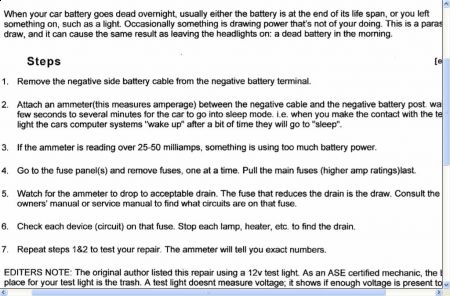

Replaced battery and alternator, works for a day r so, then dead again. I'm stumped.
Monday, March 8th, 2010 AT 8:17 AM
MECHANIC
75,992 POSTS
Replace both and won't crank next time-sounds like a short circuit draining the battery -Do battery drain test below
