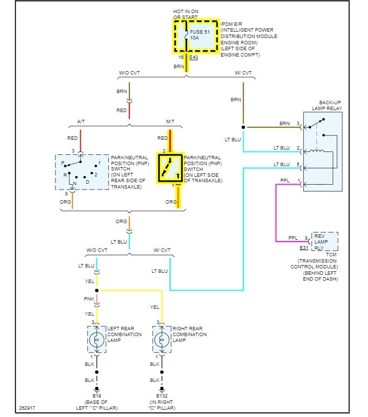

Backup lights keep blowing the fuse?

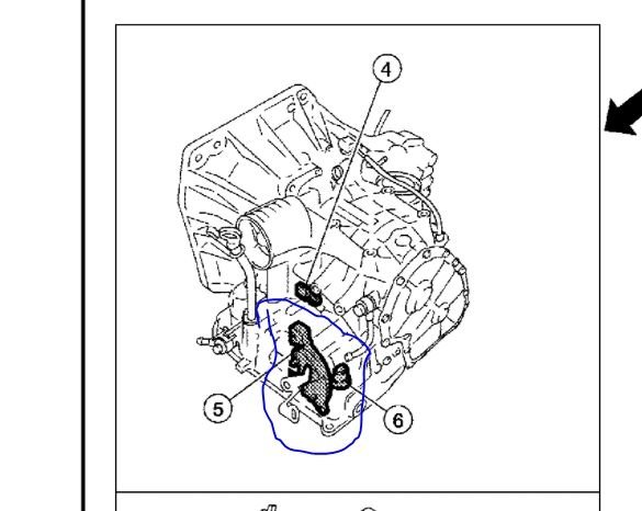

Good morning,
I attached a wiring diagram and the location of the switch.
The switch is the most common cause for this. Beyond that, it is a wiring issue somewhere.
