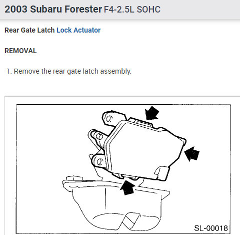

The rear liftgate will not open?
2003 SUBARU FORESTER
120,000 MILES
DIZZY1
the rear liftgate will not open, I suspect the cable from the handle to the latch. I can see the latch through the small access hole in the inside panel and have tried pushing it up and down. How do I get it to pop?

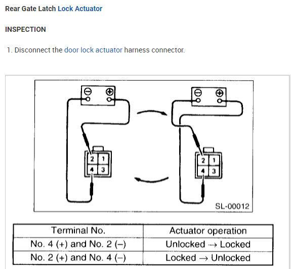

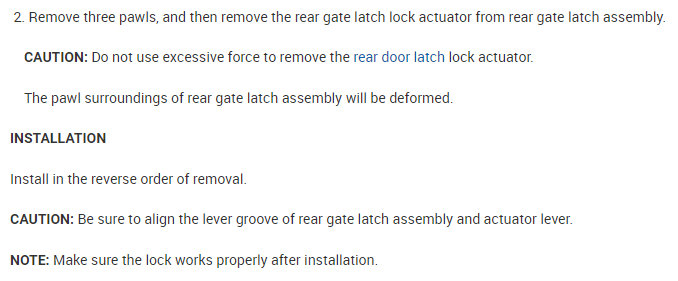

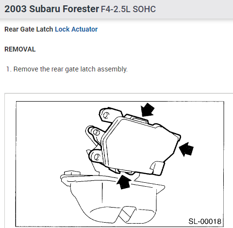

Hello, I'm Danny.
Here is the information you requested. This is a tutorial showing how to test electrical wiring:
I've attached a rear liftgate latch wiring diagram as well as how to remove the liftgate latch-actuator which you may be having a problem with. Hope this helps and thanks for using 2CarPros.
