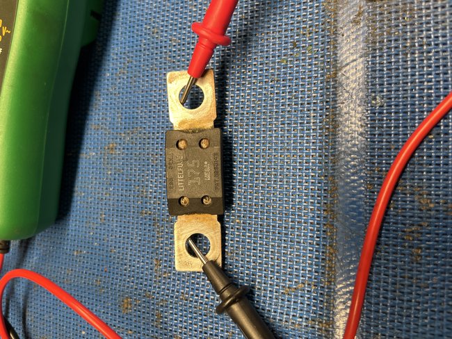

Hi, on that little fuse 175, should I have continuity going through the test leads from one side to the other? If I test it I do not, but if I test voltage from one side to the other I see voltage but no continuity.
Wednesday, December 15th, 2021 AT 1:15 PM
CONNECT HAMPTONROADS
  • 48 POSTS
HI, sorry to retract above, but I am seeing continuity from ends when its off, but the middle test points show no continuity. Does this matter?
Wednesday, December 15th, 2021 AT 1:21 PM
  • 48 POSTS
So, those ends I get continuity but leads in center I don’t, but when hooked up I get voltage touching leads but no continuity.
Wednesday, December 15th, 2021 AT 1:26 PM
  • 52,797 POSTS
When it is hooked up. Do you have voltage on both sides of the fuse?
Wednesday, December 15th, 2021 AT 1:29 PM
  • 48 POSTS
Yes sir, so that is functioning, I guess? :)
Wednesday, December 15th, 2021 AT 1:38 PM
  • 52,797 POSTS
Correct.
Why are you testing this?
Wednesday, December 15th, 2021 AT 1:46 PM
  • 48 POSTS
Honestly, I don't know, I"m just checking for voltage out from anywhere that leads to a possible issue.
Wednesday, December 15th, 2021 AT 1:50 PM
  • 52,797 POSTS
You need to go to the wire I have identified for you at least 2 times at the body control module.
That's where you test, nowhere else.
Wednesday, December 15th, 2021 AT 1:58 PM
