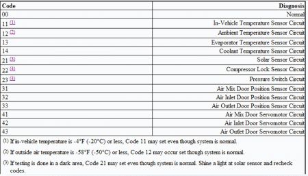

I think after I hit a bump in the road my air conditioner nor my outside temperature(it's a thermostat that tells me the outside temp) doesn't work, i'm guessing both of these parts are linked to each other. I checked the fusses for my heater/ac & electrical componants and the fusses are fine. I can't figure out why my ac won't turn on, everything else in the car works fine. Like the in car LED system(not the radio but the A/C & heater part), the whole air conditioning system & the outside temperature gauge won't power on.
Is there any suggestions on what electrical problems I may be experiencing in association with my a/c system not working?

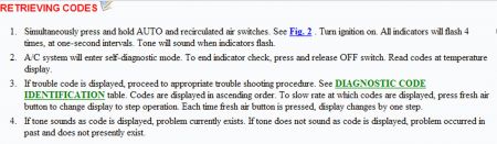

Try this, a code 22 or 23 means it's a current problem not stored in memory...
https://images.2carpros.com/forum/automotive_pictures/62217_Self_Diag_AC_1.jpg
https://images.2carpros.com/forum/automotive_pictures/62217_Self_Diag_AC_Codes_1.jpg

I tried that, my air conditioner system still won't power on when I turn on the ignition or start my car.
im just guessing its an electrical problem but I dont know where to start. maybe I missed a fuss or something?
