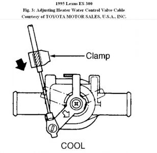

I bled the system as you suggested. There was indeed small and big air bubbles rising to the top of the radiator. After about 7 or 8 minutes though the coolant level suddenly drops and it starts to spit the coolant out of the top of the radiator. I immediately shut the car off. Also after further checking the top radiator hose was hot but the bottom radiator hose was not hot or even warm at all. I also found that the top heater core hose was hot and the bottom one was cool I checked because I was still getting no heat. What now?
+1
Wednesday, October 20th, 2010 AT 6:32 AM
KHLOW2008
  • 41,814 POSTS
1. Remove radiator cap.
2. Top up the coolant.
3. Close the radiator cap and run engine for 5 minutes.
4. Wait for engine to cool down.
5. Repeat above till the coolant level is at radiator neck when radiator cap is removed.
The upper hose being hot whereas the lower is cool because the thermostat is not opening when there is insufficient pressure.
The lower heater hose being cool could be due to the heater water control valve not opening correctly.
Check the valve cable adjustment.

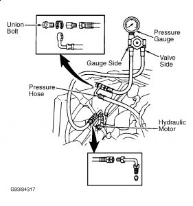

I have had several problems with my engine overheating. We have changed the thermostat and water pump. It is still overheating. I understand that it has a hydrolic hose and the cooling fan is ran off of power steering fluid. The fan is moving, but not very fast(I can stop it with my hand) Is this normal? Could this be the problem? Do I need to replace the power steering pump or does it have a filter that can be changed? The power steering is fine and the fluid is full. We are having a hard time trying to figure out what is wrong.
Wednesday, December 18th, 2019 AT 10:00 AM (Merged)
DOCFIXIT
  • 18,828 POSTS
Hi
Fan needs to be rotating very fast. There are two hydraulic pumps in P/S. One for steering and another for coolin fan.
need to check system pressure 142-284 psi. I'll provide diagram but think trip to Dealer maybe needed.
https://www.2carpros.com/forum/automotive_pictures/198357_Graphic_34.jpg
