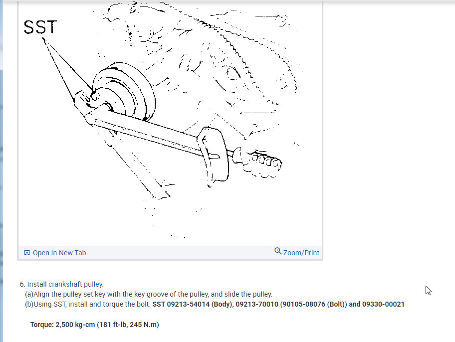

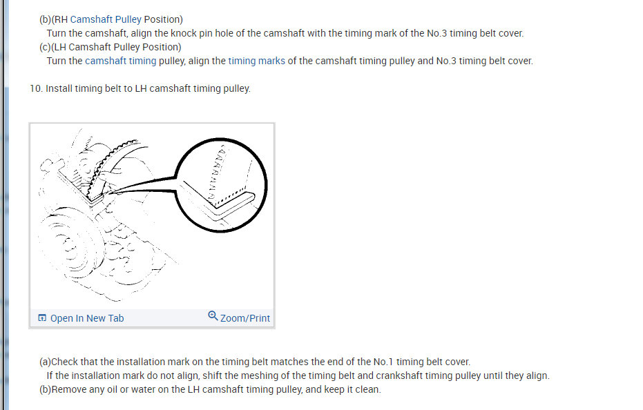

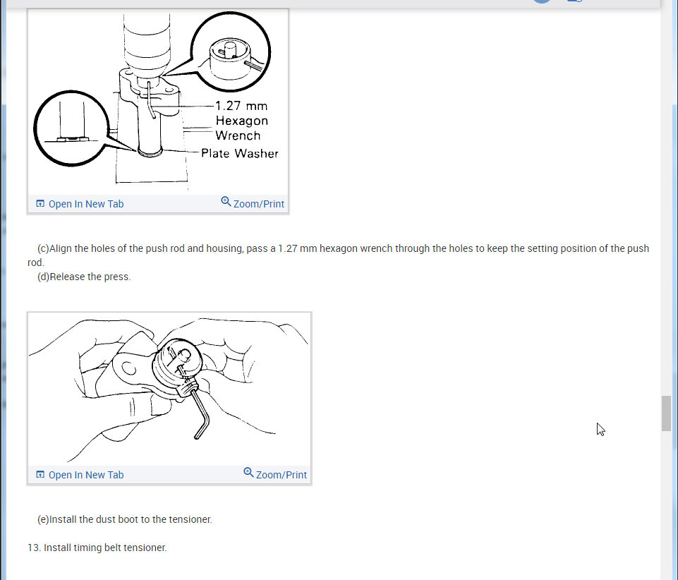

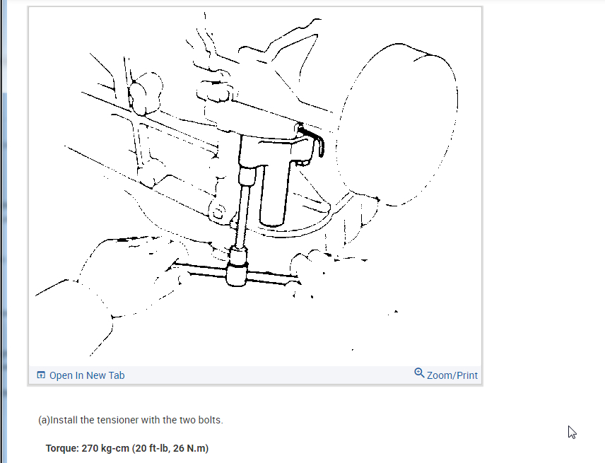

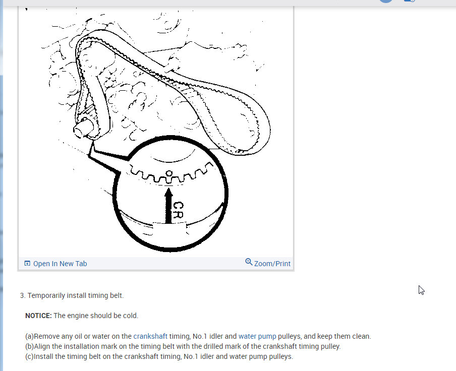

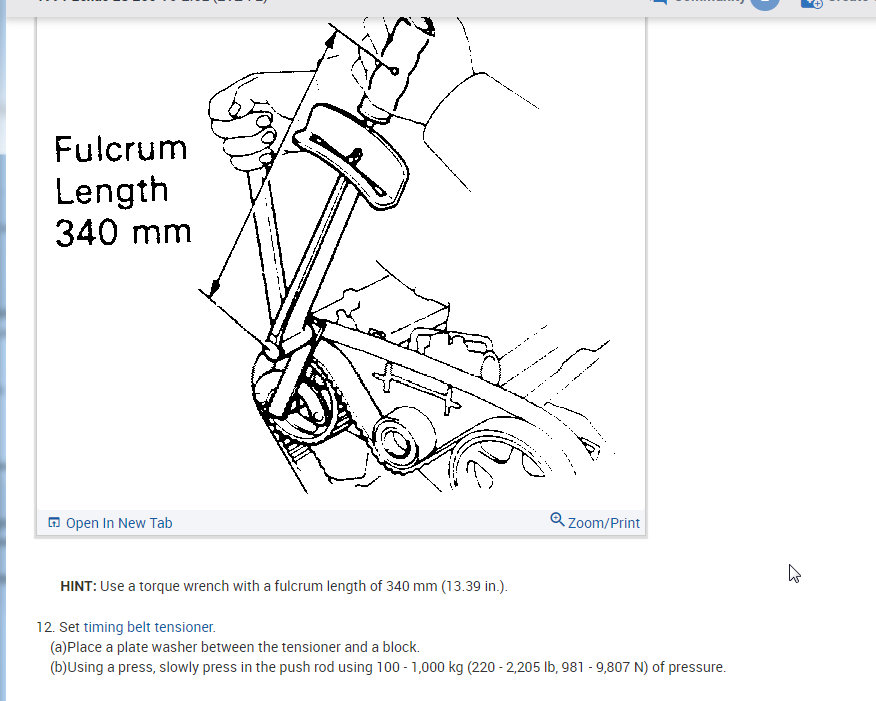

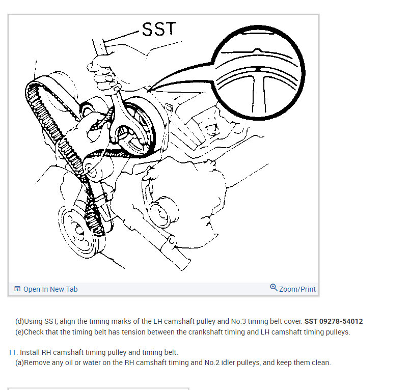

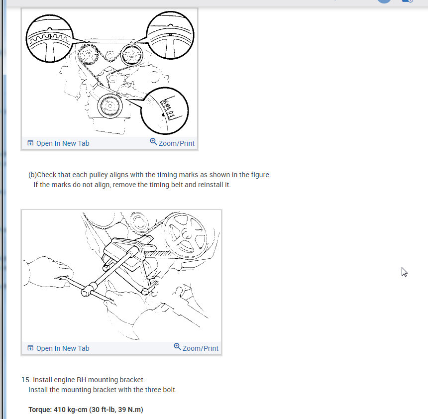

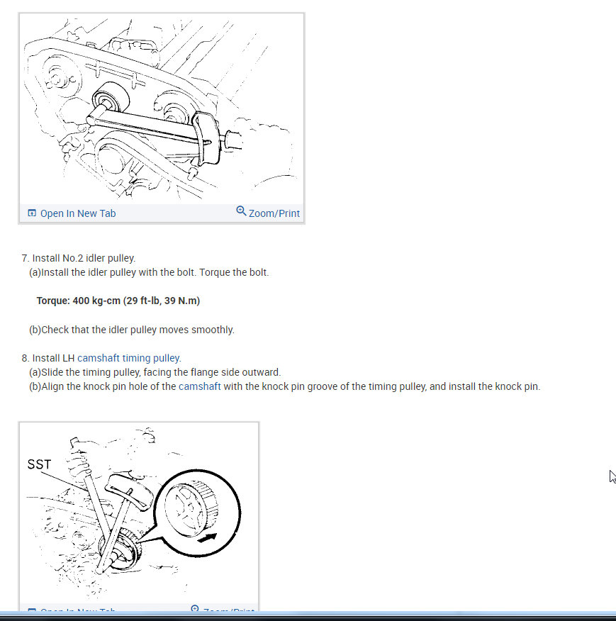

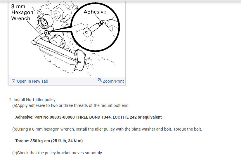

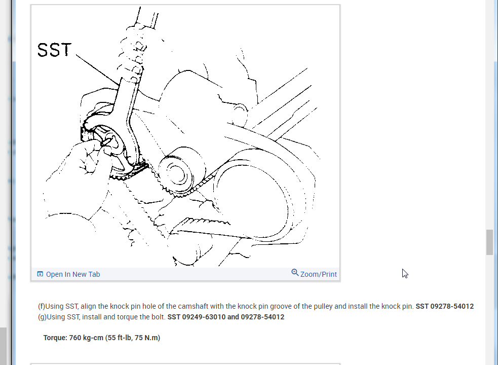

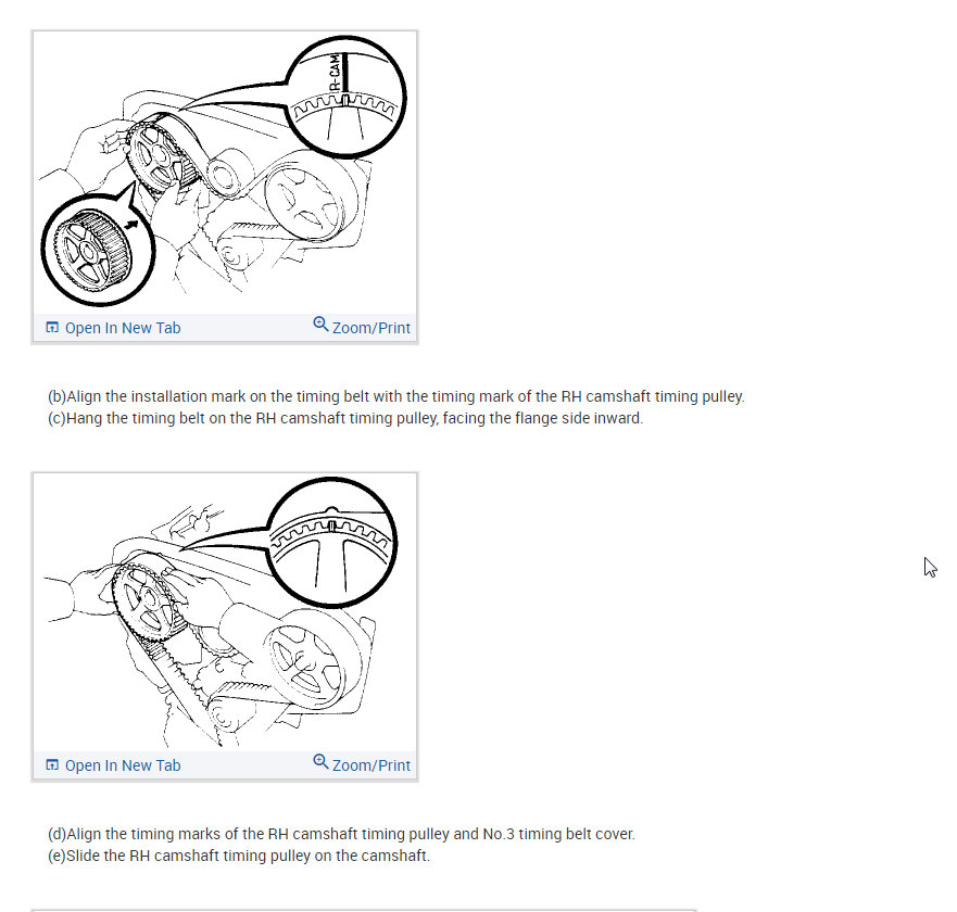

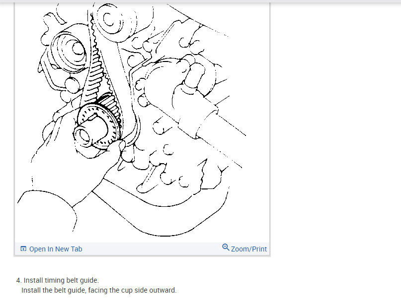

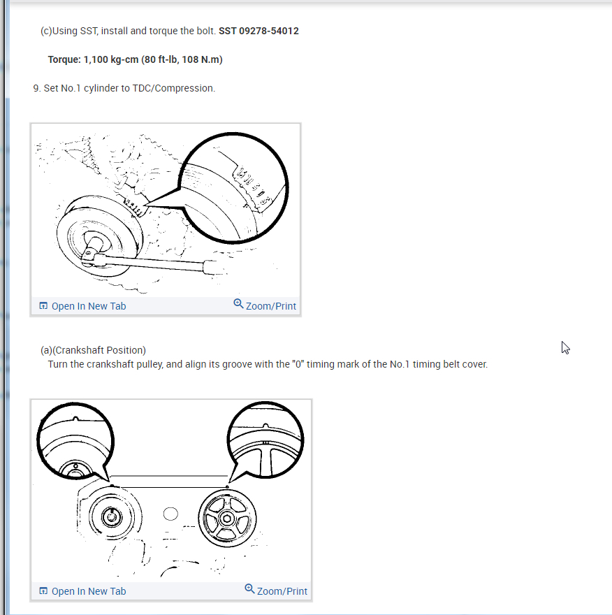

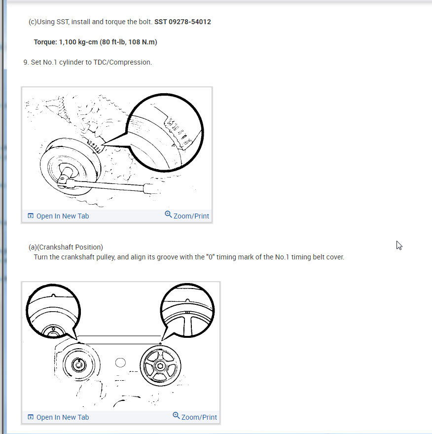

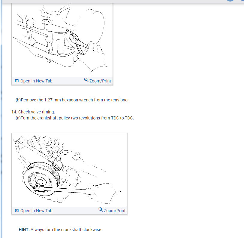

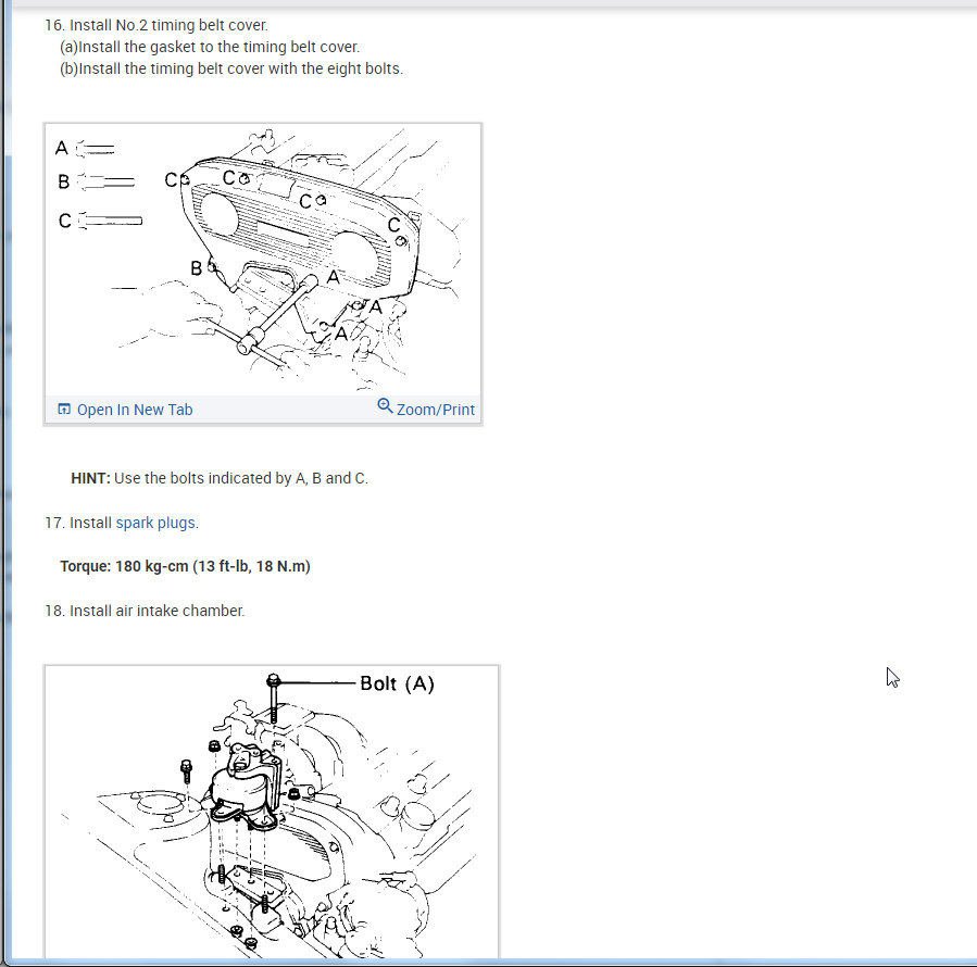

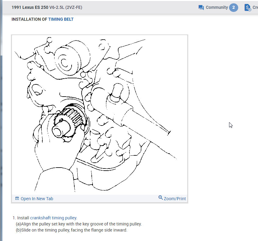

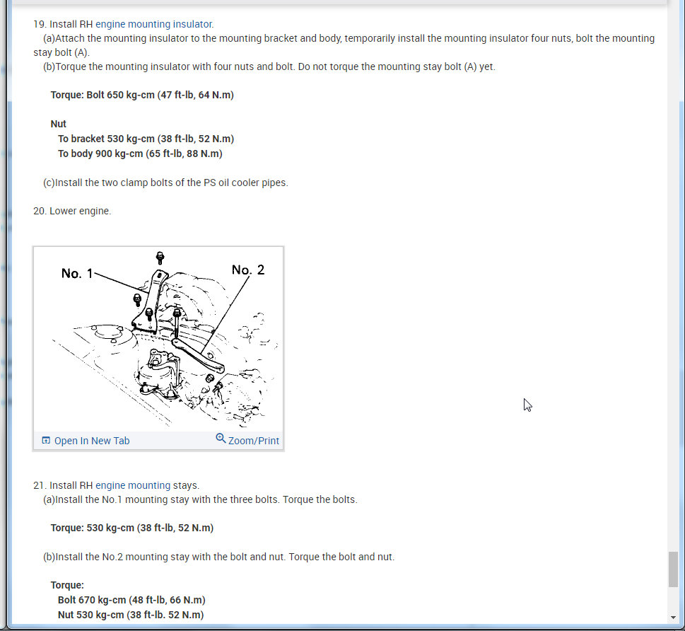

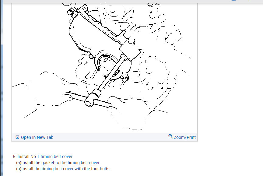

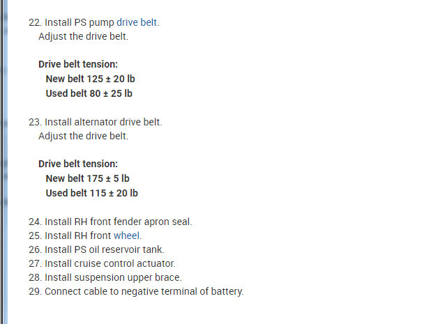

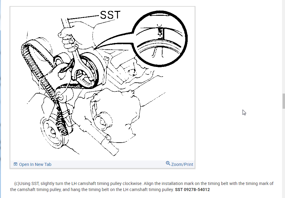

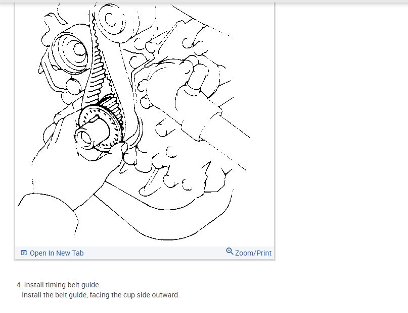

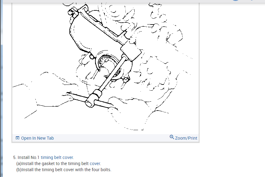

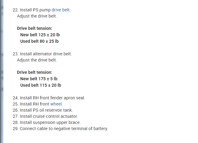

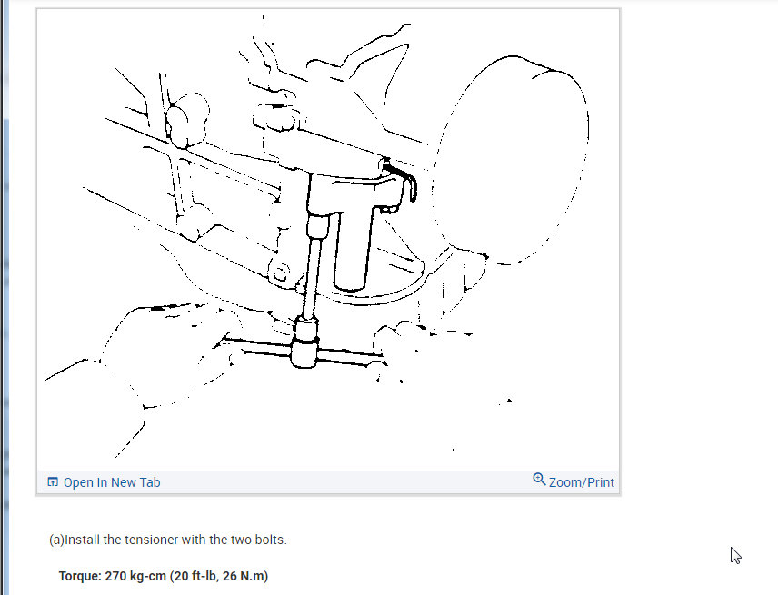

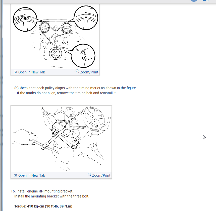

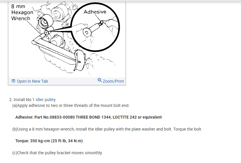

Okay, so I've got the same problem on my 1991; it will crank over but will not start. I've replaced the timing belt so I know it's not broke. I've replaced the coil DCM, the fuel pump, plugs wires, cap and rotor. It was running fine up until I changed the timing belt. I don't know if I broke a wire I've checked all the fuses. Any suggestions?
Friday, January 29th, 2021 AT 4:46 AM
If this just started after doing the timing belt then I suspect the timing is not correct. We can confirm this by running a compression check.
If this proves out then I attached the process on how to install the belt below for your review.
Also, here is a guide on the issue in more general terms in case you or others have this issue:
https://youtu.be/dCjmRL3p4Cs
Let me know what the compression readings are and we can go from there.
Monday, February 1st, 2021 AT 4:07 PM
