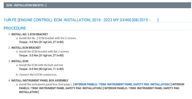

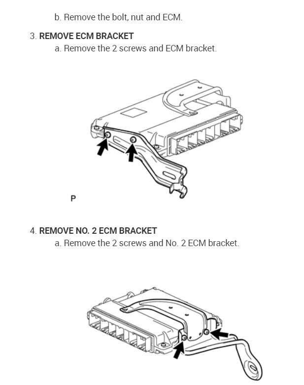

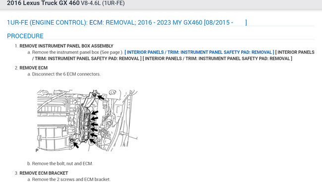

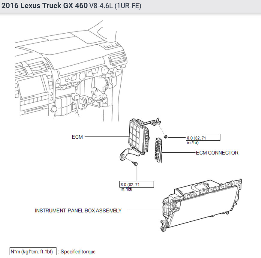

So, the mechanic shop replaced a sensor in the car. It was running fine and then my check engine came on and the car won't start again. My husband used his tool to see what error codes would come up and it wasn't showing anything. So, I think we're going to try and get it to our local Lexus dealer for service. Any suggestions?
Jun 20, 2023 at 5:37 PM
  • CAR REPAIR CONTRIBUTOR
  • 54,274 POSTS
It sounds like the PCM has gone out. Here is the location of the unit and how to replace it, you can get a preprogrammed unit by searching Google or Ebay. Check out the images (below). Please let us know what happens. You might want to see if the water got into the PCM or into the electrical connectors.
