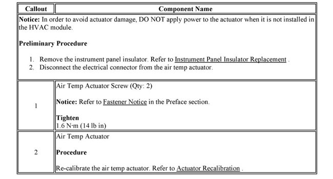

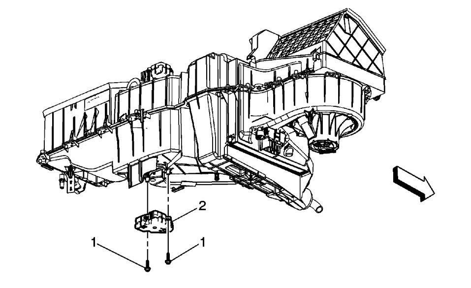

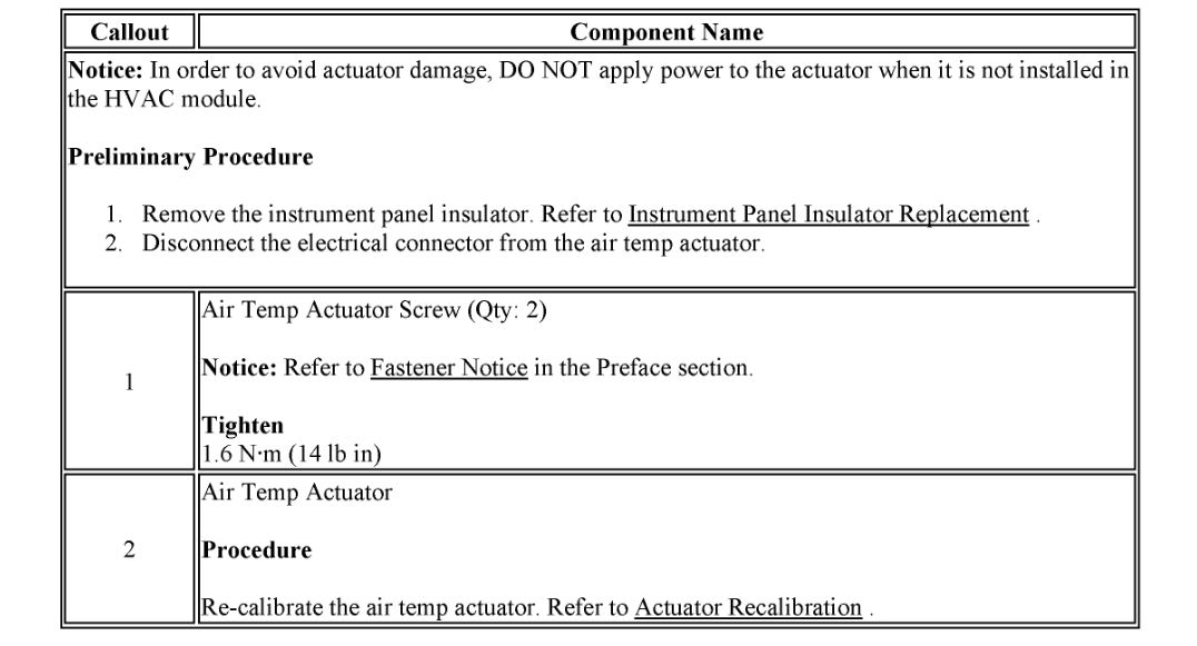

Do I have two blend doors?
Monday, August 27th, 2018 AT 8:13 PM
MECHANIC
52,796 POSTS
Good morning.
It shows you have a blend door for each side.
Below is the procedure and a picture of the location of the blend door actuator for the left side.
