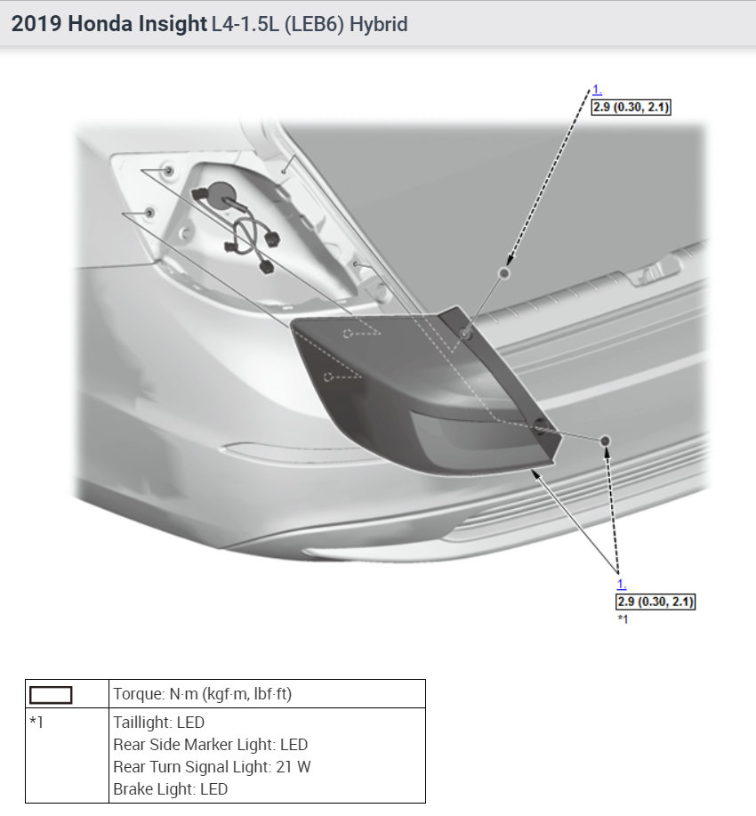

Would you know if these LED blinkers would work in the 2019 Honda insight hybrid and If so what size of the bulbs and will they even work in my vehicle?

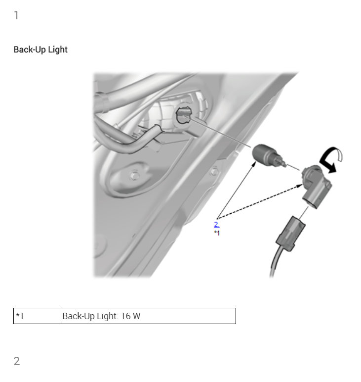

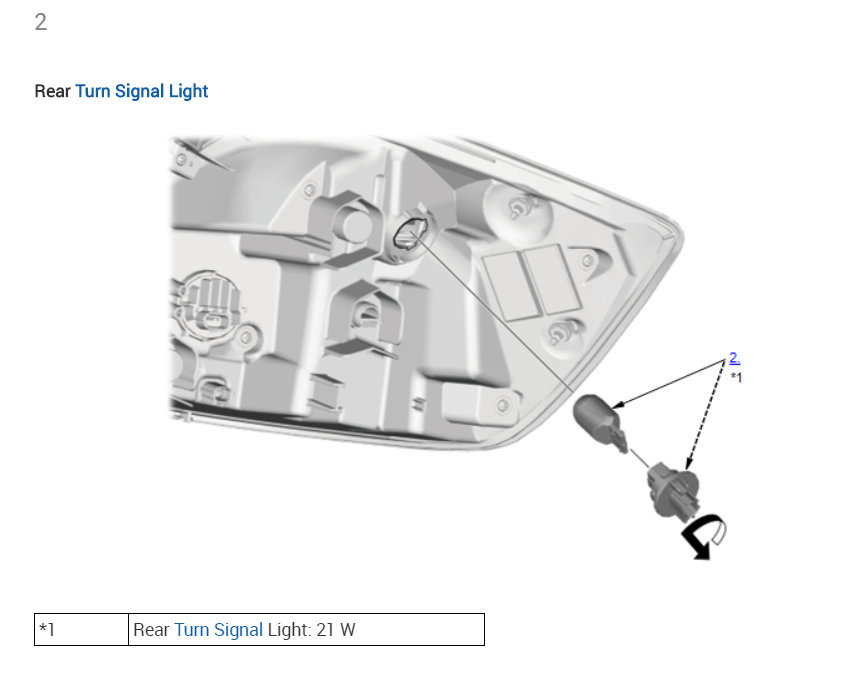

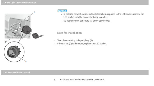

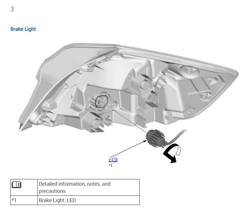

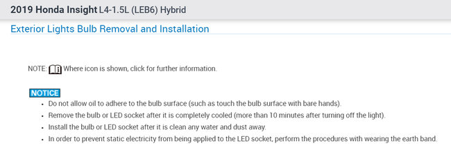

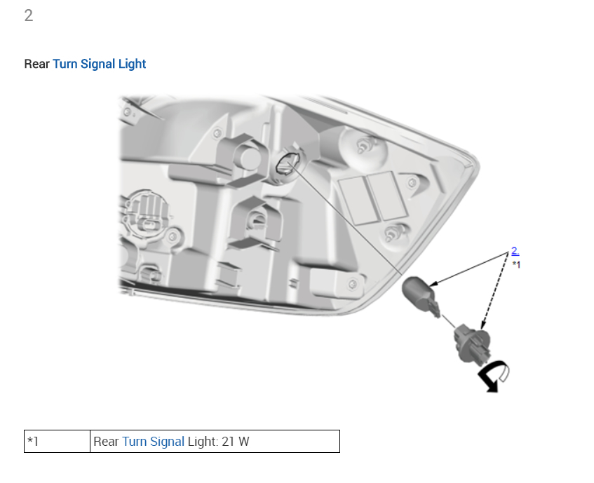

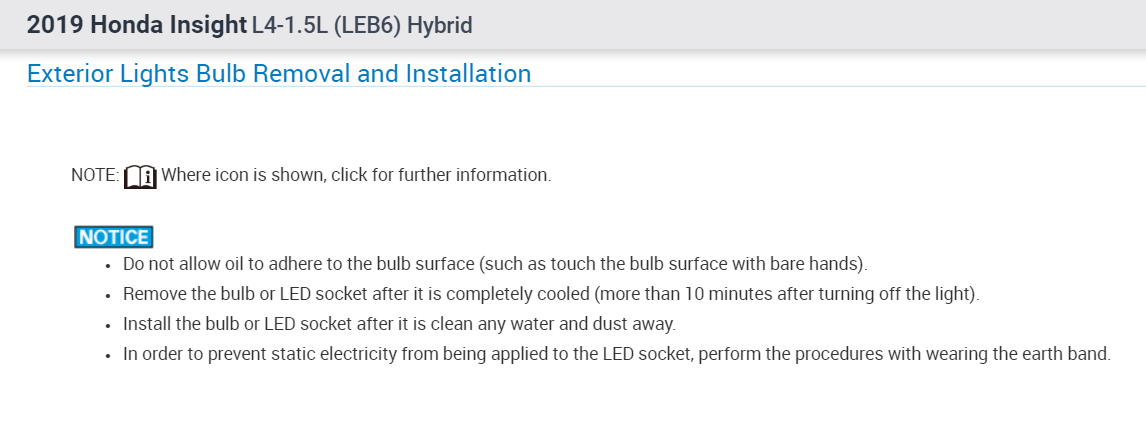

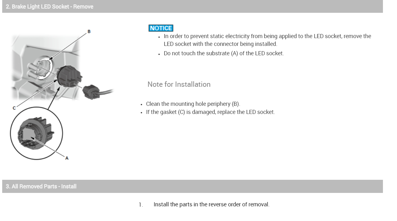

It says the bulbs are already LED. Here are the part numbers and instructions on how to change the brake light and running light bulbs which show the LED's:
12v16w - 33506S8RN51 $5.68
12v21w Amber - 33303SCK003 $6.23
Can you please shoot a quick video with your phone so we can see what's going on? That would be great. You can upload it here with your response. Check out the diagrams (below). Please let us know what happens.

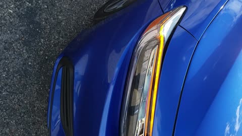

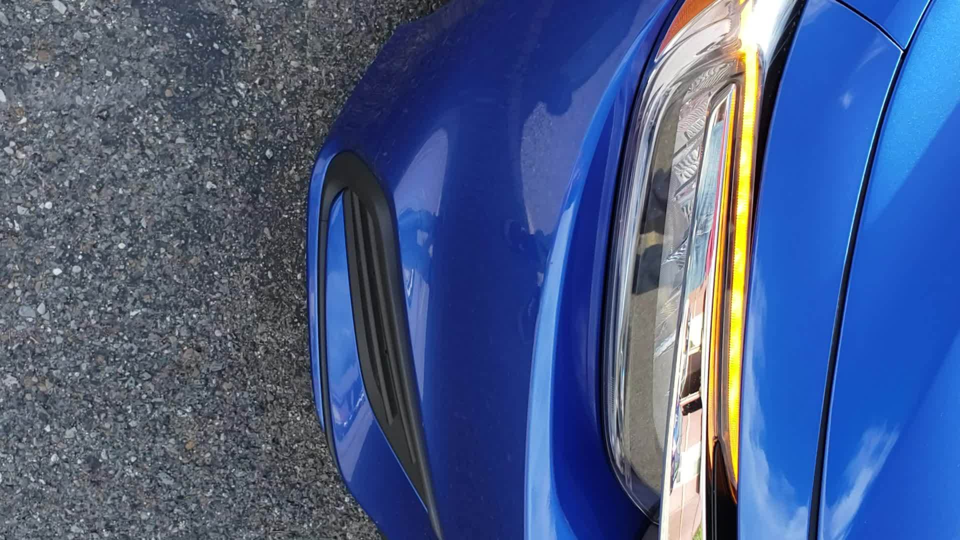

My video.

Thanks for the video. Okay I see, yep lets try the LED rear bulbs to see whats happens. Please send a new video once the bulbs are installed. I am interested to see what happens.

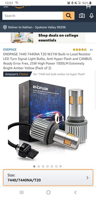

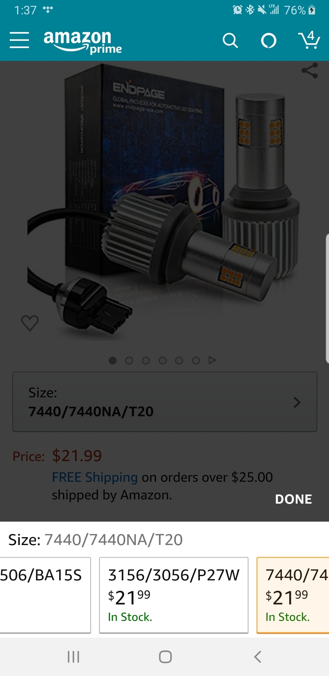

What size of bulbs do I need and to do the ones from the Amazon link that I sent you work?

Yes they look like they will work. Let me know how it goes.

Which size of bulbs do I need? They only offer 3 sizes.

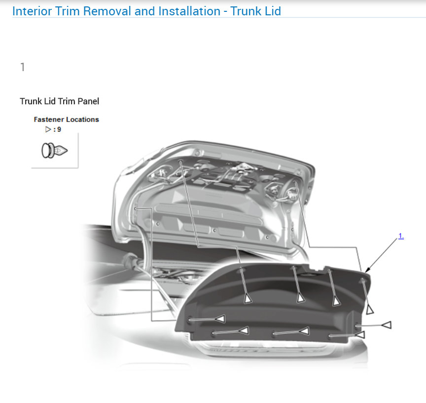

Hello again.

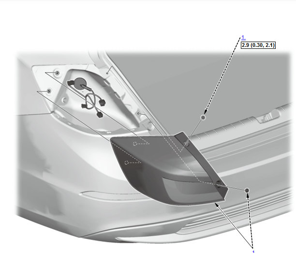

Here is an image below on the taillight assembly removal. When you remove the bulb give me the number and I can cross reference you an LED bulb number. Thanks again for using 2CarPros.

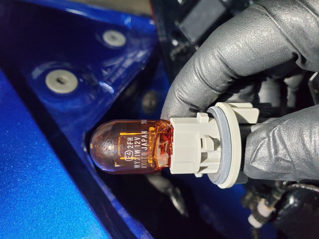

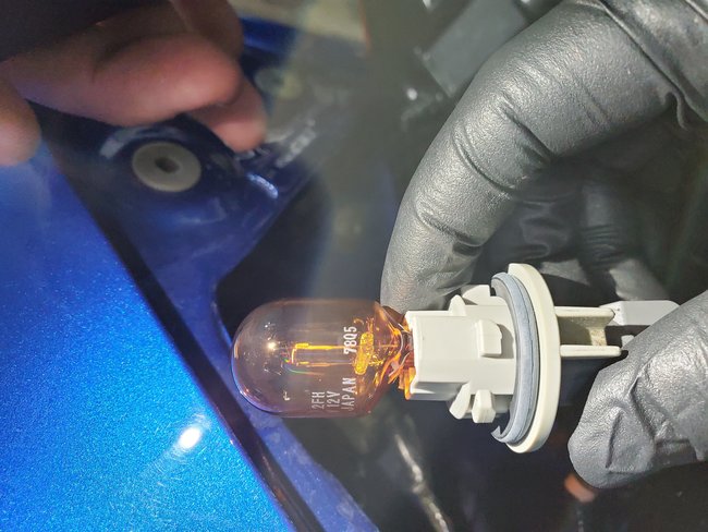

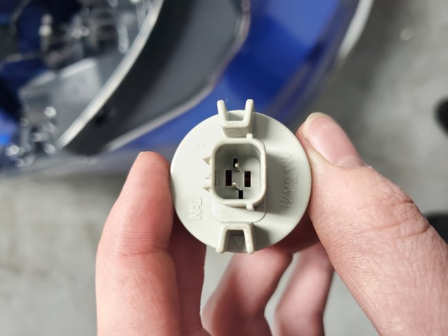

Hey there, sorry I am taking so long to respond, but I have taken the bulb out of my vehicle and it appears to be this size. I took two photos. Could you see if there is any LED turn signal bulbs I can use to replace these normal bulbs that I currently have?

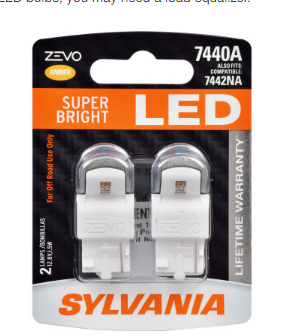

Hello again.

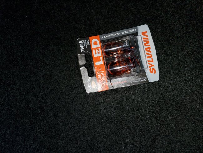

Okay, here is what I found out. Your bulb for the rear blinker is based off the part number 7440A. Sylvania does make an LED bulb available at any parts stores. I've attached the stock bulb and the LED bulb below. If you want to go off Ebay or Amazon like the pictures you included then you will have to base it of the bulb number 7440A as I stated. Hope this helps and thanks gain for using 2CarPros.

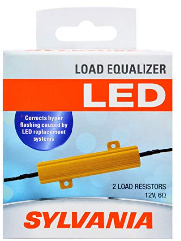

Hey there, so I installed these LED blinkers but they make my blinkers blink too fast? Do I need a resistor or something? I don't know what to do.

We are going to need to experiment a bit with the resistance to get the computer to blink at the correct rate. Lets try a 5 ohm first to see how must it changes. Please let us know what happens.

Hello again.
Just found out that your flasher is built into the BCM (body control module) So you shouldn't replace it that way. Sylvania makes a load equalizer to solve your problem. They are available at AutoZone, Napa, etc, as well as online. They run about $15.00. You can Google the name and it shows a YouTube video on how to install. I've attached a picture below. Hope this helps and thanks again for using 2CarPros.
