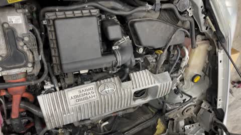

I have had my share of these car issues before and was able to fix them. I had one before that was knocking on startup and I replaced the EGR, EGR cooler, updated intake, fresh coolant, new plugs and coils and some fuel system cleaner in the tank. This one here has same knock, I started with the plugs, injectors and coils, still misfiring and it moves from sometimes being cylinders 1, 2 or 4, randomly. I put it in maintenance mode and let it run for hours with fuel system cleaner in tank, still doing it. It can idle fine and run smoothly for minutes then all of a sudden It starts to knock then goes back to normal. Oh, I also changed the PCV, cleaned the intake, cleaned the EGR cooler and EGR. Same results, decided to replace EGR, same results, got another set of injectors same result. Coolant pressure test showed normal with no issues. And no coolant loss.
Not sure if the intake was not cleaned enough or if a really dirty EGR cooler can cause this.

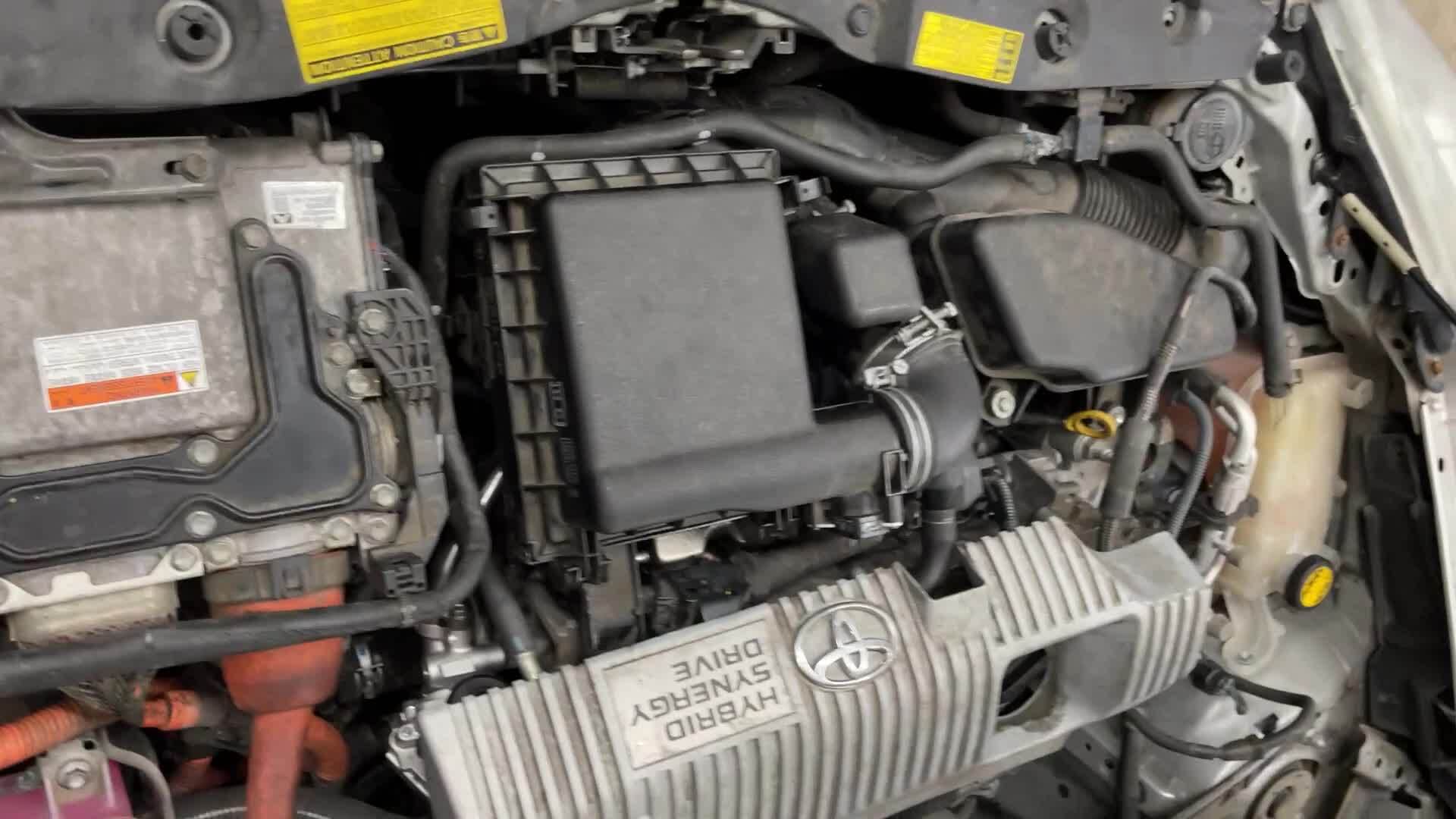

BHAMDOC1973
  • 2,018 POSTS
I will shoot a video, but I think if it was a broken spring noise will be there all day not when you first start then smooths out and comes back later.
Wednesday, June 28th, 2023 AT 12:44 PM
BHAMDOC1973
  • 2,018 POSTS
Attached.
Wednesday, June 28th, 2023 AT 2:05 PM
KEN L
  • MASTER CERTIFIED MECHANIC
  • 55,291 POSTS

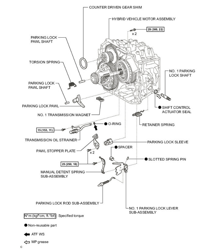

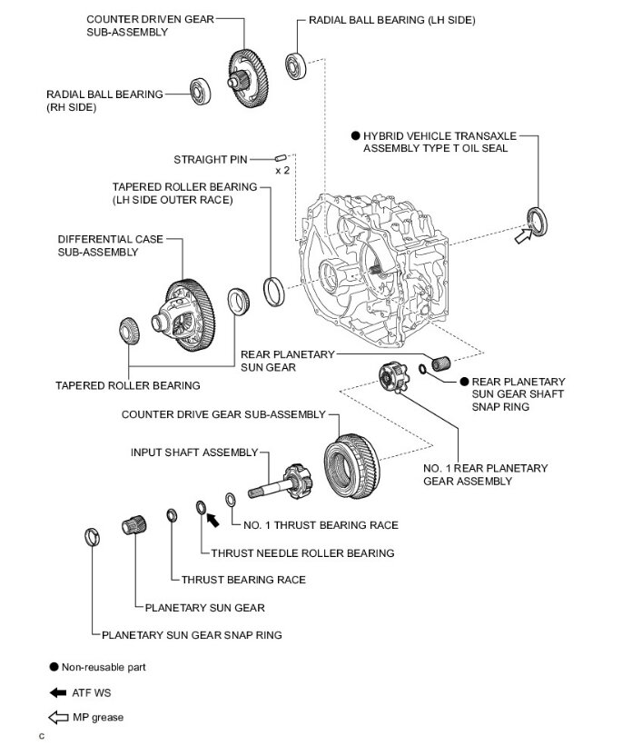

Thanks for the video, you are right the engine is okay and I don't is it misfiring, it sounds more like the Hybrid transmission front planetary or possibly the input shaft can you tell if the engine is coming from behind the engine and in the transmission area? Here is what I am talking about. The noise can cause the knock sensor to go off and cause the engine to become unbalanced which can cause the random misfire codes. Check out the images (below). Please let us know what happens.

You mean is the sound coming from around where transmission meets the engine?
Thursday, June 29th, 2023 AT 10:47 AM
BHAMDOC1973
  • 2,018 POSTS
Feels like it's coming from the back, but there is no vibration while I am driving, so what are the possibilities? How can I check on mounts on this vehicle like we did with regular cars by pressing gas and brake pedals since it's hybrid?
Thursday, June 29th, 2023 AT 11:14 AM
KEN L
  • 55,291 POSTS
Yep, that is one way, also you can try lifting the engine or transmission with a floor jack to see if there is excess movement. I don't think it is an engine mount, but you never know. Does the noise change when shifting from park to drive to reverse?

If the noise has just begun then it could be cold only at first and then wear further to be present at all times. I still think it could be the coupler between the engine and transmission. Can you get a video of the noise from under the car?

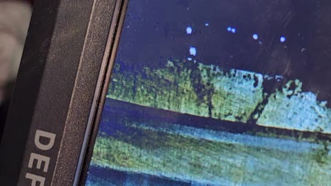

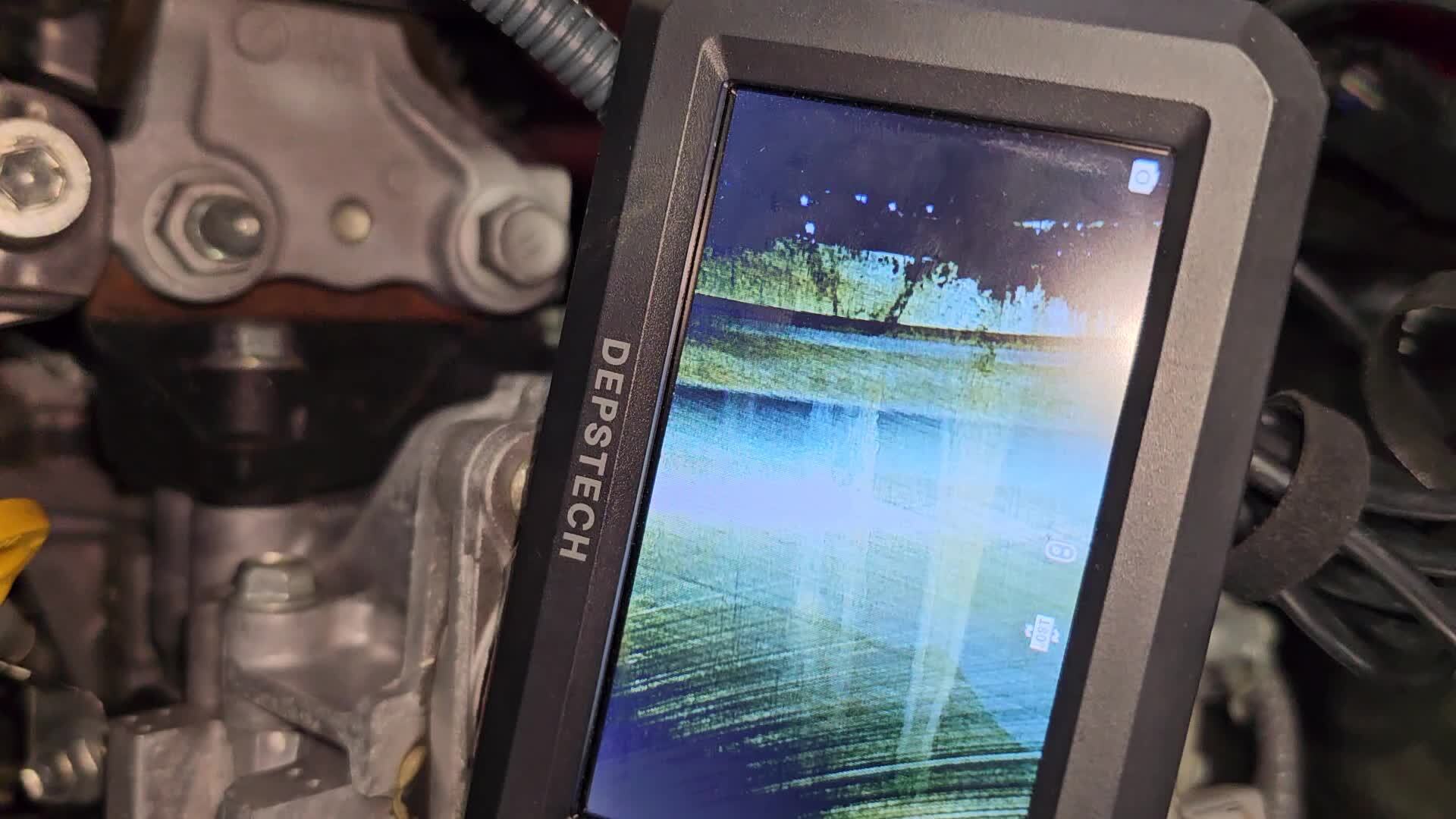

Hi, I see from your earlier post that you did a coolant pressure test. Do you have a bore scope to look inside the cylinder? Normally #2 cylinder will be the one leaking coolant. If you don't have one maybe an auto parts store can rent, you one.
Also, if you have an enhanced scanner go to Mode 6 data and look at your misfire monitor. If you have a high number in one cylinder swap over the coils, plugs, injectors like you have earlier. Reset the check engine and see if the misfire follows. Mode 6 is really good data for intermittent faults like the misfire you are getting intermittently.
I have provided a video on a head gasket leak I had on a CT200H. Same thing, random and coolant wasn't low. Maybe someone topped it off? I didn't even need to pressure test it. Just warmed up the engine. Hope this information helps you out and let us know what you find once you get the Mode 6 data.
Friday, July 7th, 2023 AT 11:54 PM
BHAMDOC1973
  • 2,018 POSTS
I have a good camera and I thought that was the issue, but there is nothing on the walls or cylinders and the pressure held all day as far as a leak down test. Also, I didn't have to top off water since I did all that and drove it 350 miles. Keeps giving me cylinder 1, then when I switched all gave me 2 then 1 and 2, its random not always same cylinder. Sometimes the misfire is there, sometimes not. The misfire count is around 15-20 on cylinder 1, and then maybe 2 on cylinder 2. Then after a couple of seconds all are zero. Oil looks good, coolant is where it should after all the driving, weird.
