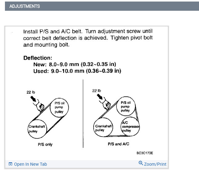

Loosen bolt in center of tensioner pully back off adjusting bolt position belt tighten adj. Bolt till belt deflecys 1/2 " tighten pully bolt

Yes there is a tensioner that will need to be released. Here is a guide that will let you know what you are in for when changing the belt.
Let me know how to goes, we are here to help.

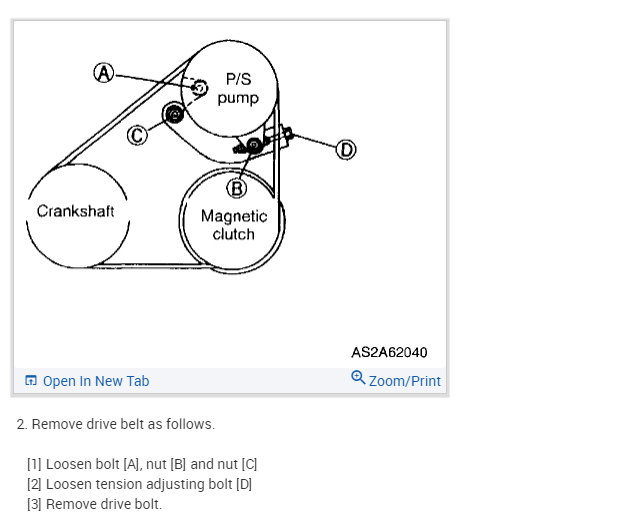

REMOVAL
Remove negative battery cable.
Open B terminal cover cap.
Remove B terminal nut.
Remove B terminal lead.
Disconnect generator L and S terminal connectors.
Loosen pivot bolt and tensioner mounting bolt. Do not remove.
Relieve tension on drive belt by rotating adjustment bolt.
Remove drive belt from generator pulley.
Remove tensioner mounting bolt and belt tensioner.
Remove generator pivot bolt.
Loosen bolt at base of adjusting bracket and rotate the bracket up.
Lift generator from engine compartment.

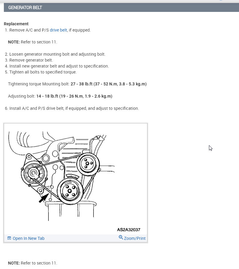

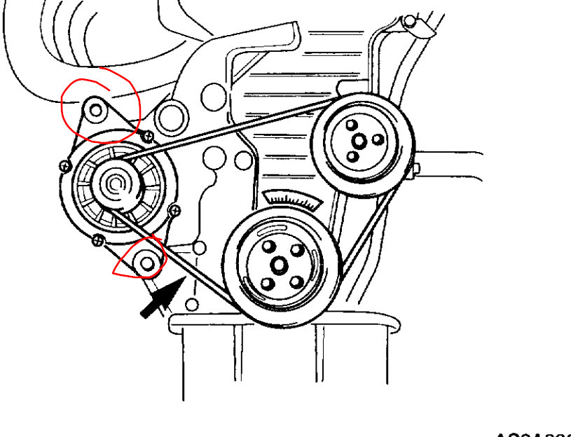

Take a look at this page. It shows the alt and adjuster. NOTE: You must first loosten the bolts on the bracket so it can move.
https://www.2carpros.com/car_repair_information/year/2003/make/kia/model/spectra/2003_kia_spectra_drive_belt_routing_diagram.htm

Loosen the alternator mounting bolts and then loosen the belt adjusting bolt.
Tuesday, July 21st, 2020 AT 2:06 PM (Merged)
JOSEPH GEE SR.
  • 6 POSTS
But I have already loosened all of that and I still cannot get the front belt to come off. So want do I do with it now?
