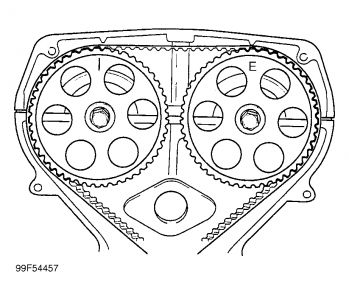

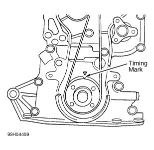

I need a diagram showing How to line up timing marks on the camshafts and the bottom pulley

Hi
See diagrams
If belt broke while engine running may have bent valves
Hope this helps
