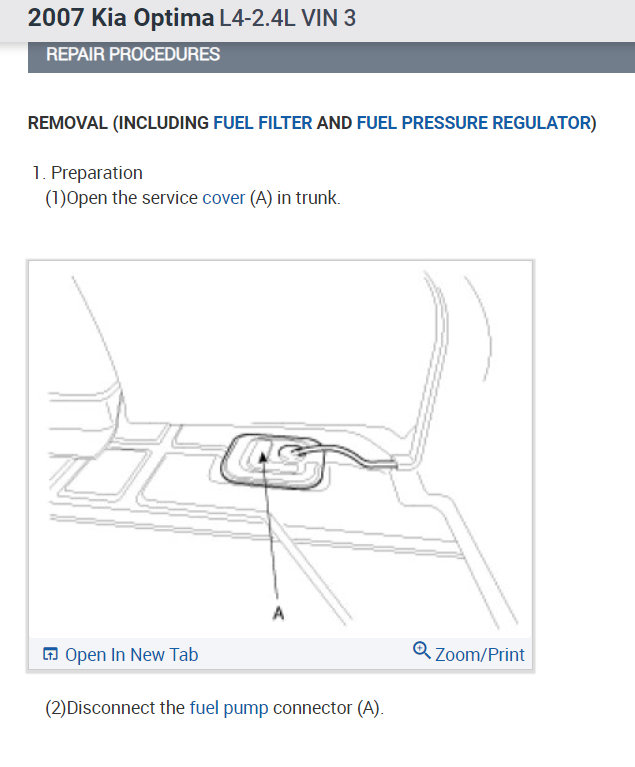

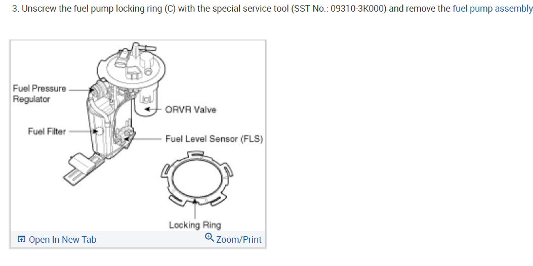

Where is the fuel filter located on he fuel pump where is it?

Here is a guide to help you step by step with instructions in the diagrams below to show you how on your car.
https://www.2carpros.com/articles/how-to-replace-an-electric-fuel-pump

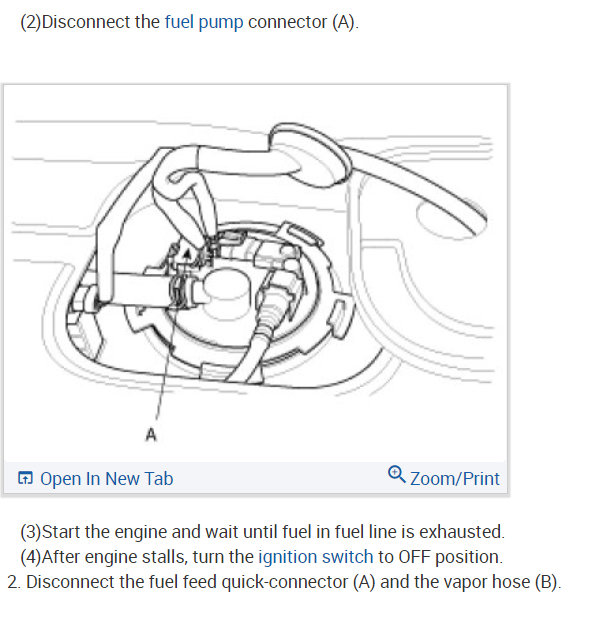

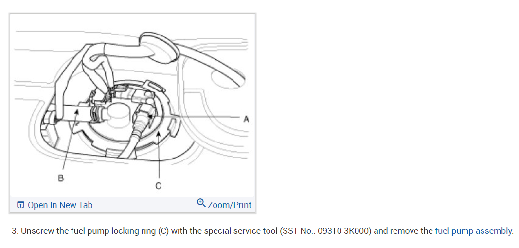

I am trying to replace the fuel pump. I have access to the top of the fuel tank and have removed the electrical connector and the two hoses, however I cannot figure how to remove the locking ring? It is completly smooth and only has eight holes around the top of the ring, can nayone help on this?
Friday, January 22nd, 2021 AT 1:48 PM (Merged)
MERLIN2021
  • 17,250 POSTS
You'll need the spanner wrench, or a brass punch and hammer to tap it off without destroying it.

Does it require a special tool to remove a fuel pump from a 2006 kia optima
Friday, January 22nd, 2021 AT 1:49 PM (Merged)
BLUELIGHTNIN6
  • 16,542 POSTS
No specialty tools required.
