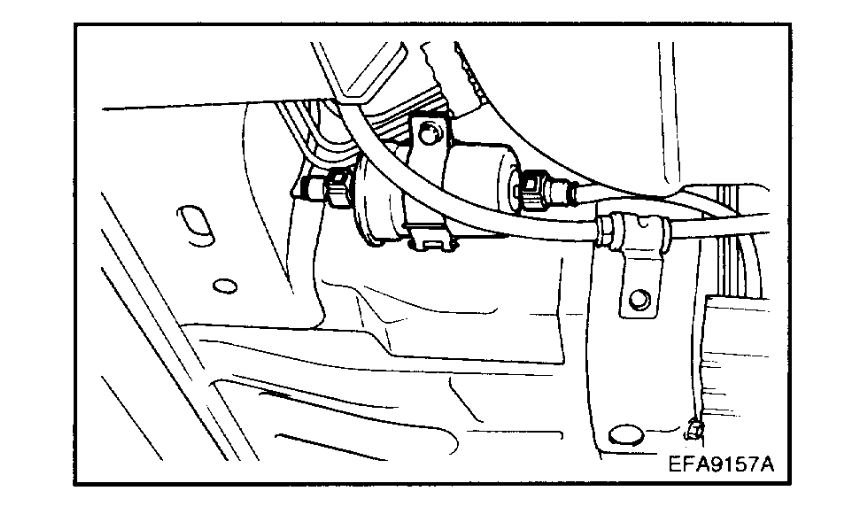

Good afternoon,
The fuel filter is located underneath the chassis on the left hand side of the fuel tank.
What is the issue?

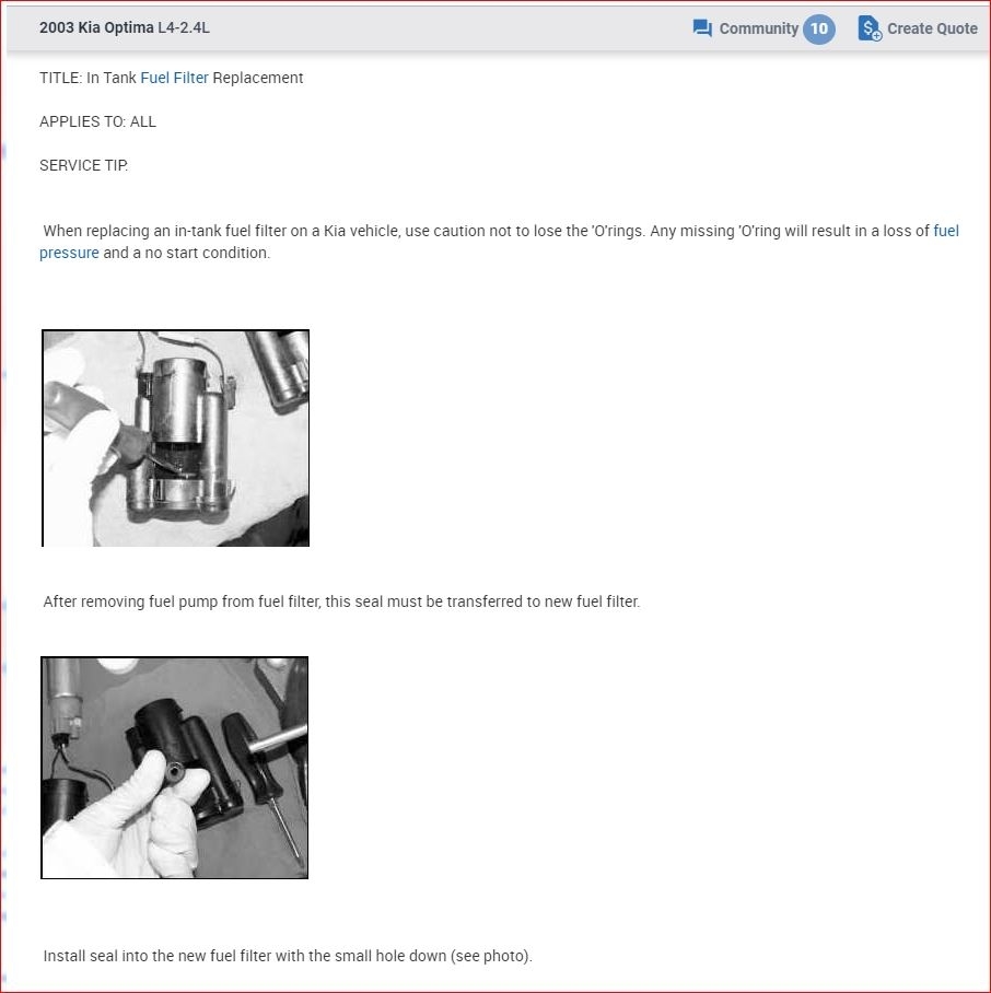

Hi John,
I attached the location of the filter from the manual. However, it appears there are some that do not have this external filter. If yours does not have the filter in this location, the second attachment shows the in tank filter. Unfortunately, this is inside the fuel tank but all in tank filters are serviced for life and do not require replacement unless the pump comes out for some other issue.
Let me know if you have any other questions about this. Thanks
Friday, January 22nd, 2021 AT 1:15 PM (Merged)

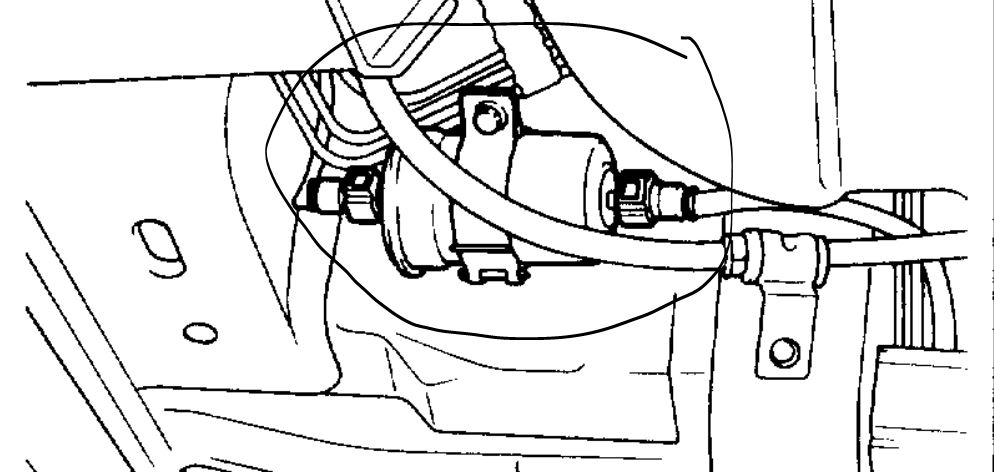

JENJOHN24
I have even called Kia and they said there was one, but we have looked everywhere.
Did you check the location listed?
If it is not there, then it is part of the fuel pump.

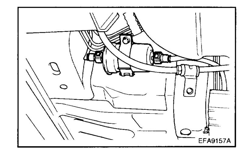

JENJOHN242003
  • 2003 KIA OPTIMA
  • 2.4L
  • 4 CYL
  • 200,000 MILES
Trying to locate my fuel filter.

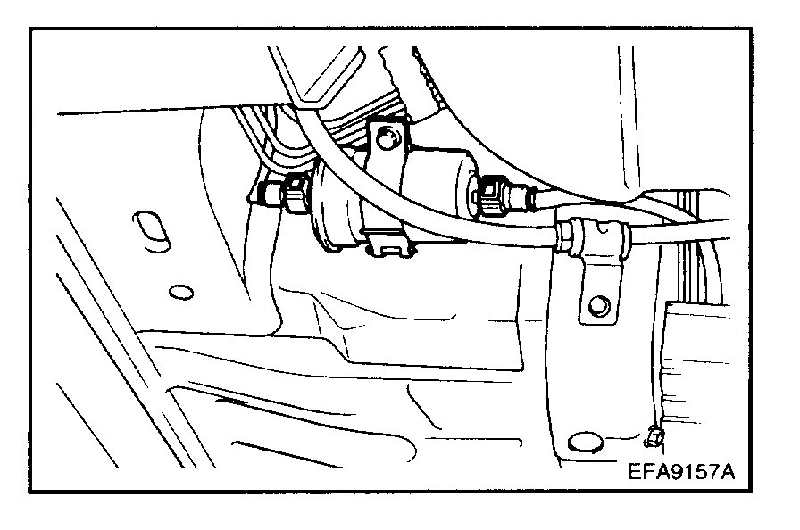

Hello, I'm Danny,
Here is a basic fuel filter replacement tutorial for you to view:
https://www.2carpros.com/articles/how-to-change-a-fuel-filter
I've attached a picture (below) of its location. It's under left side of vehicle, forward of fuel tank. Hope this helps and thanks for using 2CarPros.

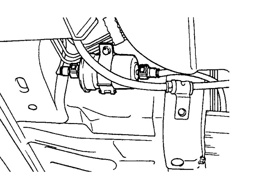

GINA VANSELOW
  • 2003 KIA OPTIMA
  • 0.5L
  • 4 CYL
  • 8,700,000 MILES
I need to change my fuel filter?
Good morning,
Here is a guide to help you step by step with instructions in the diagrams below to show you how on your car.
The fuel filter is located underneath the chassis on the left hand side of the fuel tank. Check out the diagrams (Below). Please let us know if you need anything else to get the problem fixed.

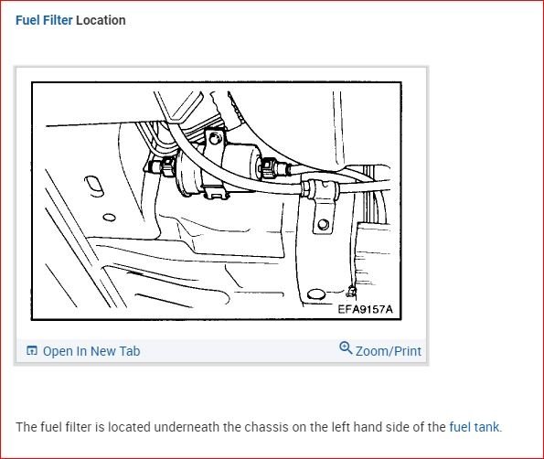

ARNOLDG576
  • 2003 KIA OPTIMA
  • 2.4L
  • 4 CYL
  • 121,300 MILES
I have been trying to find the location of the fuel filter, but cannot seem to find it. Although I looked thoroughly under the car.

Welcome to 2CarPros.
I believe it is the left side, under vehicle, near the rear wheel. Take a look at the attached picture.
Here are the directions specific to your vehicle:
2003 Kia Optima L4-2.4L
Procedures
Vehicle Powertrain Management Fuel Delivery and Air Induction Fuel Filter Service and
PROCEDURES
FUEL FILTER REPLACEMENT
1. Reduce the internal pressure of the fuel lines and hoses and perform the following operations.
- Disconnect the fuel pump harness connector in the trunk room.
- Start the engine and, after it stops, turn the ignition switch to OFF.
- Disconnect the battery negative (-) terminal.
- Connect the fuel pump harness connector.
2. Remove the two fitting nuts while holding the fuel filter nuts securely.
pic 2
3. Remove the fuel filter mounting bolts, and then remove the fuel filter from the fuel filter clamp.
Tightening torque
Fuel filter fitting nut : 25 - 35 Nm (250 - 350 kg.cm, 18 - 25 lb.ft)
____________________________________
Let me know if that helps or if you have other questions.
joe

It should be near fuel tank ( under the car) if it is an in-line filter which is what it is listed as. Although, earlier models of the Optima had the fuel filter in the tank with the pump and sender assembly, so I wouldn't be surprised if they have it listed wrong. May want to check there for the fuel filter. Try removing rear seat cushion or check in the trunk to see if you have an access panel. Should be able to see sender unit from there to locate filter if it is in the fuel tank.

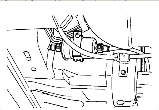

WAKKYTRIPLEA89
  • 2002 KIA OPTIMA
Shakes or Wobbles problem
2002 Kia Optima 4 cyl Front Wheel Drive Automatic
hello I tryed changin my fuel filter but I cant seem to find it some peole say is under the car or in the engine compartment or connected to the fuel pump ive looked everywhere but cant find it.
Friday, January 22nd, 2021 AT 1:16 PM (Merged)
  • 75,992 POSTS
https://www.2carpros.com/forum/automotive_pictures/12900_ff_8.gif
