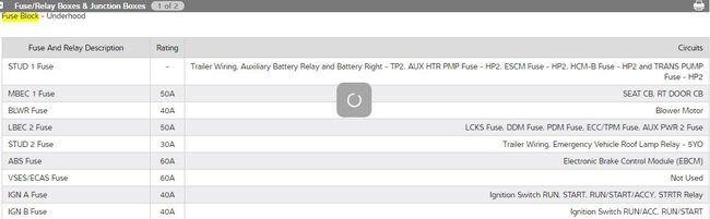

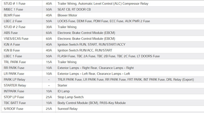

Turn key to accept, only A/C blower comes on, no radio or gauges and will not start.

The first thing I need you to check is the ignition fuse under the hood. It is in the power distribution box. I had a truck last week that did the same thing. Actually, we could not remove the key or take it out of park.

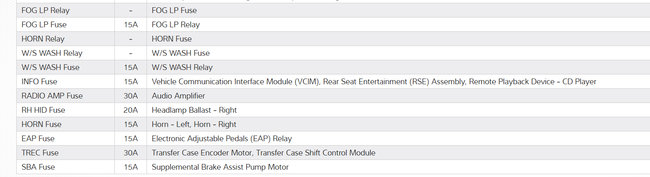

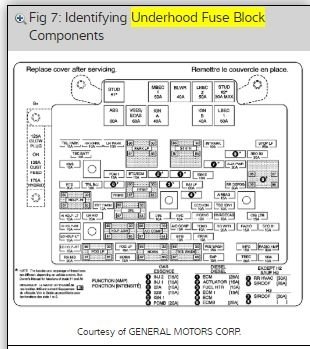

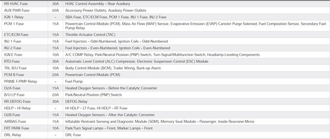

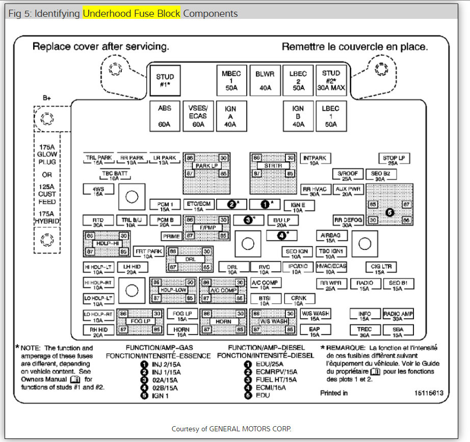

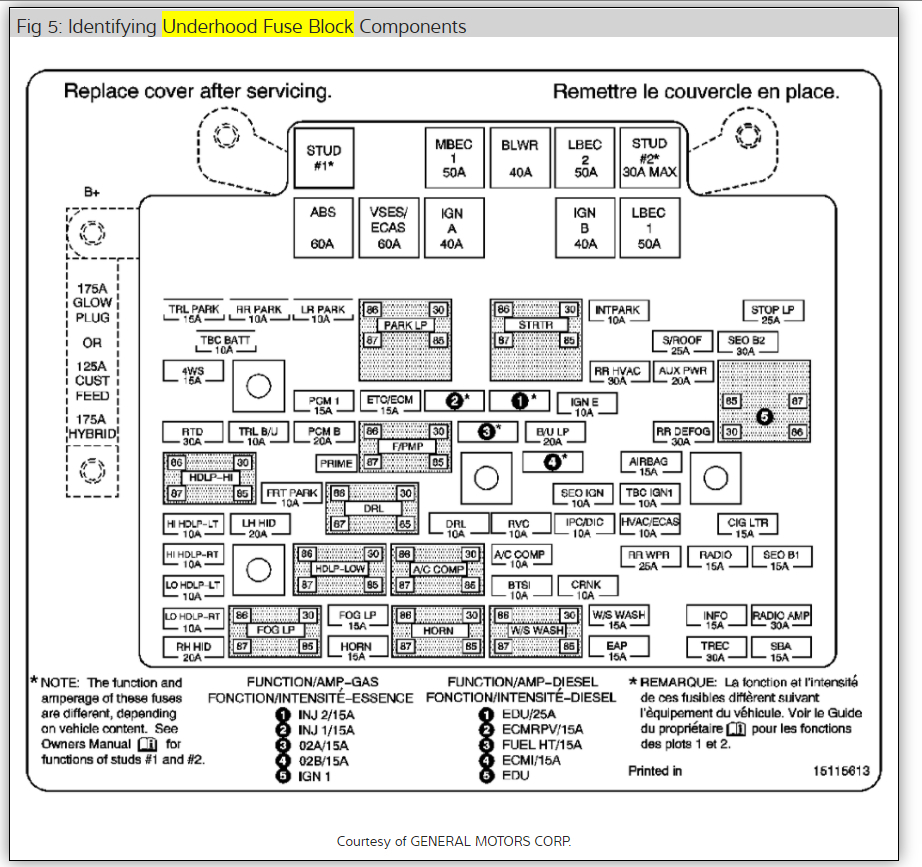

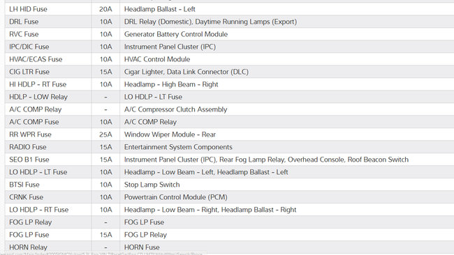

I have attached a picture of the fuse layout. Picture 2 is of the amperage fuse required. These are not the tiny fuses. Look for Ignition fuse A and B. Both are 40 amp fuses. See attached pictures.
Let me know if this helps.

Okay, I found the two fuse's, both are good. What is next? This may take a while due to my limited time available to work on my truck, I apologize in advance if I bother you.

Can you go to the fuse panel and with a test light see if most of the fuses have power with the key on? Here is a guide to help with the fuse panel locations:
It sounds like an ignition switch or a fusible link I will walk you through it.
Check out the diagrams (below). Please run this test and get back to us.
