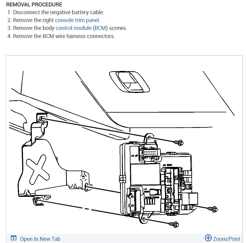

Could anybody please confirm me where is the location of the key receiver within the vehicle?

The Key receiver is the inside the BCM. Check out the images (below). Let us know if you need anything else.
