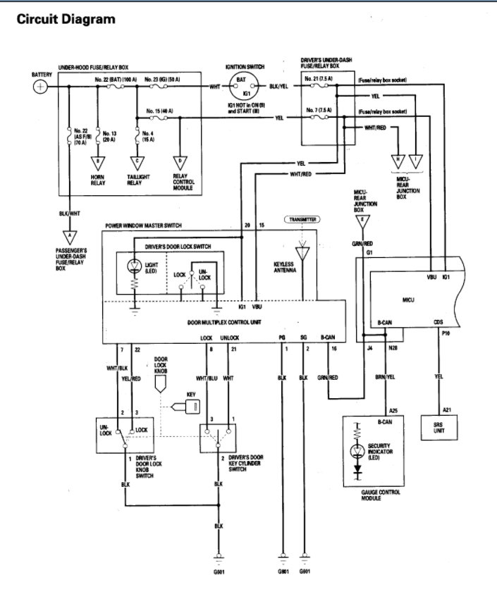

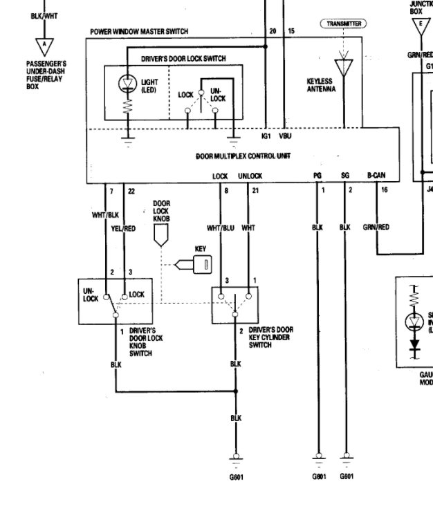

Hey guys. I do enjoy working with the Sgt. So, let's see if we can figure this out.
Sorry if I state the obvious but I just want to make sure we are on the same page. Correct me if I get something wrong.
Clearly this is the alarm getting activated because it is getting turned on so every time you open a door or hood it sets it off. So, I suspect if we deactivate it and then don't lock it again it will remain off.
This vehicle should have a metal ignition key and then a keyless entry transmitter, correct?
If that is the case, what happens when you close the doors and hood and use the metal key in the driver door lock and unlock it? Even if the doors are unlocked, the key lock sending a signal to the multiplex control unit should disable the alarm.
I am attaching the wiring diagram which shows that this should work.
If it doesn't then we may have to remove the door panel and jump the switch so that it thinks you are unlocking, it. However, I would think this should work.

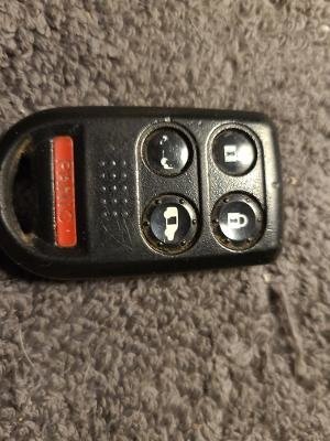

I can’t afford $135.00 for a key fob the van will have to wait for a few months. I have to fix my roof on the house.

I wish you lived nearby as well. As far as the key job is concerned, take a look below. Is that what the one you had looked like?

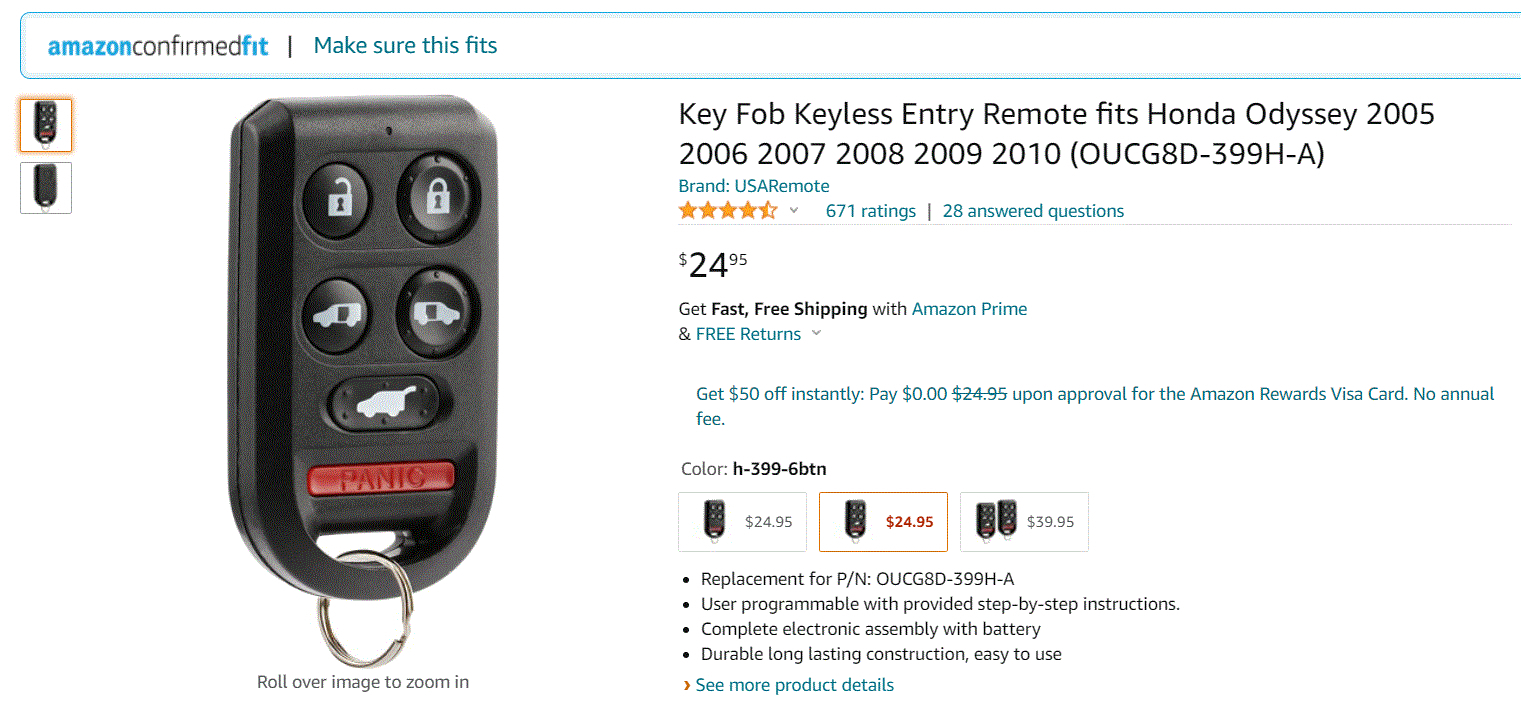

Good morning, Joe how are you today? The Honda Dealer wants $175.00 for the key fob and $65.00 to program the fob.
Saturday, April 2nd, 2022 AT 6:27 AM
  • 110,194 POSTS
They should be able to program the one sold on Amazon that I sent you. Ask and see if they will do it. Explain that you can't afford a factor key fob right now.
Let me know. If they will do it, I'll try to find one at an even lower price for you.

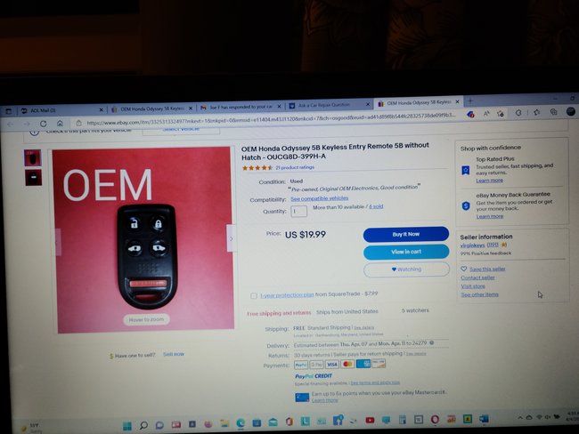

I found the Key Fob.
OEM Honda Odyssey 5B Keyless Entry Remote 5B without Hatch - OUCG8D-399H-A | eBay.

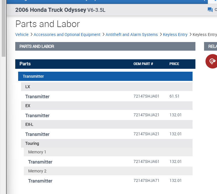

Hi Sgt,
That looks like it will work. I can't see on the webpage, but do they have a chart that shows what it fits? Maybe a cross reference chart?
I attached all the part numbers for the different 2006 Odyssey vans depending on what model it was.
If they list this as a compatible vehicle, then it would be worth a try for that price.

SFCTRIPLETT57
  • 184 POSTS
Hey, Kenny, according to Ebay it fits
