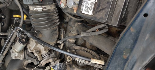

Can you please take more pictures and upload them so we can so where the hose is coming from and where it might go? We need to see more.

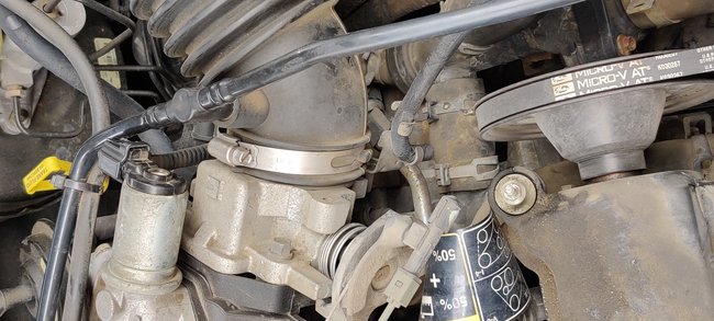

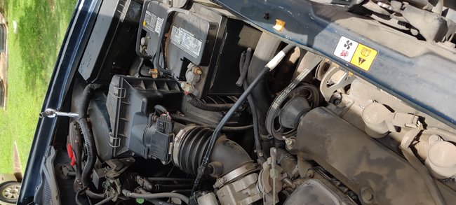

Is this better?

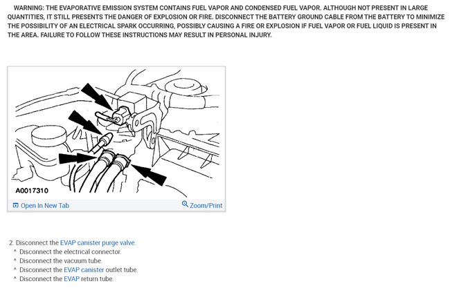

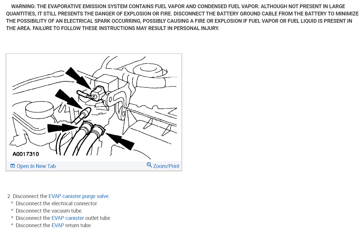

Okay, it looks like it goes to the EVAP purge solenoid. Diagrams below to replace the hose it looks bad. Check out the diagrams (below). Please let us know what happens.
