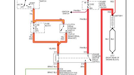

1999 Jeep Wrangler 4cyl 4wd. 106000 miles. Drove to the local gas station for a 6'er shut off my Jeep bought my goods got back in and it was dead just like that. Ran just fine before with the exception of it acting similar to starving for fuel at random times, speeds, & gears. The hole jeep would shake, extrem lose of power unless i left off the gas and only applied very little throttle.
So far I have confirmed that all the fuses, relays, & battery are fine through testing them and replacing battery. Still all I have is power to gauges, radio, lights etc. just nothing when i turn the key over.. No starter turning over just nothing. DEAD!!!
Jun 22, 2008 at 3:57 PM
  • CAR REPAIR CONTRIBUTOR
  • 75,992 POSTS

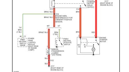

Check fuse no.2 40amp if okay disconnect clutch switch -jumper the clutch switch on top of the brake pedal and see what happens. See circuitry below

JEEPMAN77
I tried a few things also minor things in my skills level. checked fuses, relay's and bought a new battery since mine was to weak to pass a battery test. none of this helped so I got under it and played with the starter cleaning connections etc. nothing. I brought it to a shop and they had it fixed in 4 hours. They found a few bad wires some of which are in the diagram i do believe.
Bottom line it was bad wiring from the starter and the clutch safety switch both. This was a bit much for me to deal with so I paid the $180.00 and had it fixed by a pro.
I hope this helps you out.

Brought new starter still won't start. Bypassed the starter relay and it started right up. Do I need to replace the relay?

First feel if the relay is clicking when a helper turns the ignition switch to "crank". If it's not, it isn't the fault of the relay. It's the fault of the circuit that runs the relay, and the most common cause is the neutral safety switch. Try shifting between the gears a few times, then see if the system works.

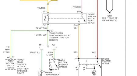

Swap the starter relay with an identical one from the fuse box (often a fuse box will have more than one identical relay). If the starter operates normally once the relay is switched, then the starter relay is bad.

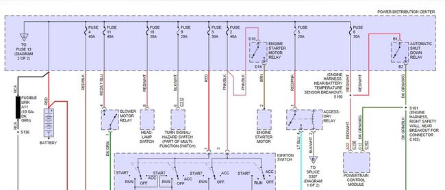

jeep won't turn over. I already replaced the ignition switch. No power to interior fuse box
Sep 26, 2020 at 12:33 PM (Merged)
JDL
  • 16,098 POSTS
Battery has a full charge, both battery cables, good? Did you track the positive battery connections to follow the voltage. I haven't looked at your wiring, yet? There is always the wiring--fusible links--whatever.

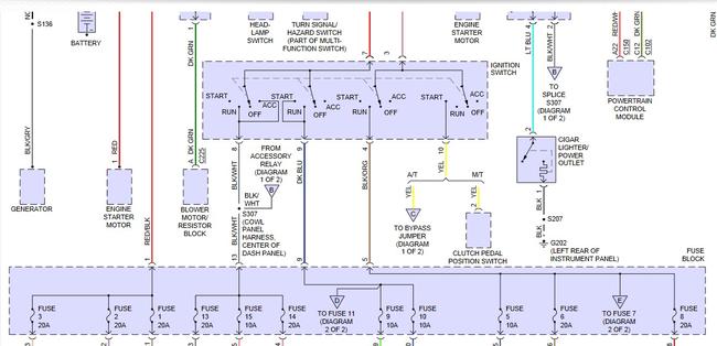

Just to add, you mentioned ignition switch, note the wiring. The wires going into ignition switch at the top are hot all the time. One wire is red, the other is pink with a black tracer, check for voltage.
The wires coming off the bottom of switch in the diagram go hot with the ignition switch in various positions, start--run--acc--whatever. Note the wire colors, check for voltage.

I disconnected plug from ignition switch, pink wire with black stripe is the only one that has power
JDL
  • 16,098 POSTS
The info I looked at was for jeep wrangler sport. for voltage on red wire, check fuse 3--30amp, underhood power distribution center. Not only check the fuse, check for voltage on the fuse circuit.

f3 fuse is good all power good in fuse box under hood all fuses good under hood where do I check next???

If the red wire at ignition switch, has no voltage. I'd replace the red wire from underhood fuse box for the proper fuse to ignition switch. Could be problem with wiring from underhood fuse box to ignition switch?
I'd have to check voltage on the red wire, hopefully we're talking about the same wire?
