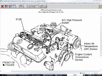

3 coolent temp sensors guy on here asked hook me up
Saturday, February 23rd, 2008 AT 5:48 AM
MERLIN2021
MECHANIC
17,250 POSTS
Need engine size and model of the jeep...v8 and other are tough to look up....
This covers 5.2 and 5.9 Near tstat housing...only one shown!
