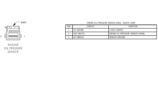

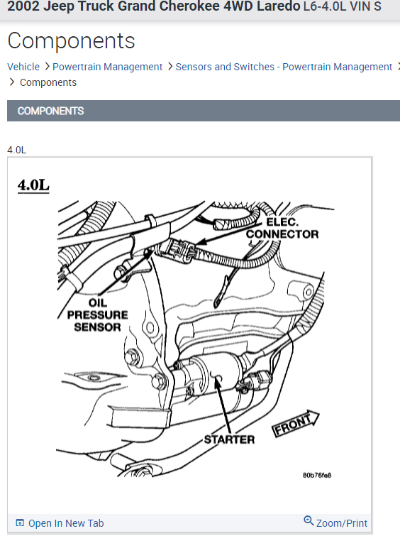

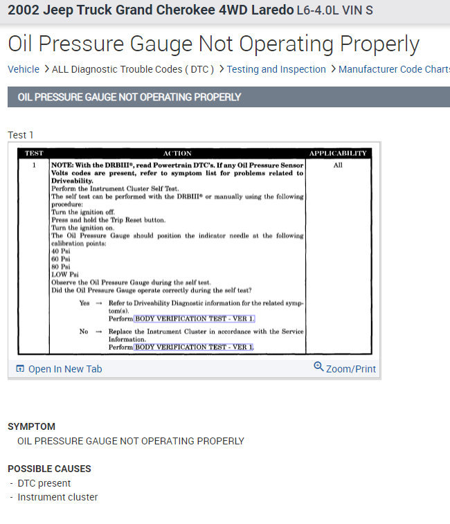

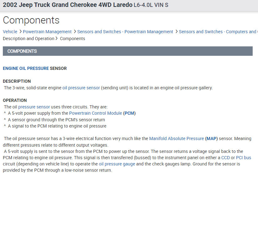

Oil pressure gauge is not working oil pressure sensor?
Tuesday, November 4th, 2008 AT 12:48 PM
SQM
  • 6,383 POSTS
If the vehicle runs as usual then it is likely just the sensor. It could also be a faulty wire to the sensor.
https://www.2carpros.com/articles/high-or-low-engine-oil-pressure
You might want to check to see if you are getting power to the sensor.
Another possibility is a faulty gauge.
I have attached the oil pressure sensor location diagram for your reference.
