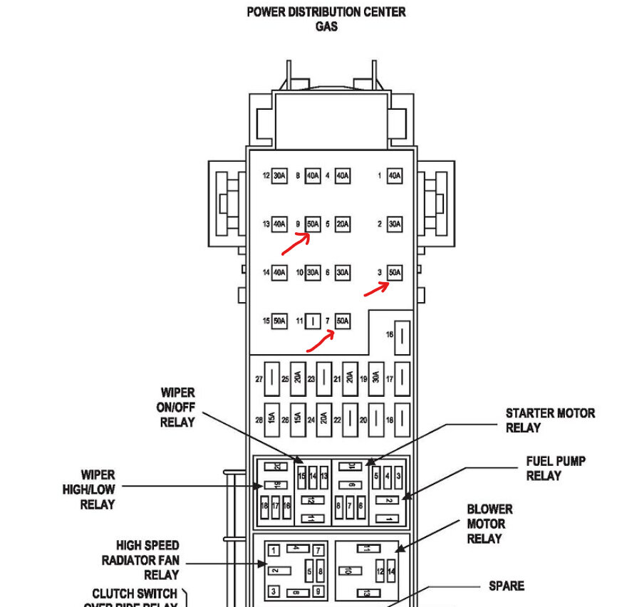

lol yep, So the engine cranks and does not start or the engine does not crank over, correct? With the key on can you check for power (both sides of the fuse) at fuses # 3, 7 and 8 at the main fuse panel under the hood.

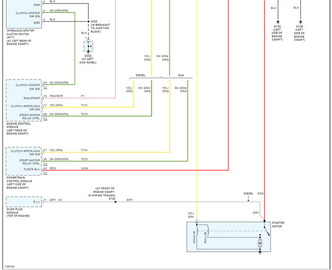

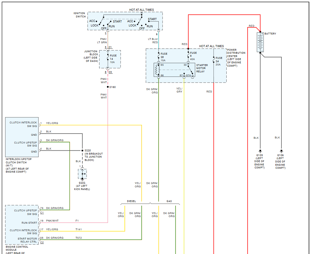

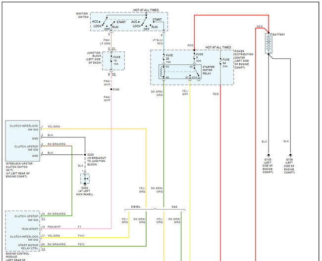

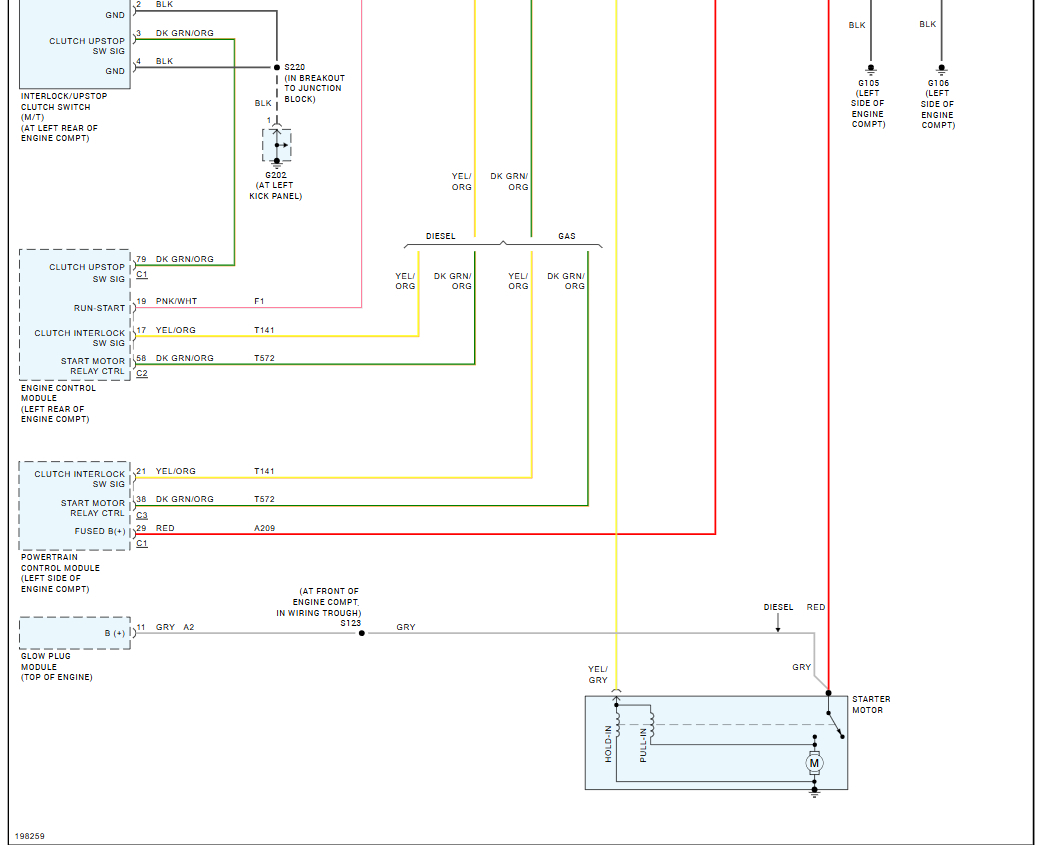

Okay so it doesn't crank over. Let's use a test light to see if you are getting power to the trigger wire of the starter when in the crank position. This guide can help and here are the starter system wiring diagrams so you can see how the system works.
