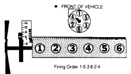

I have a 1992 Jeep Cherokee with 157,973 miles the engine was rebuilt. The distrubtor has been removed. Is there a way to make sure the distrubor is placed back in the right position? We can restart the jeep when we can rotate the disatrubtor but the design will not allow that as a perment fix. Any ideas, pictures or thughts are welcome.

Engine size please

4.0 high output

Hope this helps
https://www.2carpros.com/forum/automotive_pictures/59481_Noname_10.jpg
