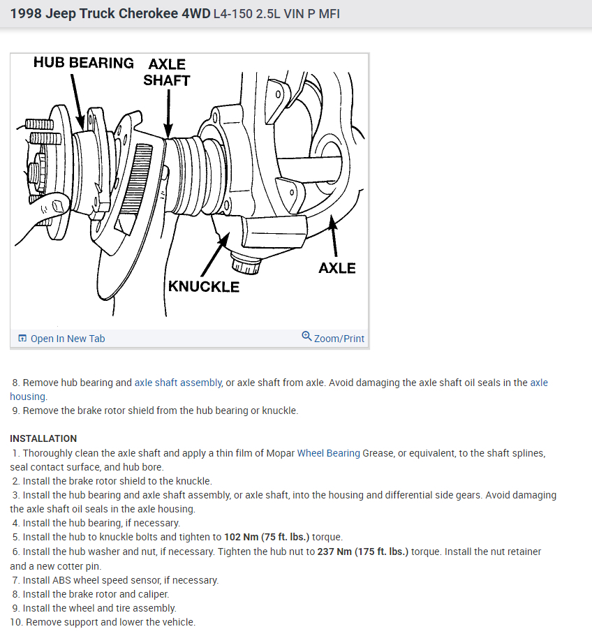

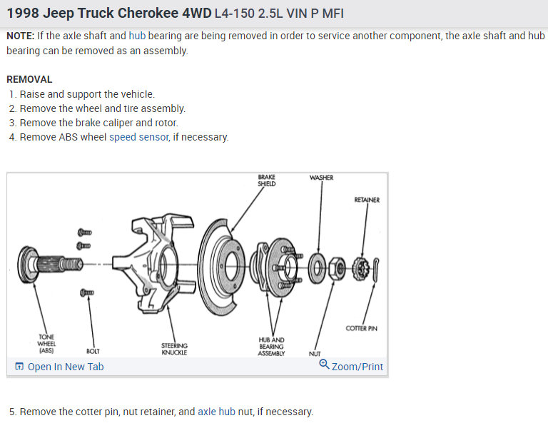

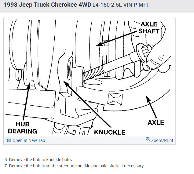

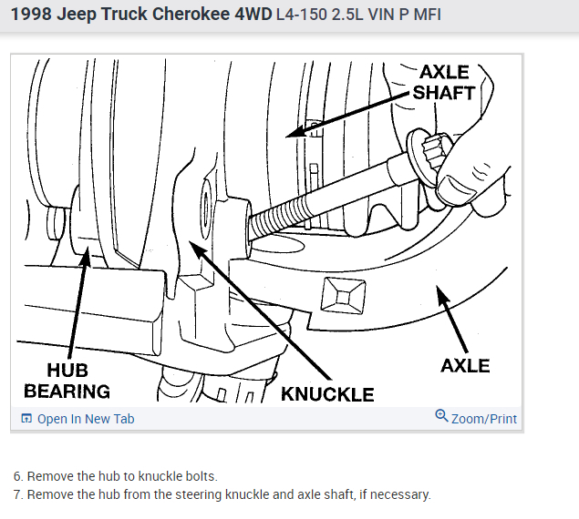

Typically you will get clicking sound from the CV axle when they are faulty. Usually the boot of the shaft will leak and you will get dirt and debris inside the boot. When that happens you will get clicking noise.
First check the boots on the shaft, if they are leaking you will see grease all over the suspension components. Also look for any lose or broken component.
Here is helpful article:
https://www.2carpros.com/articles/clicking-sound
https://www.2carpros.com/articles/replace-cv-axle
