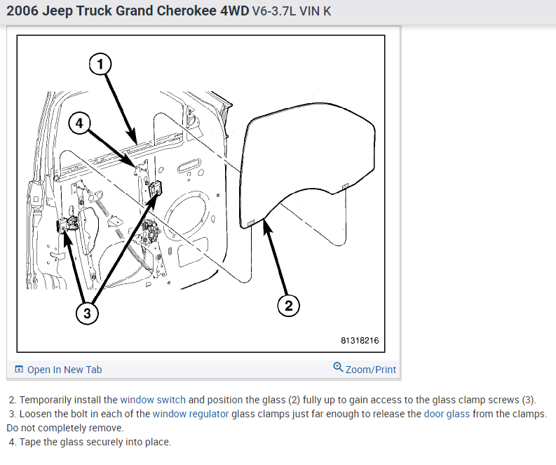

Hello, I have taken my 2006 jeep to a dealership because my battery was slowly being drain I had to have a new battery replace from the factory one which was less than a week and than my car wouldn't start once i got it started up again I took it to a dealership to have my alternator replaced now there saying my driver window won't work

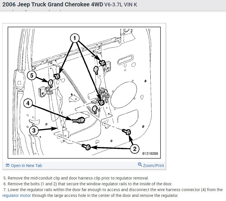

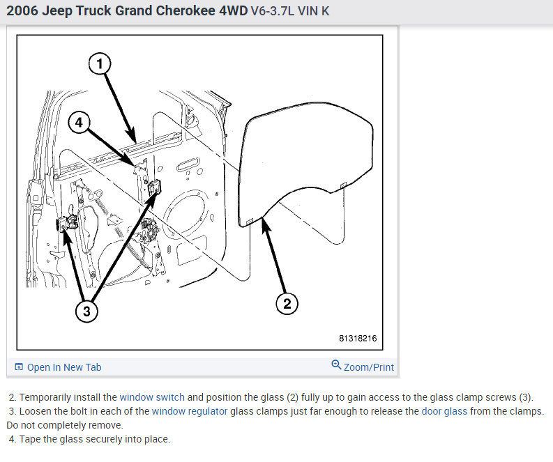

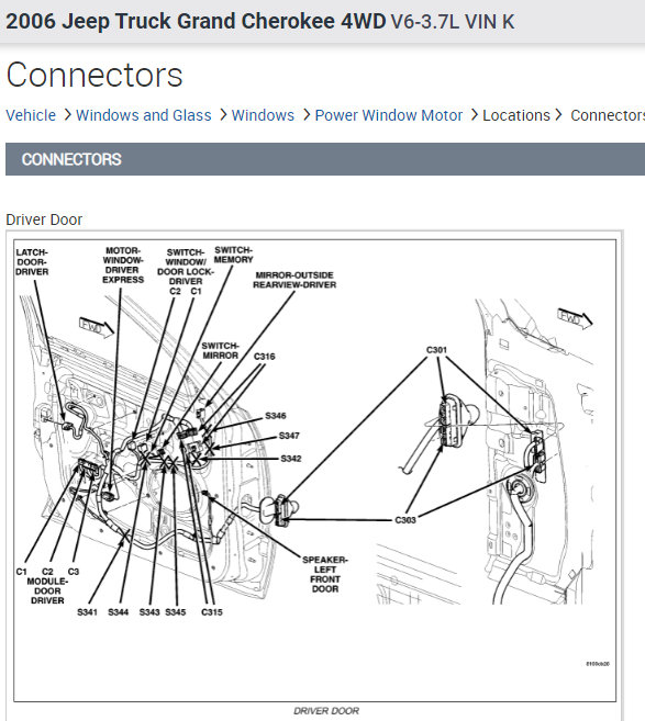

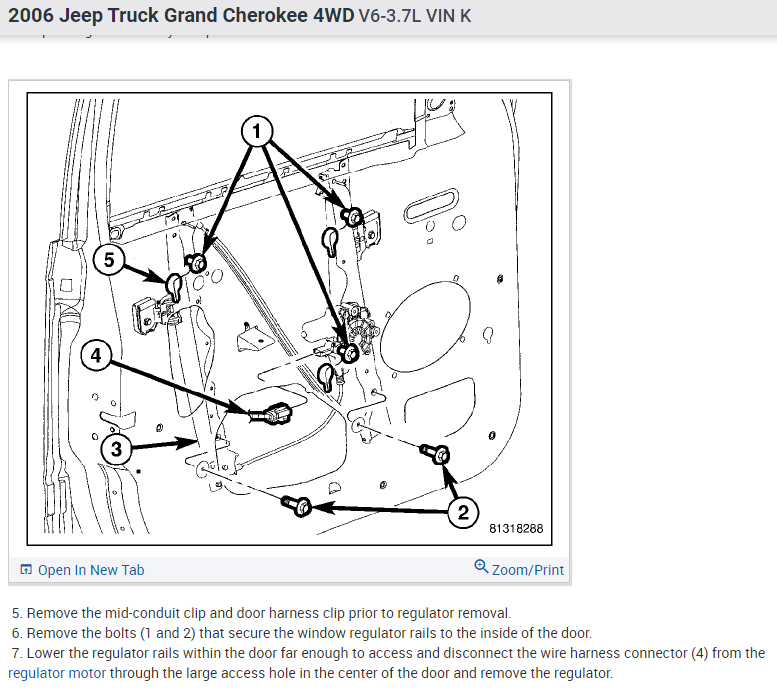

A window can be inoperative due to a bad window motor, relay/fuse or wiring and window switch.
It is always a good idea to check the fuse before replacing the motor. The fuse is located under the dash on the driver side.

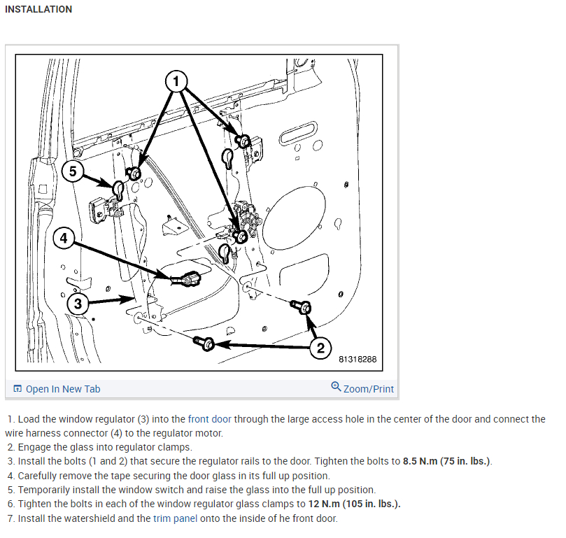

On this vehicle the window motor is part of the regulator. The window regulator is the part that raises and lower the window glass.

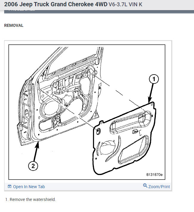

In order to replace that part you will have to remove the inner door panel. Which can be done using simple hand tools. The panel is mounted with few screws and plastic fasteners.
You might find this article helpful:
